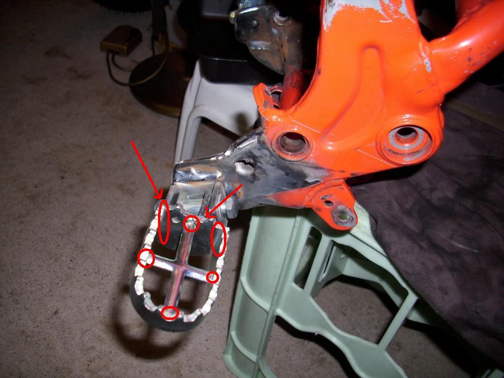

Rollox, those footrests are quite weak and can break. If they do you could have a nasty crash. I have broken 2 or 3 of them. They can break if you hit them on rocks or roots and one broke under my weight when I hit a rock step hard.
I still use them but I now strengthen them with weld at the points shown on the photo. At each end of the 'cross', top and underneath, vertically down the inside and finally where the footrest section attaches to the pivot as they can break off quite easily there. I can't mark that place with a circle as it is hidden from view but I have marked it with arrows. You can't put too much weld here as it will foul the bracket when the footrest pivots, stopping it from doing so.
Once welded I haven't had one break, but if you don't you may have a crash if one breaks. I was at the top of a rock step when mine broke and it was a long way down backwards with a KT250...

Hello Woody,
Many thanks for the important tip. I will ask my welder to strengthen the footrests accordingly.
We drive these footrests in several bikes and had, fortunately, up to now no problems.
