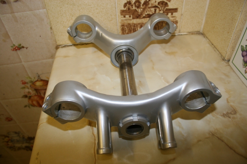

November 1, 201114 yr Author The problem is: I don't know what the word "yokes" means. Why do I prefer the Betor? A great feeling of softness. Just what I'm waiting for dampers. You can always set up the handlebar position with some trick. Nicolas These are Bultaco "Yokes" Edited November 1, 201114 yr by B40RT
November 1, 201114 yr Aahh .. Yokes are triple clamps, this explaines much for me. Yes these clamps can have a big effect to the steering as on trials bikes the distance between lower fork clamp (yoke) and upper fork clamp (yoke) are mostly differnt to the steering head axis. The upper clamp is a little bit further away to the center of the steering had then the lower one. This will result in a steeper fork angle and improve the understeer. This is a little bit visible in the parts book of the Montesa 200. To the forks itself, I had two Italjet Piuma's back in the eighties, the first bike had Betor forks which worked very well, (coming from Bultaco). The second bike came with Marzocchi's mounted, there where no big differences as I remember only that it took much longer until they where breaked in, (The fork had a some stop - loss or breakaway torque when new).
