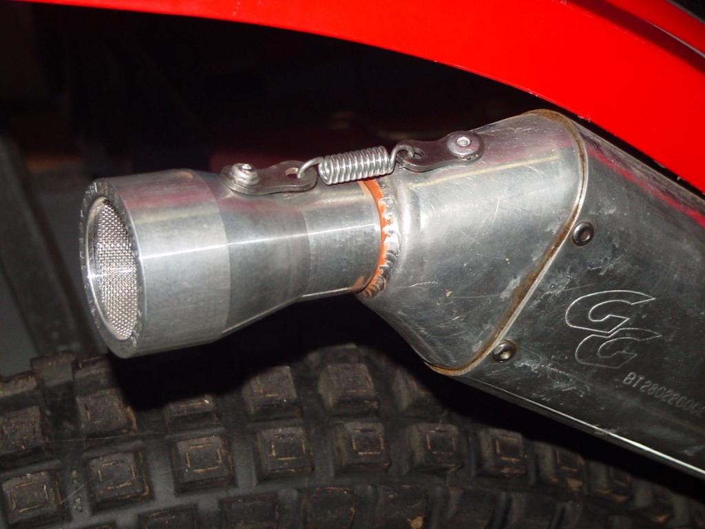

Sounds good. I need to call Adrian anyway and order a spark arrestor and extended tip to mount it as the entire state is in a burn ban. We still haven't had any rain in months and everything is brittle dry. I've got limbs breaking off trees about every day now it seems.
If you do any hillclimbing or high-altitude extended fairly hard riding, I would avoid the small clip on spark arrestors that have the outlet hole smaller than the ID of the muffler spigot. It's my experience that they tend to restrict the exhaust under severe loading and cause overheating. At the Ute Cup last year (8K-13K altitude) just about all, except one, of the plastic end cap mufflers used on the new Pros lost the end spigot due to the plastic melting at the end of the plastic cap. All ran the small add-on SA with the smaller ID outlet. I would imagine they are fine for a "normal" riding scenario, but under more severe conditions they are too restrictive.
Jon
Good tip. I really only need it for this dry season but I'll keep and eye on it.
Is there a more open/better arrestor for a late model gasser than the SF?
I see Adrian is selling an aluminum end piece to replace the plastic one.
Bill,
If you are just messing around the property or riding a local Trial the SF should work
fine. I run a large body SA I got from RYP and made a vibration-proof mounting
system. It looks clunky but is essentially non-restrictive and works a treat up at the
ultra high altitudes we run at the Ute Cup.
Jon
Its good to hear that my overflow bottle idea gave you the same feeling of relief that it did when I used it on mine.
ON the subject of spark arrestors, I found a "Sparky" add-on unit that was for some other bike but was able to do a little hammer and dolly work and it now fits over the entire end of my silencer. I drilled out the rivets on the end cap and replaced them with some threaded inserts that allow me to remove the spark arrestor and / or end cap and reinstall with 4 screws. There is no restriction at all but is US Frest Service approved which is required any time I ride on public land. Sorry I don;t have a picture and I can't easily take one because I am in China and the bike is in USA.
Appreciate the info guys. I had ordered a spanish fly from Adrien on Friday so it's already on it's way but I do like the thought of finding a real USFS approved arrestor as the local forest regulations do require them. I've been riding on public lands for decades however and not once has a ranger ever stopped me to check out my bike except for saying something like "Dang, that sure is a purdy bike" or some such. For now, I'll be riding on private property so the SF should work OK for this dry weather.
