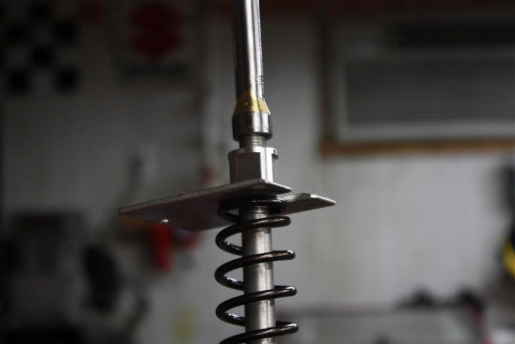

Here's a simple tool to help with the top cap removal/re-installation. Each leg takes 300cc's of 5-weight fork oil.
Jon
ps. Almost forgot. That top cap only is tightened to barely snug. It's held tight by the upper tripleclamp and the oil seal is by the o-ring, not how tight you torque it down.
Edited by jse
Thanks for the tips, I think I'll make one of them tools.
