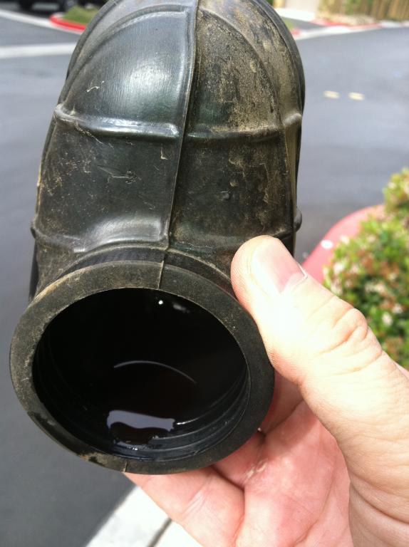

i wouldnt worry...if your over full a tad..youll find the extra in the bottom of your air box first time you run it down a trail.
iv been using motorex..pricey. but worth it.
Suzuki DRZ oil filters are the same as Betas. i switched to cleanable type..30.00 but worth it.
Too right Chuck. Or puddeling in the rubber boot that goes from the air box to carb.
Had that in my airbox....
been there already...lol... and learned. scared the crap out of me..it was the first break in oil change..on my 2013..
