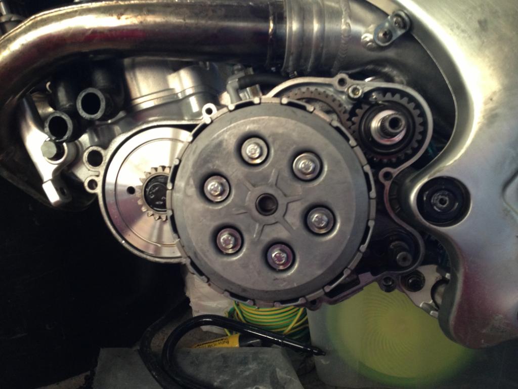

I sussed the skid plate had to be taken out to get the inner clutch cover off which was quite easy, so while I'm in here I thought I may as well look at the clutch and all looks well on the face of it, to a layman it looks new. There seems to be some loose glue-deposits between friction plates but nothing like I have seen that needs filling off like on Dan's clutch fix sticky thread and no notches-grooves.
2 things I cant seem to find out is what thickness of friction material is on tab when new and what thickness does it need changing at and how are they checked for being flat a piece of glass? and what measuring tool(s) are used, feeler gauges?

Clutches seem to last pretty good on these things, I thought I had a copy of the manual around but you can just view it on the beta site
Measure plate thickness but make sure you measure the free length of the springs, they can lose preload just from sitting the last 6 years partially compressed
While you have the clutch apart scrape the glue from between the plates, you can use a small file or an Exacto knife to remove it
Nope still cant find any info on clutch tolerance's has anyone got a link? or a idiots guide :dunce:
