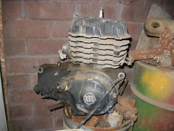

As far as 4 strokes running a higher engine temp goes, I'm still not really convinced they do, lets face it if it isn't boiling it isn't overheating. XL250 Honda's of the 70's and 80's could run for ever only using minimal cooling fins on bulky and heavy engines. The 2 strokes of the same era used big fins to keep them cool (see photo 1983 360 H7 Montesa). Which engine did run hotter???? Or does the 4 stroke have a greater capacity to operate better at high temprature? If that is the case then the 4 stroke motor could be the best on a hot day????

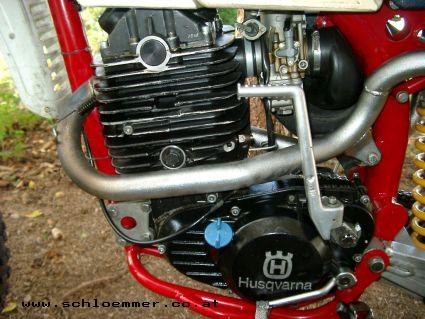

There seems to be a misconcepthion that the early Husqvarna fourstrokes used the belt drive Rotax engine & Rotax had a similar oiling system to the Sherco.
The early Husky engine was based on a 2stroke bottom end and was not the same motor that Rotax have been selling for the last 20 years. this started off as air colled and then went to watercooled after a 1 or 2 of seasons.
see picture below for Husky engine.
They were only problematic IF they were not maintained properly.

What you have pointed out about the difference in the finning design of 1970s two and four strokes is interesting but I'm not sure that it means that the two stroke has more problems keeping cool on a hot day (which we certainly get plenty of here down under).
The main reason that 1970s Honda XL250 engines have less finning than air cooled two strokes of the same era is that it is all to do with surface area available for heat transfer. Because of the location of the cam, rocker gear and cam chain case inside the 1970s XL250 Honda engine, the external surface area of the engine available for heat transfer ends up almost large enough even without fins - hence stubby finning. In the case of a two stroke motor, the surface area of the head and cylinder without fins would be way too small. Hence a two stroke of the same power output as the XL250 would need more fin area.
In reality the comparison between these two particular engines is problematic because the H6360 Monty motor would probably be able to produce about twice the power of a standard XL250 so there is a need for additional finning by comparison for that cause as well (waste heat produced increases with increased power output).
Remember that the sizing of the cooling surface area is not only designed to prevent overheating, but also to prevent the engine getting too COLD in service.
