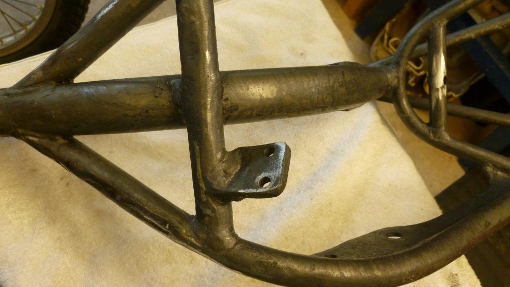

post-10669-0-90042100-1390625024_thumb.jpgHi- If this helps- my bike is Model 10-#117 and I have the frame stripped down starting a clean up. I just bought it so do not know if this is a proper lug but appears to be. bult360-I too would be very interested in seeing what an original side stand looks like if possible-Thanks

Thanks that shows the lug exactly as was on my M10 that I sold a few years ago.

Looking at the frame pictured above it appears to be brazed rather than welded like the later models, is this so?
the model 10 no 1000516 that i sold to some one in france in 2009 had that bracket, guessed that was what it was for but never seen one............
My model 10 over here in the States has that same bracket. Makes sense that's where a stand could or should go. I have never seen a picture of a m10 with a side stand fitted?
