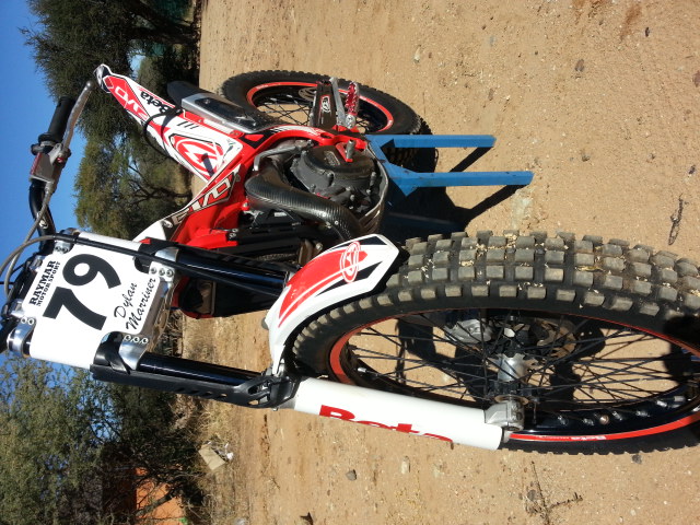

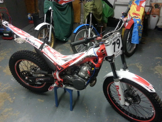

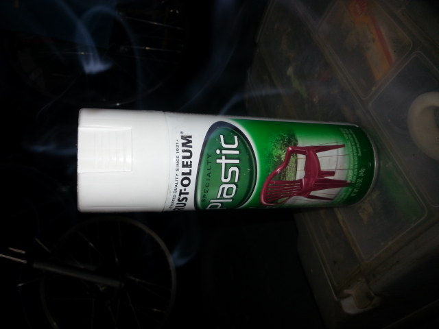

I decided to add a bit more white to my 13 EVo. Found a cool plastic spray by rustoleum. Available in a bunch of colours.
Peeled stickers off. Wiped plastics with thinners and sprayed. Used a STRONG double sided tape to reapply the stickers.
Seems pretty durable. Chuffed so far.
No. If you rub it down, it leaves a rubbish texture. I just cleaned with thinners. I gave two very lite coats and then a good solid covering coat, almost to "runs" point. All three coats within 1 hour of starting. Gave it a full 24 hours to dry.
This particular spray doesnt require a primer either. I only did the tank guard and front mud guard. Both are/were black plastic.
Thanks Wobblenorbed.
My theory is white looks lite and super clean if its kept clean.....as I do.....im a bit anal with bike prep. If it looks liter, I think its liter and so on.
Notice how most of the recent factory betas are lite in colour.....think they have the same theory, or me as them. Anyway....I like it!

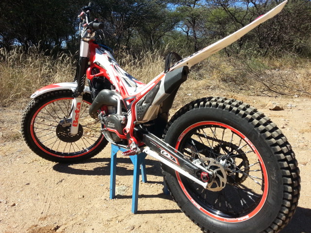

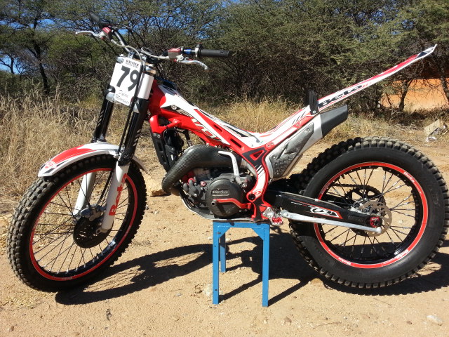

Just finished a major service and clean. Some better pics.
