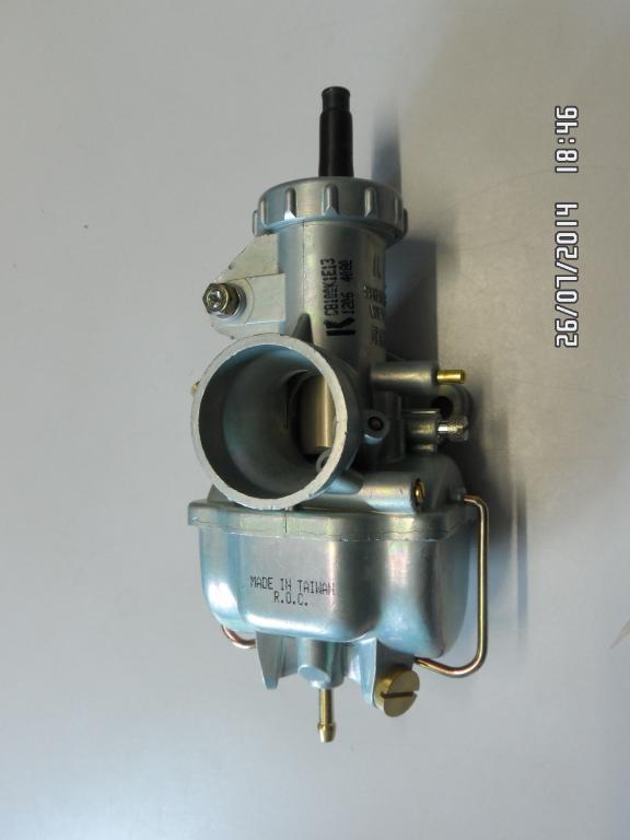

My Sheng wey (22mm) carb is jetted with 98 and 40 jets.
The throttle cable is the original one.
It is not a specific model, just look on Ebay fore TRL200 carburator.
post-14456-0-49415600-1406393581_thumb.jpg post-14456-0-58630400-1406393589_thumb.jpg
