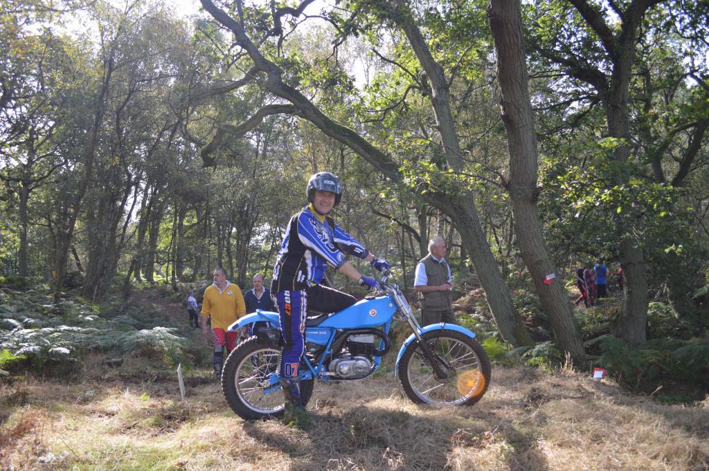

post-18219-0-24563000-1412322322_thumb.jpgHi All,
I said that I'd report back once I'd ridden the bike properly. This is with the Inmotion kit, without lights.
Well, first thing is I'm surprised that it still kicks back a fair bit. Not a bother, but it's obviously timed very near TDC at low revs. She's a little slow to find revs right at the bottom end - but this is down to me trying to keep an original Bing carb, rather than fitting the brand new Mikuni that I have in the box.
None the less, the bike is running brilliantly, even at the top of long climbs in tight sections around trees in second where the revs dropped very low, she keeps pulling. And opened up on those climbs it has amazing power, running very clean indeed with lovely pick up.
All in all, I have to say that I'm delighted with my investment. Highly recommended.
Now to fit that carb....

That's due to the ignition, it makes them a bit lazier off pilot.
Mike, when you replace the Bing and get it jetted spot on you should see an improvement in performance
and usually greater fuel economy in my experience.
Really a nice looking A model.

MIKE, The polished cases really set the bike off.
