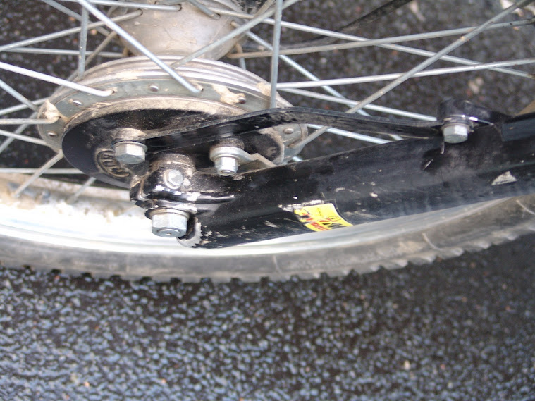

pschrauber Report post Posted December 2, 2014 You are not the only one that had this issue, this happened to mine too while riding in the mountains: I replaced the steel arm against the aluminium unit from the 81 model, (btw. even the front forks, (but left the yokes, just if you wonder ...): Much stiffer then this bendy steel plate ... Quote Share this post Link to post Share on other sites

reginald Report post Posted September 1, 2016 My 82 has the brake arm out to the front and I don't believe it works as well as this design with the arm at 90 degrees to diameter across the cam and pivot as in the one pictured above. Anybody tried this mod on a latter model and did it help? Cheers Mark Quote Share this post Link to post Share on other sites
b40rt Report post Posted September 3, 2016 My 82 has the brake arm out to the front and I don't believe it works as well as this design with the arm at 90 degrees to diameter across the cam and pivot as in the one pictured above. Anybody tried this mod on a latter model and did it help? Cheers Mark Hi Mark, has the arm also been cut and angled lower, so it's at right angles to the cable ? Quote Share this post Link to post Share on other sites
reginald Report post Posted September 7, 2016 No Mate, and on closer inspection found that the repaired one was even further away from the 90 degrees - that at least solved almost no brakes on the 125 but I still wonder if the 1980 design is better. Quote Share this post Link to post Share on other sites
reginald Report post Posted September 21, 2016 Hi Mark, has the arm also been cut and angled lower, so it's at right angles to the cable ? Does that mean you need a different front brake cable ie longer? Quote Share this post Link to post Share on other sites
b40rt Report post Posted September 21, 2016 Fraid so, might get away with shortening the outer. 1 Quote Share this post Link to post Share on other sites
reginald Report post Posted October 11, 2016 we shortened the outer and rewelded the arm to be closer to 90 feels better already. 1 Quote Share this post Link to post Share on other sites
