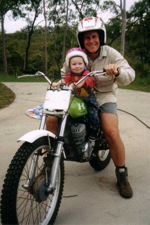

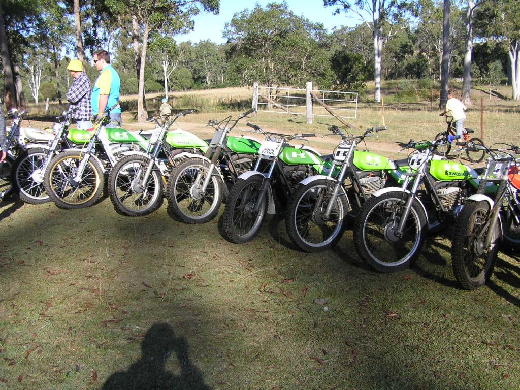

I'm one of the KT folk. I have one of my own, and have helped a few people with theirs. I've ridden mine quite a bit over the past 15 years and experimented with lots of things to see what effect they had.

Cool Pics!!
Starting the youngster early I see.
