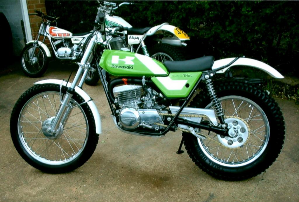

I am really excited to see your restoration! I am also starting to work on my KT250, which has been in my family its entire existence. My great-uncle bought it new in 74 and my grandfather bought it from him for me around 1999 or so. I've not ridden it or had it running since about 2004, but I'm hoping to clean the carb and gas tank and replace the fluids in it to get it going again very soon and also do some more work on it before spring (rebuild the forks, maybe rebuild the top end or at least take a look at the rings, etc.).
Here's a pic:

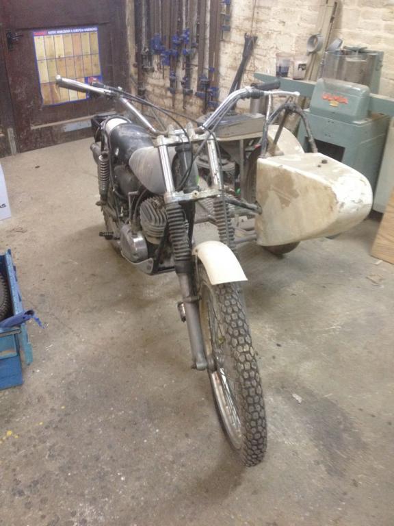

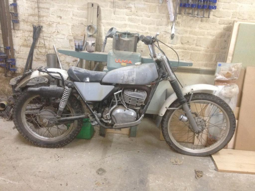

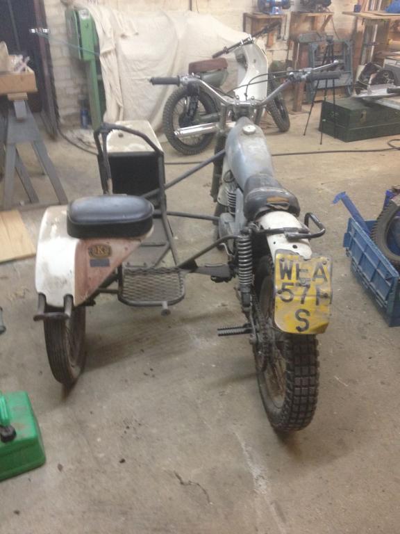

Hi Guys,
Just been reading your conversation and found it really interesting. I have had a kt with sidecar for about 15 years and have finally decided to drag it out the barn and do something with it. I thought you might like to see some picturespost-20695-0-97437800-1421251074_thumb.jpgpost-20695-0-80443200-1421251101_thumb.jpgpost-20695-0-80443200-1421251101_thumb.jpgpost-20695-0-39760500-1421251141_thumb.jpg
Awesome! That is really neat! I've personally not seen one with a sidecar before. Thanks for sharing.
Brandon
