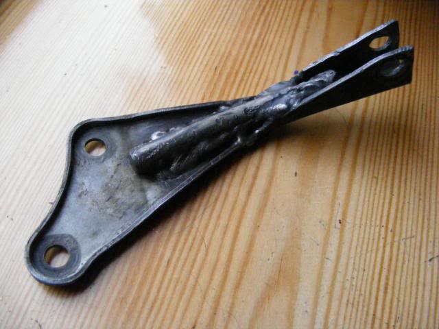

hello scot yes the headsteady was done like this when i got the bike looks like a proper job weld is tidy it's also been ground down both ends so it's flat on the head. also i had another 199B with a good mod to the headsteady the plate that bolts to the head had been cut clean off then a thick tube had been cut then welded onto the plate on the other end it has been made flat and rounded off with a hole to bolt to the frame hear is a photo.

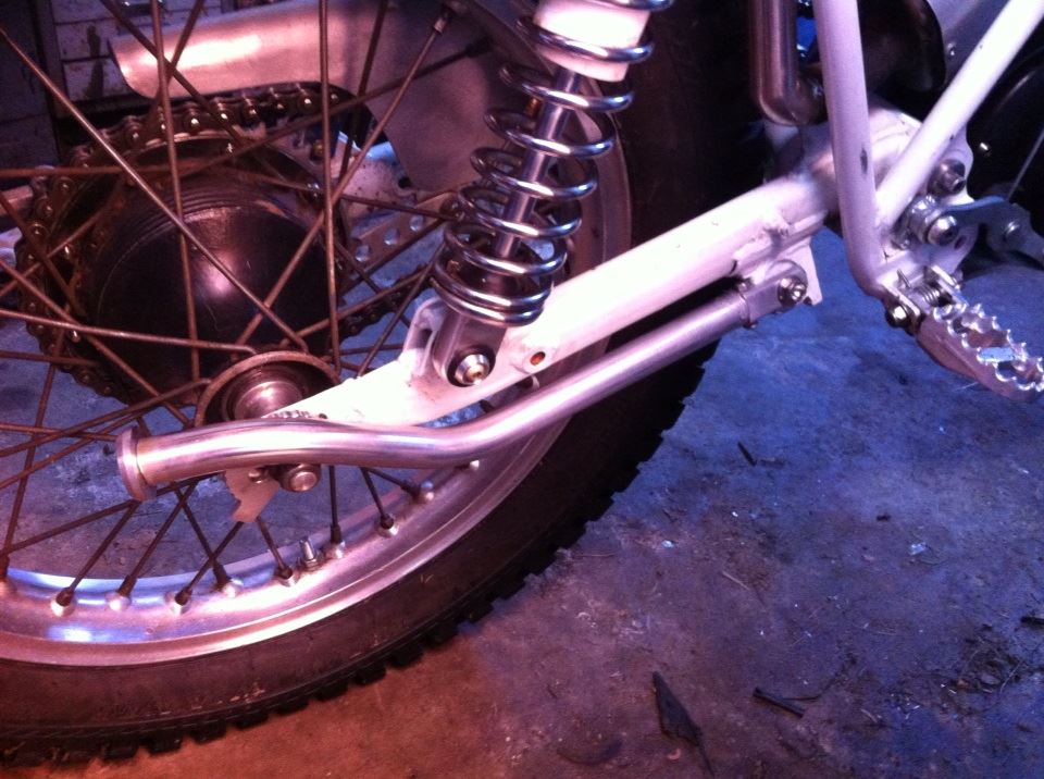

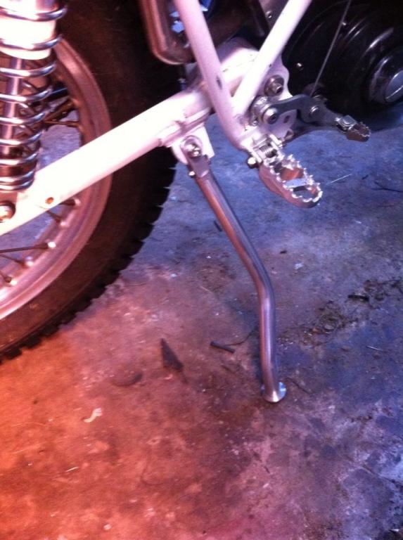

    Think I must be losing my mind...I have just become the newest member of the 'I made an alloy sidestand from an old pair of handlebars' club. Need to get out more...

scot yes there are a few ideas out there to make the headsteady stronger the 1 above on the 199B was good if you wanted you could take the Engine out with out unbolting it from the head i never tryed as i ended up striping the Engine. cheers bondy.
post-14329-0-20528500-1428436527_thumb.jpgReally nice sidestand work!!! You must show us the rest of the bike as I see other mods & tell us the history.

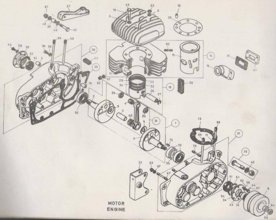

The spacer is #39 in this parts book illustration - the trouble is, if you don't know it's there you remove the top bolt and before you realise it, the spacer rolls away down its custom-made chute (the frame bracket) - never to be seen again.......
The part no. is 138.10-119 and it's described as a bush.

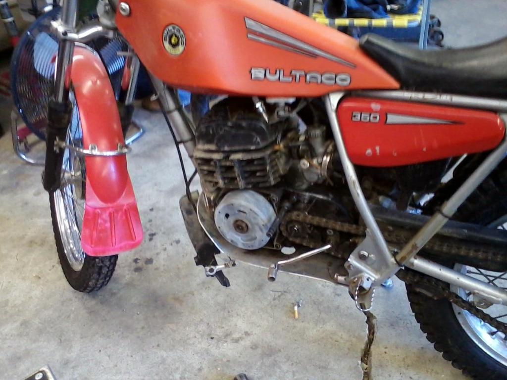

Thought I,d post a picture of Larrys (lbhbul) handy work on repairing my brothers rear motor mount.It fits like a glove and should make it a nice tight bike again.I also had a pic of my head stay that I revamped last year,but after looking at the picture it,s too dam ugly and will get re-engineered.
Edited by scot taco
