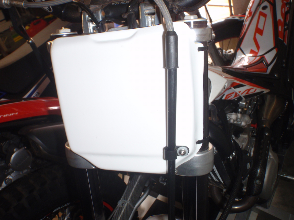

I want to put a number board on my Evo, but I can't find a brake hose guide to replace the one on the light. The last time I didn't secure the brake line it ended up rubbing a groove in my folk clamps. I have looked everywhere but have had no luck so far.
Any guidance would be appreciated, cheers Richard.
As JB has suggested... I put a Monty 4RT one on my wife's Beta 250 4T for comps.
Mags
Here is a pic of how well it fits... no trimming needed, just 4 zip clips to hold it on.
I used an automotive wiring loom clip to hold the brake line and still allow fork movement.
Mags
