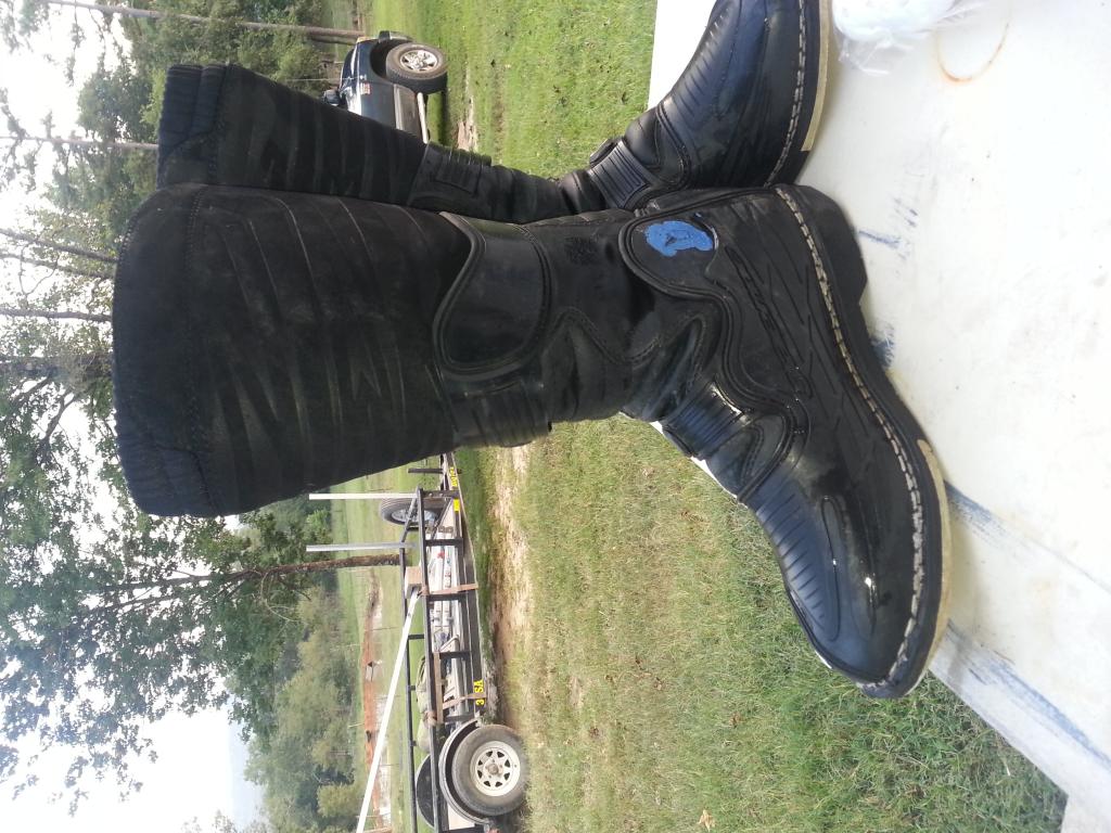

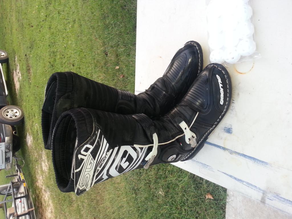

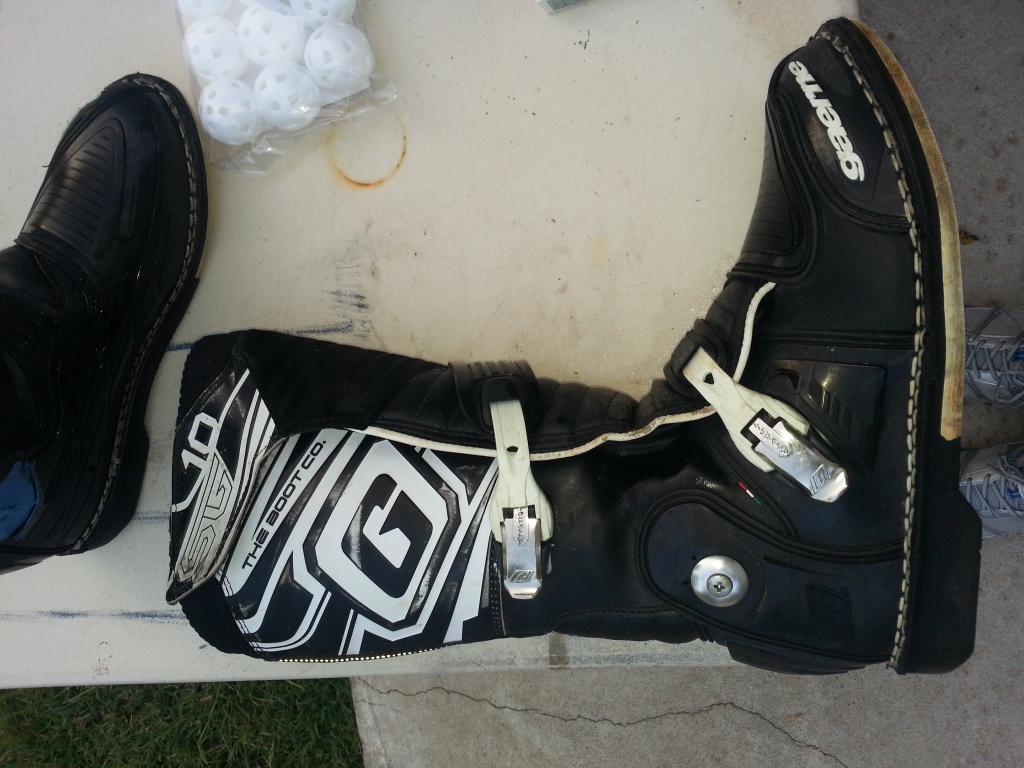

Had a pair of sg10 mx boots that i rarely wear and got to looking at them closely. Turns out that the hard plastic flap that covers the shin is removable. With that removed, it was missing only 1 buckle.
i removed the buckle from the flap, lined up and punched holes for the buckle directly into the boot leather and mounted the buckle. i then removed the old metal hinge from under the plastic that could rub against and scratch the bike, and filled that pocket with silicon RTV.
Next to come off was the metal toe guards.
Voilla!  Flexible heavy duty trials boots.
This mod is not possible with the sg12 due to the flap being intergrated with the boot. I'll try to post pics when I get back from out of state.
