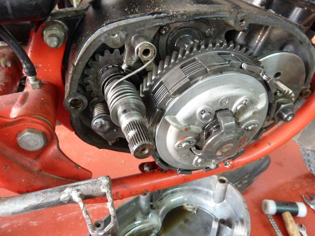

With great difficulty, I am struggling with mine currently, i have replaced pawl, idler gear, springs etc, but can't get the correct tension. Been told that you do it after the cover is fitted, but no tried that way yet, attempted the way that allows the slot in the shaft to be in the correct position for kickstart bolt with cover not fitted for visual purposes, the small pawl needs to be at its narrowest point on the cam where it picks up the the deflector piece that is screwed into the inner casing when tensioning, been at it weeks, works, then slips through after 6-7 kicks, hope we get a solution!!

I get what you mean,Zero and it works fine for 6-7 kicks, then slips through so I have to repeat the process. Do you do yours with clutch cover off or on? Meaning do you tension then fit cover, or fit cover and then tension Zero??

Hope this can be of help ...
That is the position I found the last time I opened my engine. I'm afraid I don't remember more details. :-(
It's very similar to this picture that belongs to a 242 engine with a different clutch.
