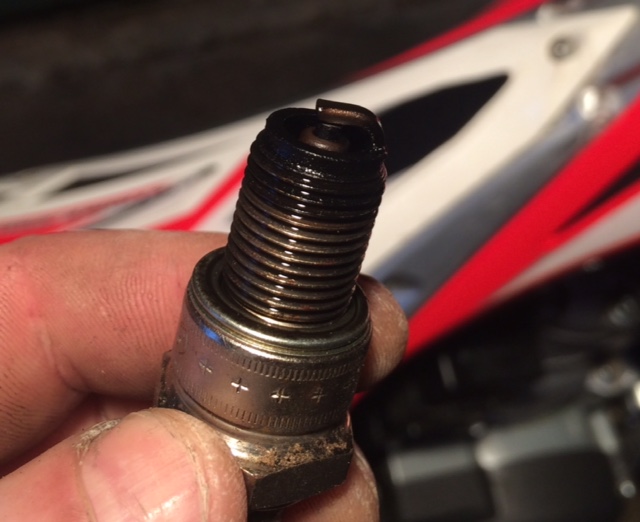

thanks again , this is a picture of my plug iv just took out ... wet!
What gap is that plug set at ? It may be the angle of view but it looks too small.
B4ort ...
That's not solving the issue, there is a reason the plug is getting like that.
Cheers though
Are you sure about that gap ? That looks more like 0.15mm or 0.006 inch ! ( commonly known as six thou)
Just humour me and check it again ?
Kind regards
0.6mm (0.024") spark plug gap should be fine (though your gap seems too small in that pic), but that spark plug looks like it is running very rich - either too much fuel, or not enough air. Are you running a clean air filter without too much oil on the element?
Check your Main Jet & Pilot Jet and Needle clip position. Maybe you are just running too rich?
Also, since these engines run at relatively low RPMs, you can get proper lubrication running your Pre-Mix Fuel with 98 Octane gas and Oil mixed at 80:1 (helps prevent spark plug fouling and gives better burn inside combustion chamber). This also assumes that your Ignition Timing is set properly.
My bike also only needs the Choke, when engine is cold and I can shut Choke off within a few seconds of starting it up.

B4ort ...
Cheers though
A fouled plug can, and will, cause erratic running. You might have solved the original issue, but won't know with a duff plug. What's to loose ?
