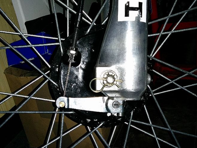

Fitted some new brake shoes today on the Beamish
While it was apart I moved the brake arm to where its meant to be, it had been in the wrong place since I bought the bike back in April.
even without bedding the new shoes in, its feeling a lot better than before.
Only one spline out but makes a difference
How it was
how it set now (there is even a mark on the cam to show where its meant to be)
Edited by shakennstirred
