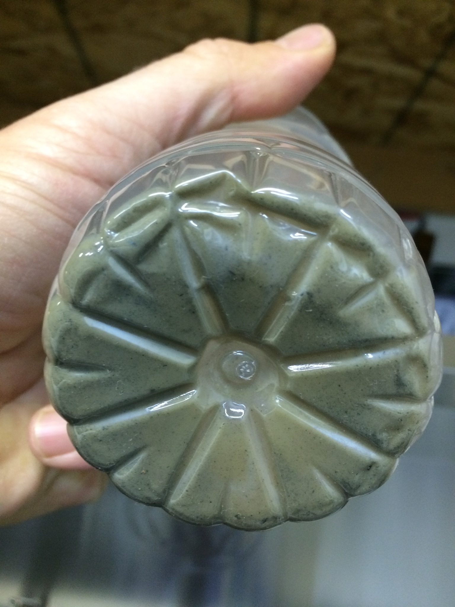

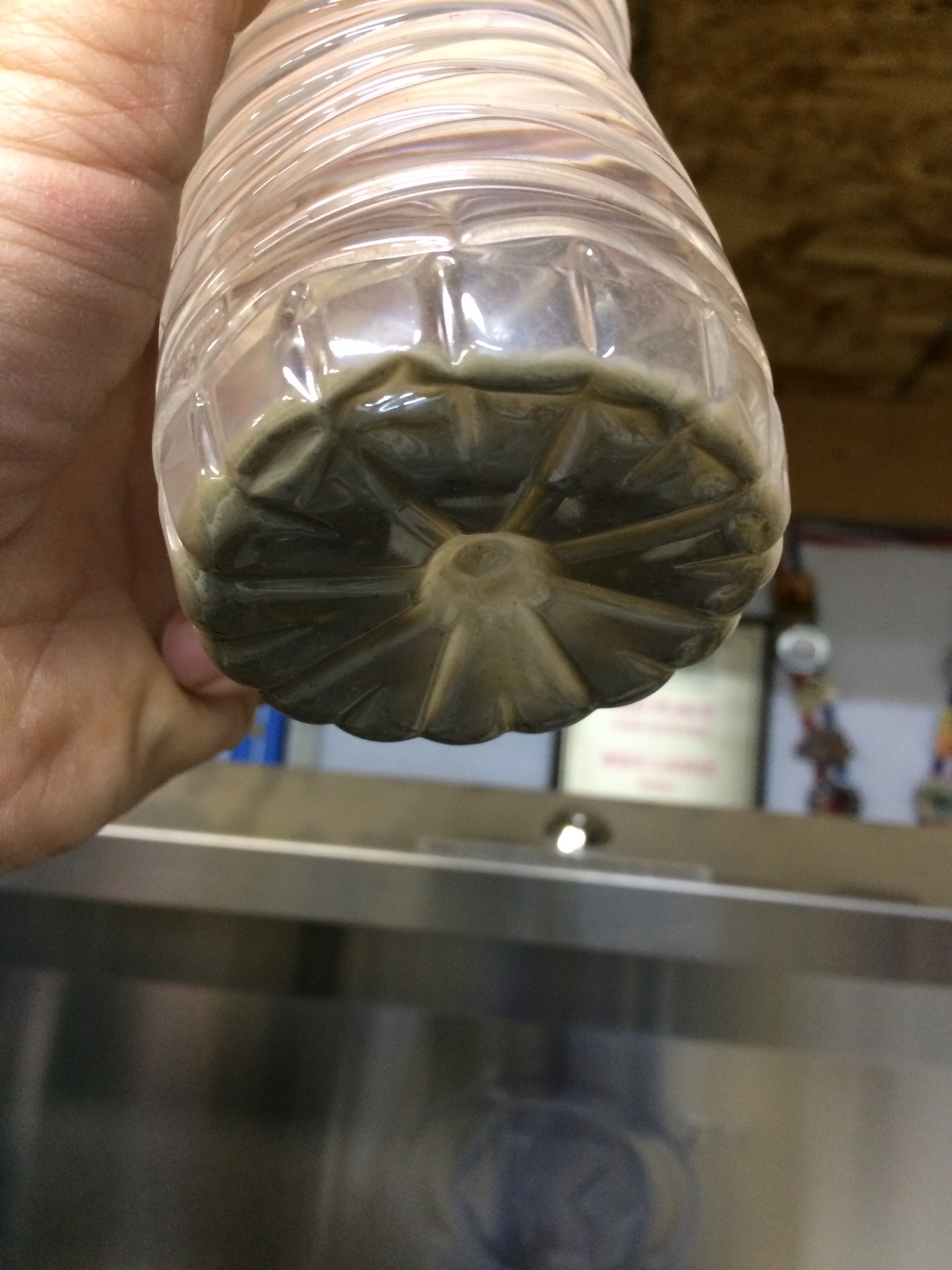

I wasn't sure if my little Gasser (that I bought in November) had a decent mix of antifreeze, since I may need to store it in sub zero temperatures sometimes ... well, I drained it and what was in there came out full of crap and obviously ancient <_<
I'll be changing it again after the next time I've ridden the bike, to make sure it's well flushed.

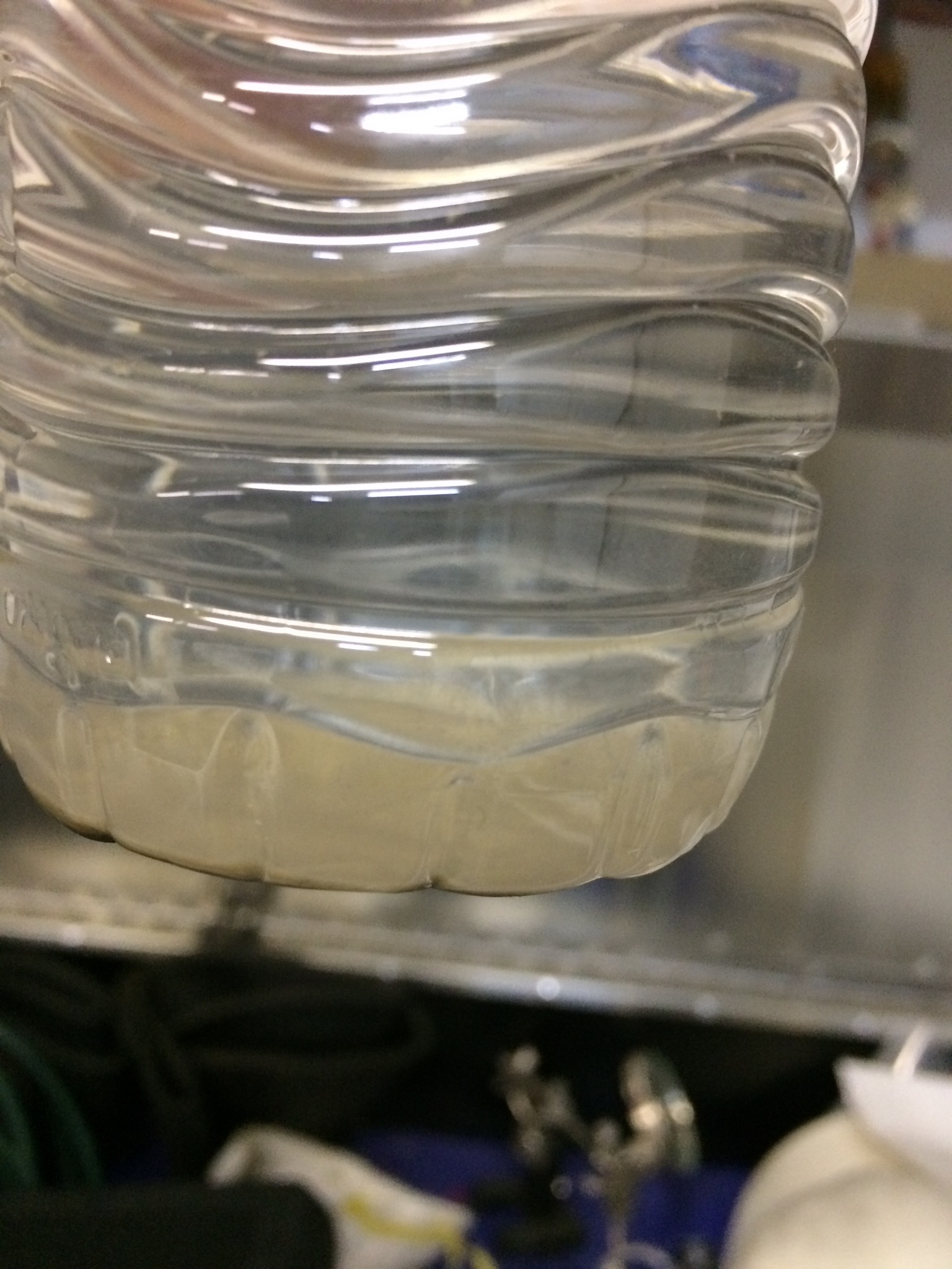

When I purchased my used Ossa 280 it had 65hrs on the clock. The prior owner used distilled water for coolant, which was said to be a season old. Since I often travel into areas that may fall below freezing I opted to change to Engine Ice (which I still have a bit of from snowmobiles and enduro bikes).
It came out a bit cloudy, once I allowed it to settle overnight here's what it looked like. Although I've seen worse I'll rest easier knowing its freshened up (and freeze protected).
