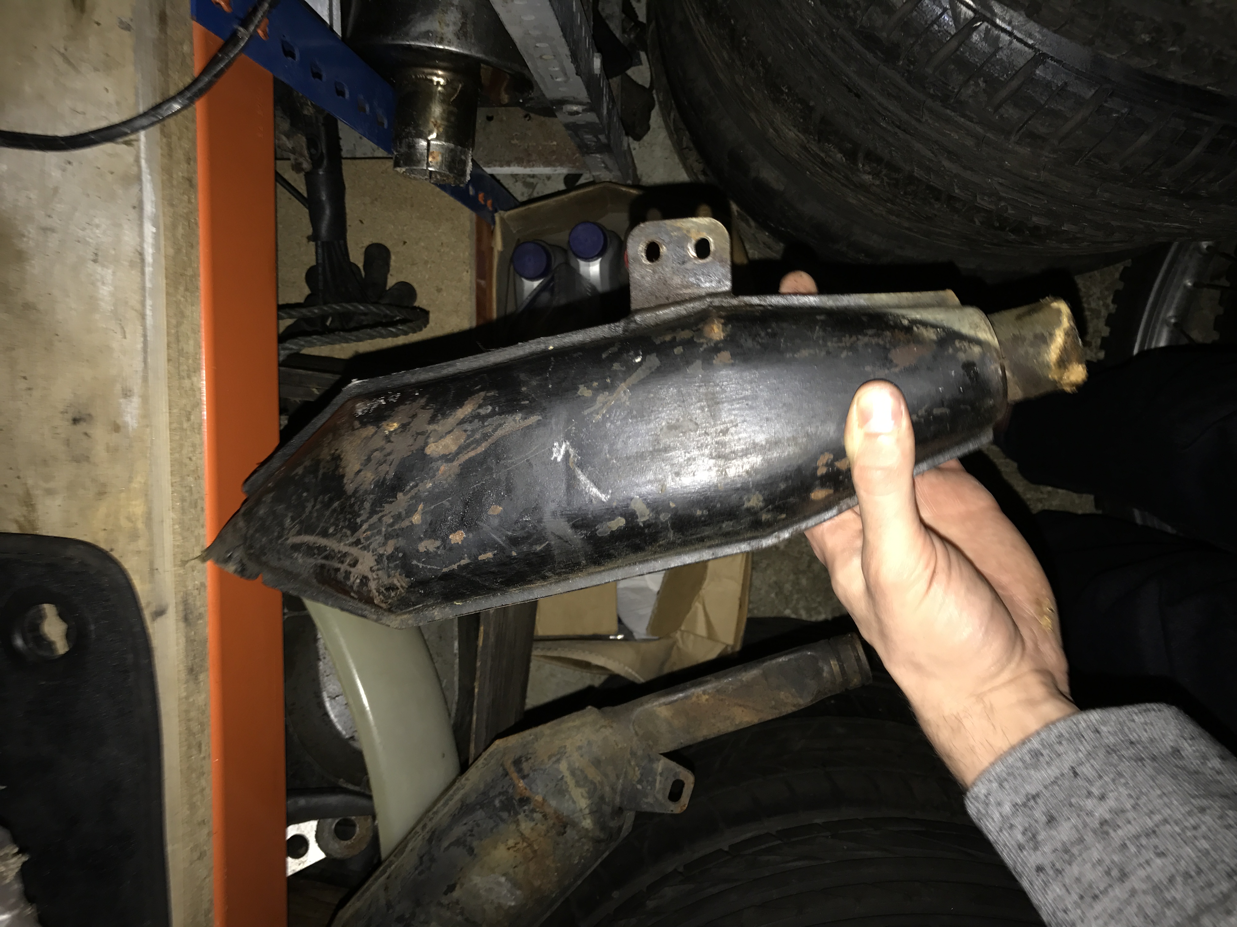

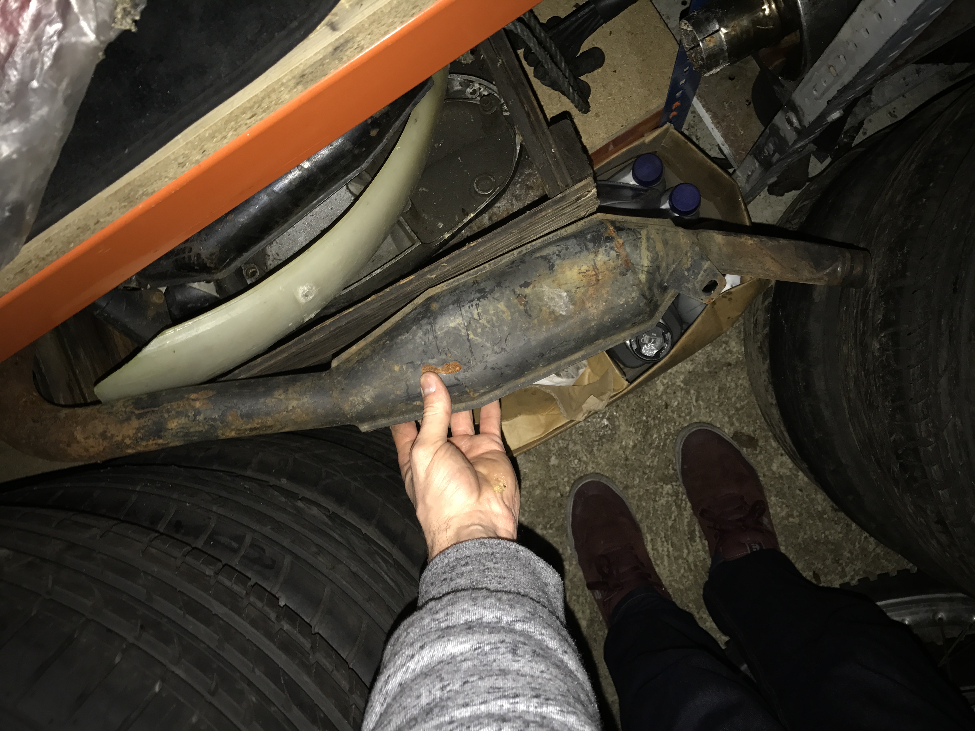

I've checked the frame number, it reads 51M0401. Only information on this I can find is that it's a Cota 348-349, do the last 4 digits help you pin point the year? I couldn't find info on this. Also included some photos of the exhaust, as I couldn't get to the engine this morning.

Thanks. Sandiford Off-road (try googling them) may have historical records of the frame/engine number dating as they were the importers for Montesa. The silencer indicates 348, not 349. Seems the bike is therefore a 77/78 model.
One thing worth checking is whether there is any damage/evidence of repair to the frame near the headstock as some 348 frames snapped in that area.
A good source of commonly needed spares/information is Inmotion trials (again, Google them).
That's a 348 - right shape tailpipe and frame loop over the rear mudguard, just has a 349 type alteration to the frame to integrate the bash plate.
349 bash plate had straight edges - see HERE.
