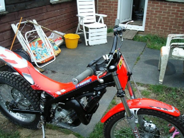

Fit Rev 250 rear shock, change to 57T rear sprocket, fit Beta jet kit, lighten sump guard, fork yoks, front hub & Disc. Fit alloy wheel spacers. Open air box inlets, and rework (FRONT exhaust pipe) lock stops, front mud guard bracket, fit 4 pot front caliper, use Gas Gas 2000 tubless rear wheel, and then you can do stuff like this.... :D
All of the above.
Plus you can fit Raga Bars,
06 Sherco Black frames, old hat now, been done ready.
Yes Yes when you talk Beta 80, you talk Jake,george,& chris rule OK :D:P

agiow what clamps did you use to mount the bars? They look cool as does your black frame :D

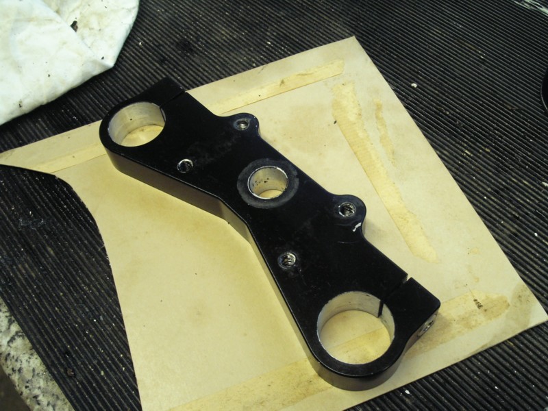

Hi Sirhc
i made a all new headstock (see picture)
then used the Raga fatbar clamps
or you could use Renthal fat bar clamps.
