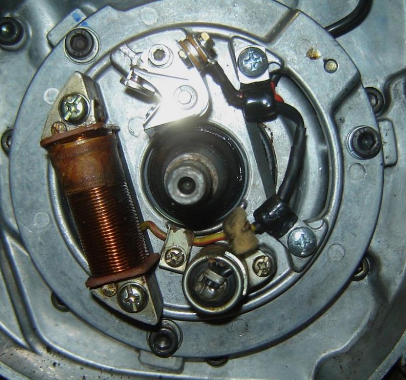

On 8/8/2017 at 2:36 AM, scot taco said:
Guy, I will let you know how/if it works when I get a chance to ride it maybe this weekend.
When it comes to electrics I really am a novice idiot so I wont be too surprised if something does not work right.
Here is a photo of what I did.The new condenser is mounted under the tank and I bought it at the automotive parts store.
Scot,
How did you rewire the new condi?
