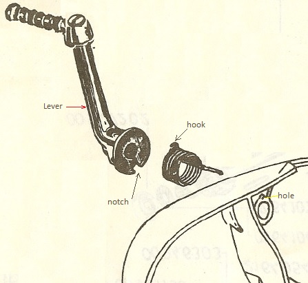

Now I have another question re the kick start return spring. I've looked at the drawings and the spring from Inmotion and the lever appear to match the drawing in the parts manual. I assume the hooked part of the spring goes into the notch at the base of the lever.
To assemble these parts the spring will have approximately half a turn of tension on it with the lever in the home position. That means a full turn of tension at end of lever stroke - is this normal? It seems like a lot of tension, certainly far more than is needed.

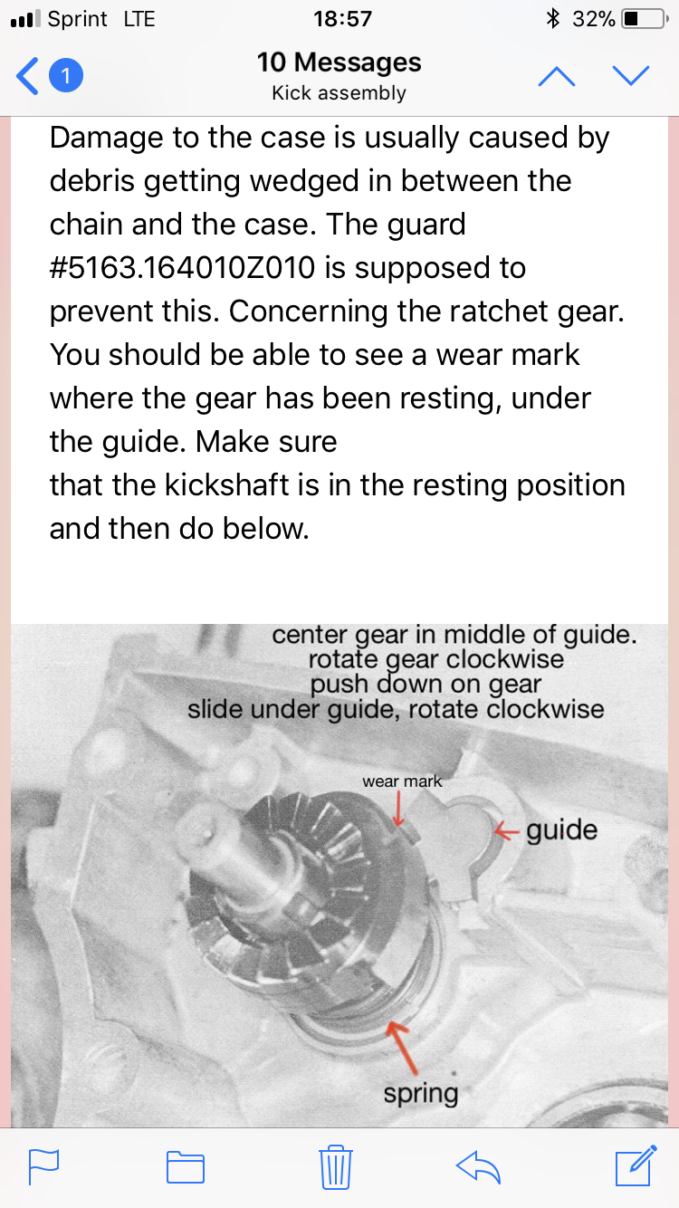

Greetings Oldaz.
Here is the 349 set up. Maybe this will help. Keep us posted on what you do to arm the spring. We will need to do the same soon we hope

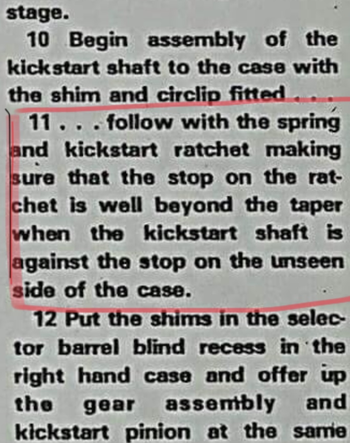

Perhaps posting a picture will help solve the issue.
Here’s a note from a rare guide on assembly of the 349 engine.
Can anyone out there please paraphrase step no.11?

Thanks, but I'm referring to the external kick-start lever and it's return spring on the 247 engine. The inner part of the spring locates in a hole in the timing cover and as near as I can see, the outer part has a hooked end to locate in a notch in the clamping area of the lever. Problem as I see it, is the spring has to be pre-loaded by half a turn to get into the notch, then it will be loaded a further 180 degrees as the lever travels through it's throw. This puts way more tension on the spring than is needed, so I ask the question "is this arrangement correct"? Or maybe do I have a wrong lever?
That's how my 349 is, it was a bit of a struggle to get it on but feels like the right amount of pressure on the bike (I had a new spring with a new kickstart lever from InMotion, the old one was pretty sloppy in comparison)
