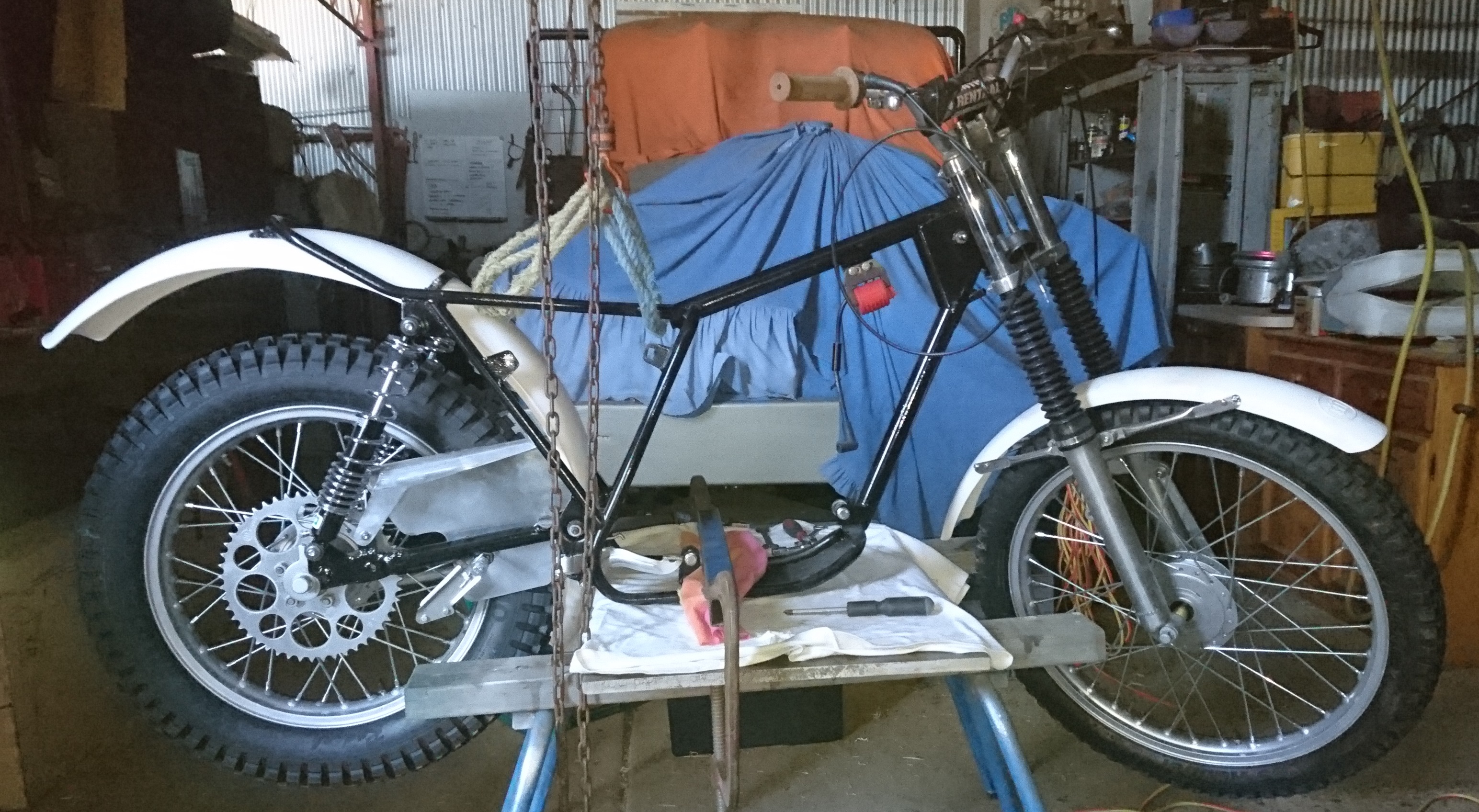

A little more progress, finally got the wheels back, they did a great job, hydro-blasted all the alloy, new gal spokes with phosphor-bronze nipples and the rear hub machined and new bearings fitted. I completed the modifications to allow the after-market brake shoes to fit, made new spacer for front wheel now there's no speedo, fitted the new tyres, tubes, bands, rim locks and got the wheels mounted in the frame. It's starting to look like a bike again.
Got the barrel and head are away for hydro-blasting, made a start on the new head studs to replace the M12 cap screws PO put in there, new gaskets and flywheel puller on the way from Inmotion, should get here in a week or two, meantime I can finish off the brake connections and other detail bits, then get back into the power unit.
