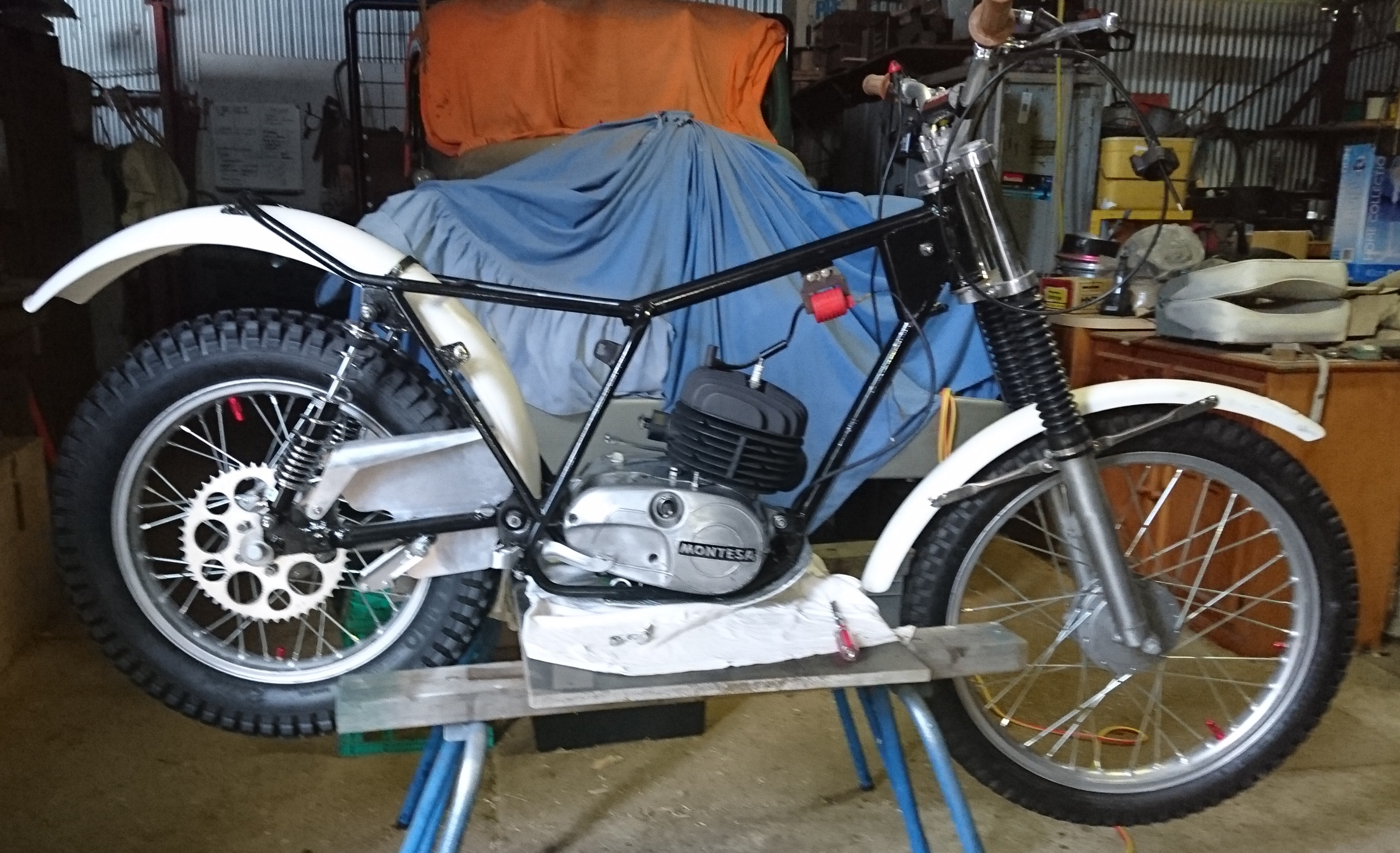

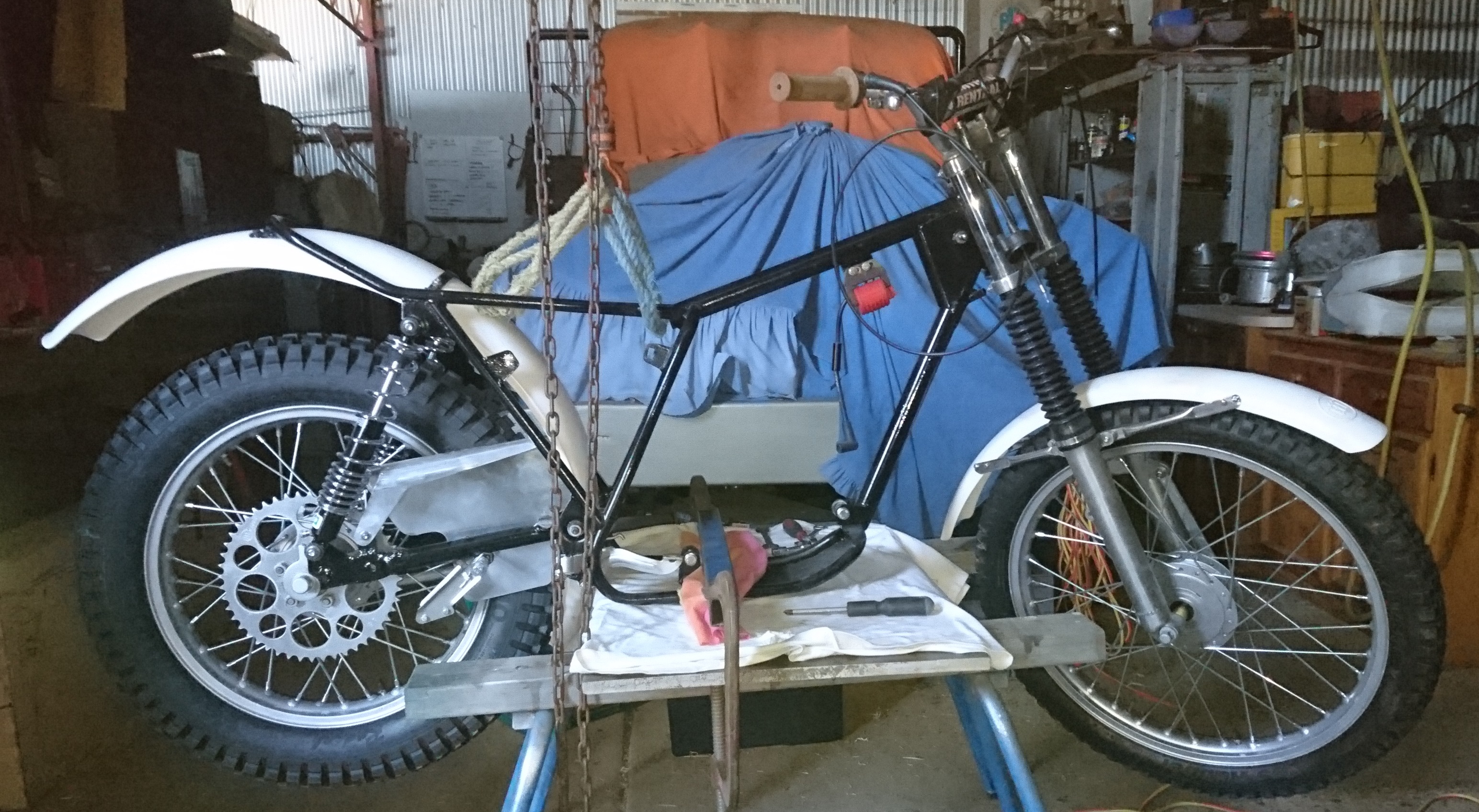

Wheels all rebuilt, new tyres, tubes, bands, rim-locks, brake shoes modified and fitted, made new spacer to replace the knackered speedo drive and fitted the wheels to frame, the fitted up the brake levers, etc - all fixings are stainless steel, even inside the plates. I'm very pleased with the way it's coming together.

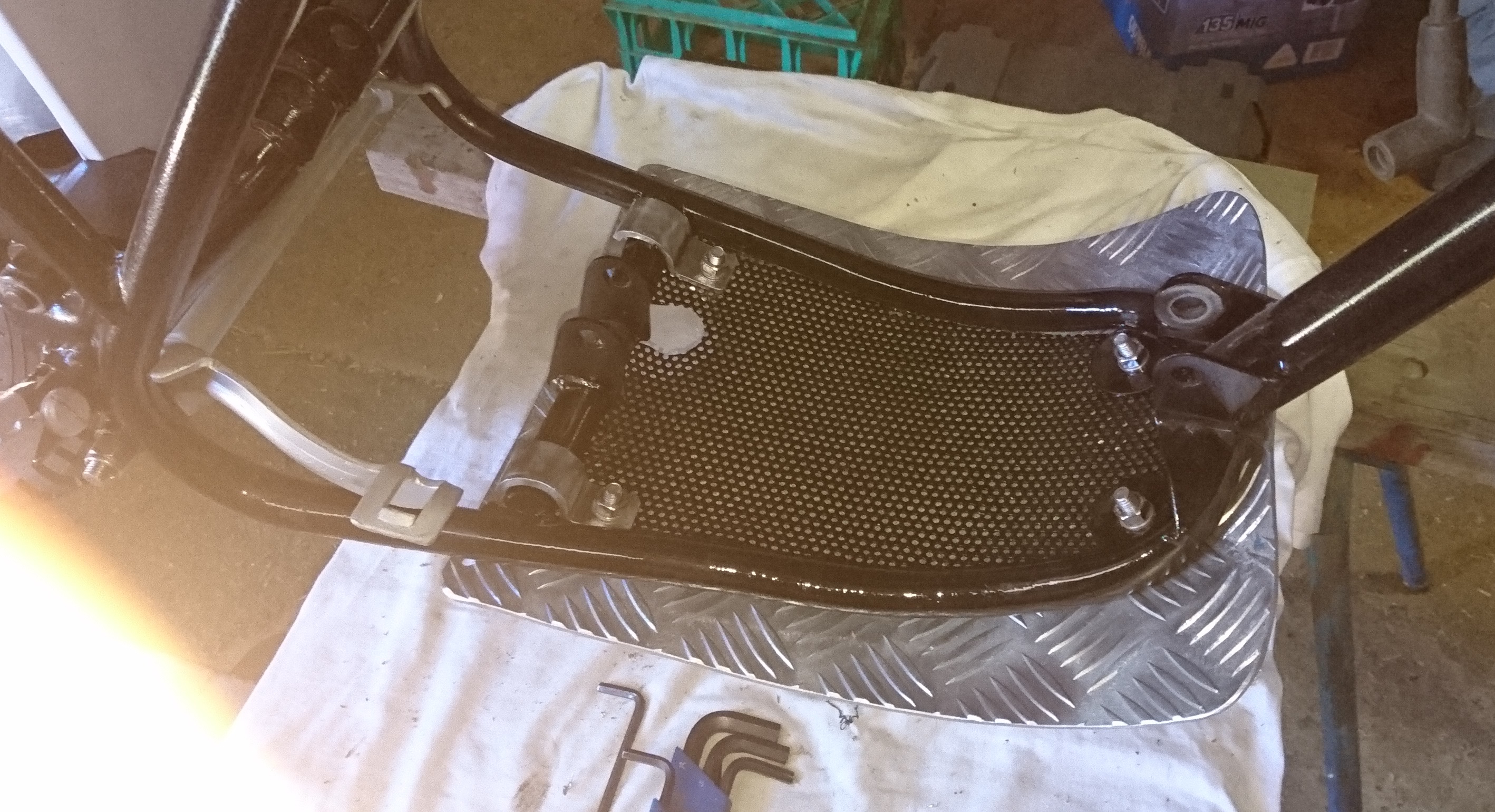

Bash plate made and fitted, (picture below) details are in a separate post, it came out OK, so that's the end of the "frame" work.
In process of stripping engine further. The barrel and head are back from hydro-blasting, a bit more tidying up and finish the new head studs and it will be ready for some engine enamel.

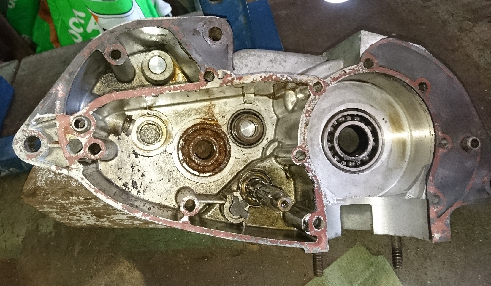

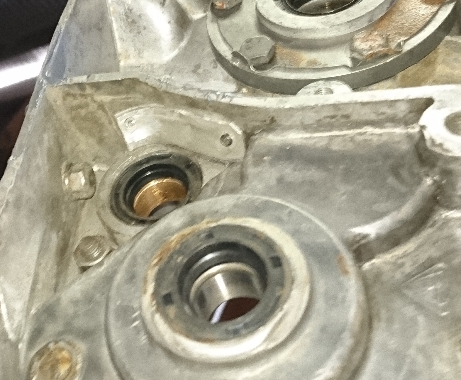

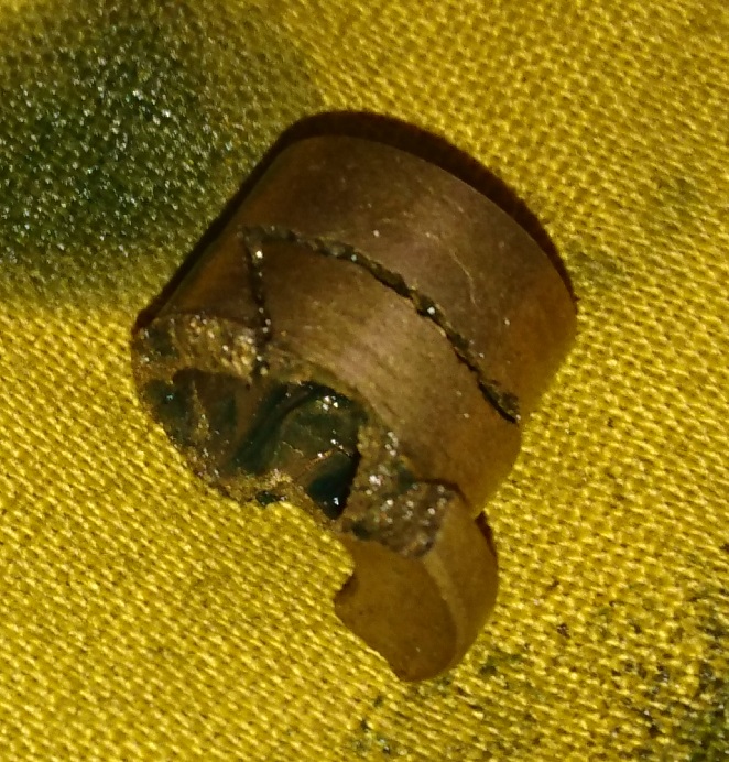

Finished off and installed the 2 new head studs to replace PO's M12 cap screws and started tearing down the bottom end. Finally found the cause of the slack in the final drive shaft - the bearing is full of rusty water, probably trapped in there from when the bike was lying on it side all those years. Another "interesting" one is the inner bronze bush for the kick-start shaft is missing about three quarters of the flange, but so far no sign of bronze bits in the gear case, so unsure what's going on there.
Looks like I'll have to fully strip the bottom end and try to find the missing bits of the bush, then make a new one. Will replace crank seals while I'm at it, so progress will be slow for a while. New final drive shaft bearing and seal on the way from InMotion.

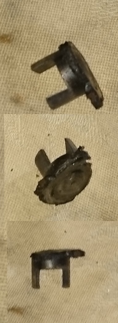

I sure hope you're right :-) Did some measuring and seems all the kick-start shaft bushes and seals will have to be replaced - also need to figure out what's going on with the kick-start mechanism - at the moment it looks like the shaft has been only going part way into the inner bush when the spring should allow the ratchet to slide on the shaft instead of the shaft sliding in/out - this added to the play in the middle bush has caused the inner bush to fail.
At least I found the missing bits of the bush, some of it was ground up by the gears and caught in the drain hole and the biggest chunk was jammed into the top of the drain by one of the gears - took some getting out. In case anyone is interested, the drain hole in the bottom of the case is only about 8mm, then opens up to about 12mm where the plug is - no idea why it wouldn't be 12mm all the way through - it will be when it goes back together. Picture of the remains of the inner bush below.

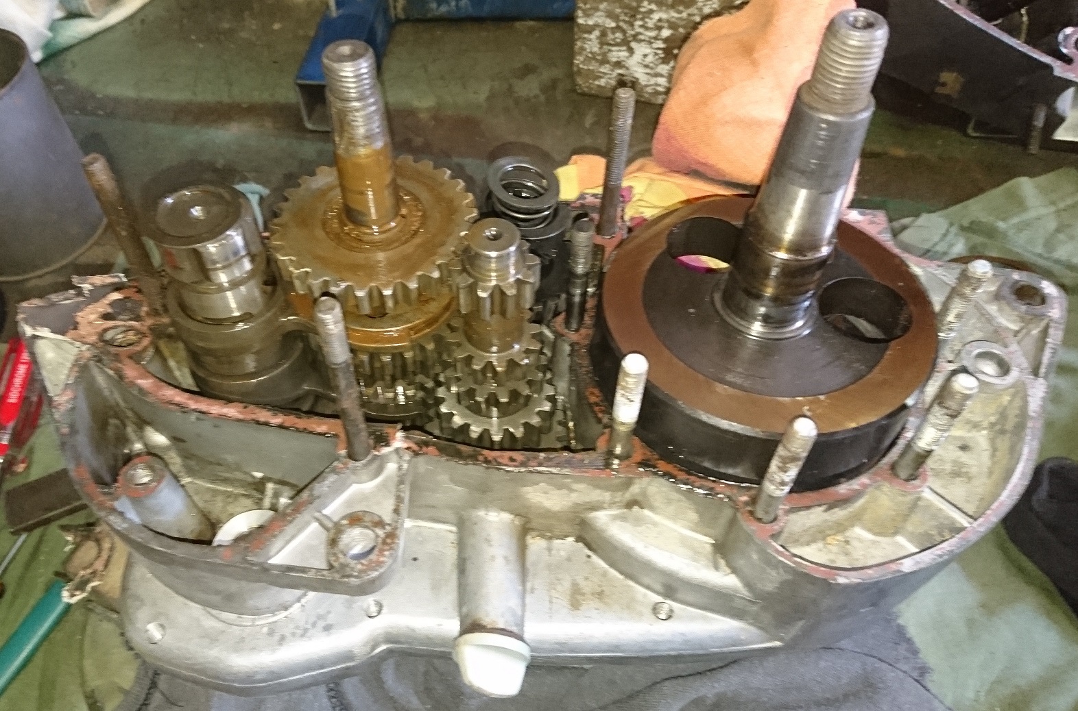

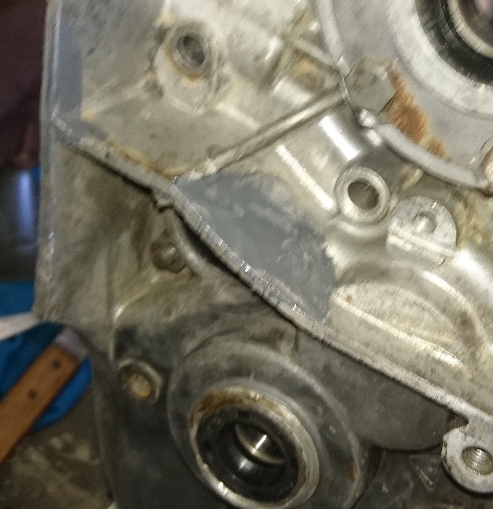

Got some more done over the last couple days. Completed the kick start settings/clearances and timing, repaired the case damage from kick start over-travel and tidied up where the chain had hacked the side of the case, fitted the new seals and bearings, modified the oil drain and assembled the two engine halves. I was pleasantly surprised how easy it was to reassemble.
When the kick start timing is correct and the lever is in the right place, the mechanism is quite good and it becomes difficult to over travel the shaft and cause the damage - there's even enough room to get a thin metal plate on the side of the damaged casing web. Pictures show the aluminium patch on the kick side and the JB Weld on the flywheel side. I veed both sides of the hole in the case web, screwed the patch in place, then completely filled the hole made by the kick start shaft stop. Now when the timing cover and gasket goes back on there shouldn't be any water ingress into the magneto.

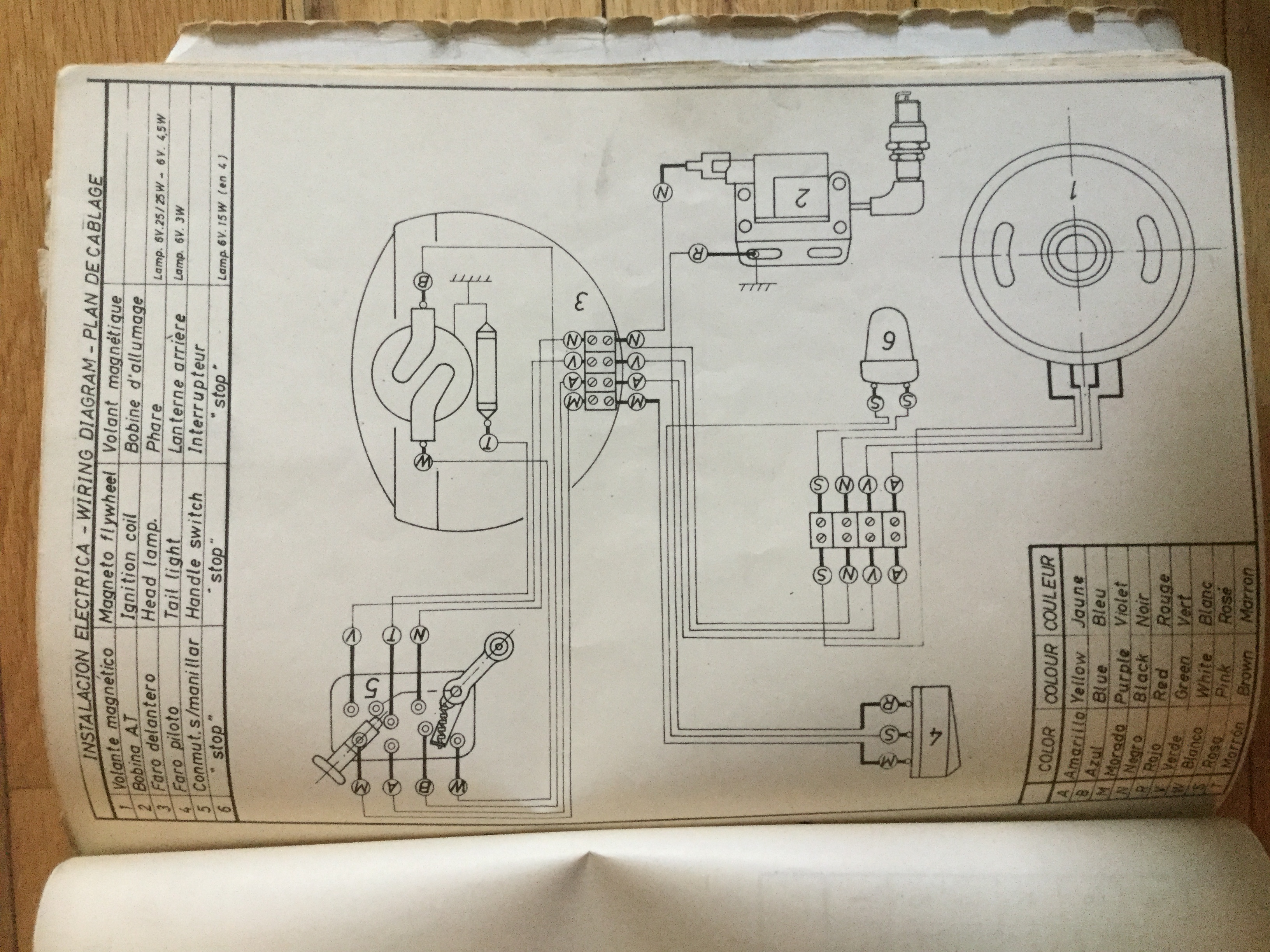

Does anyone have a wiring diagram for the ignition on one of these? I won't be running lights, so only need the ignition circuit.
Thanks deleriousdave, most helpful, made it so much easier to figure out which wire I need to keep.

Finally finished the engine/gearbox rebuild and fitted back to the frame this evening. Also took some pictures of the remains of the steel clutch follower I replaced - shows what happens when you run steel on steel without oil - or not enough oil.

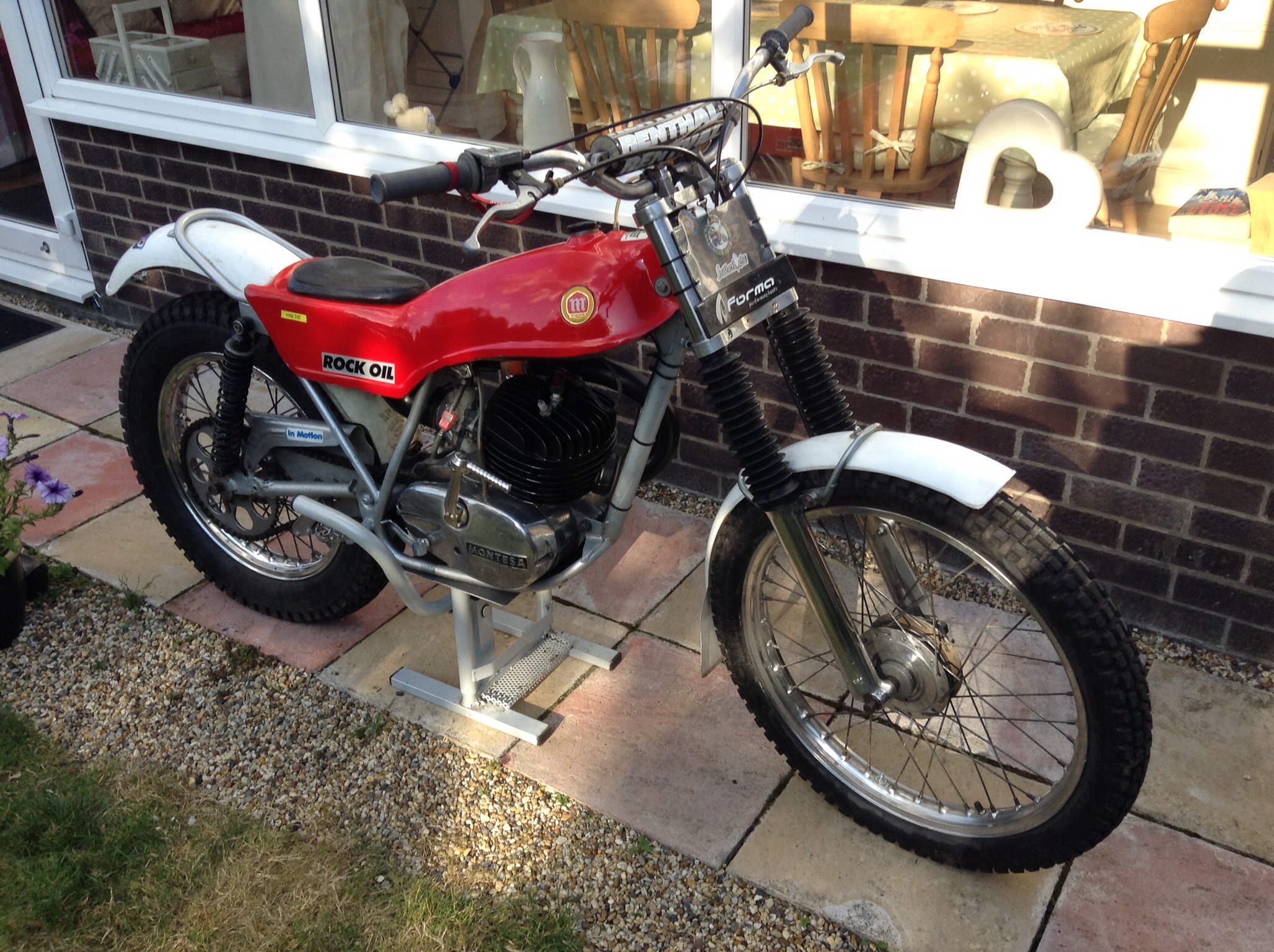

Hi Oldaz
Been following with interest your refurbishment of your UKR. I have a mk4b the version before yours and have found similar problems to what you have come across. Your timing cover might have been damaged by the chain but pay particular attention to the inner case around the Kickstarter shaft, in a lot of cases the Kickstarter itself has been positioned to far forward on the splined shaft in the miss belief it would give a longer throw to the kick, unfortunately all it does is allow the stop on the shaft to punch a hole through the inner casing allowing water/moisture into ignition.
The correct position of the kickstart should be the ' one o clock ' or 30 degrees, or looking side on parallel to the frame down tube.

Interesting. The 349 we are restoring has a hole too at kicker shaft area. So, this is caused by a miss positioned kick lever? I dreaded that something in the mechanism close to the case may have been the culprit.
