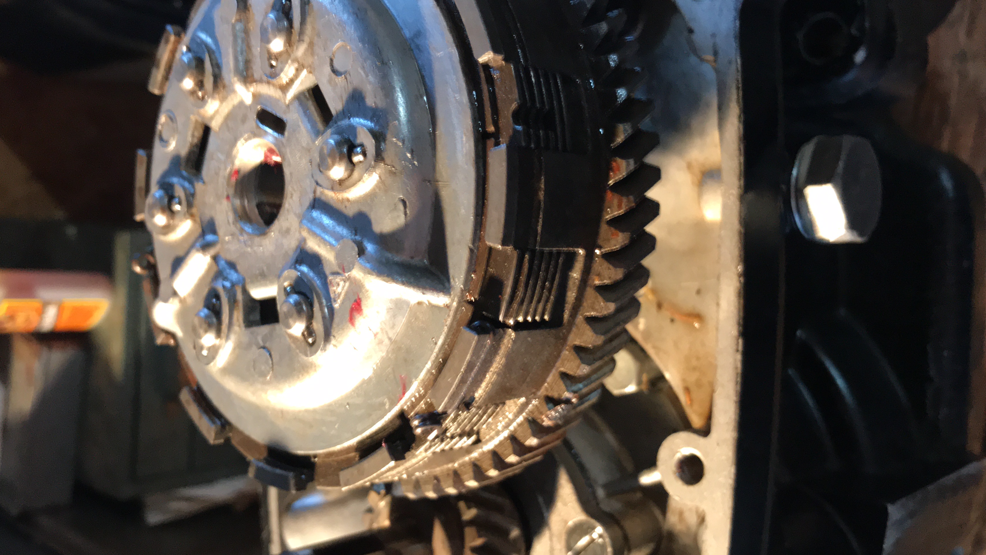

Turning our attention now to the clutch basket while out crank and cylinder are being reworked can you let us know how you removed the discs from the Outer geared set from Disk Set? Any pointers and things to look out for?
thank you kindly.
Edited by motosolex
I made a new pusher, did some work on the lever arrangement and refurbished the 3 leg pusher, but I didn't strip the basket as it looked good. That said, your clutch looks different to mine in the way it's assembled and it doesn't appear to have the little anti-rattle springs around it.

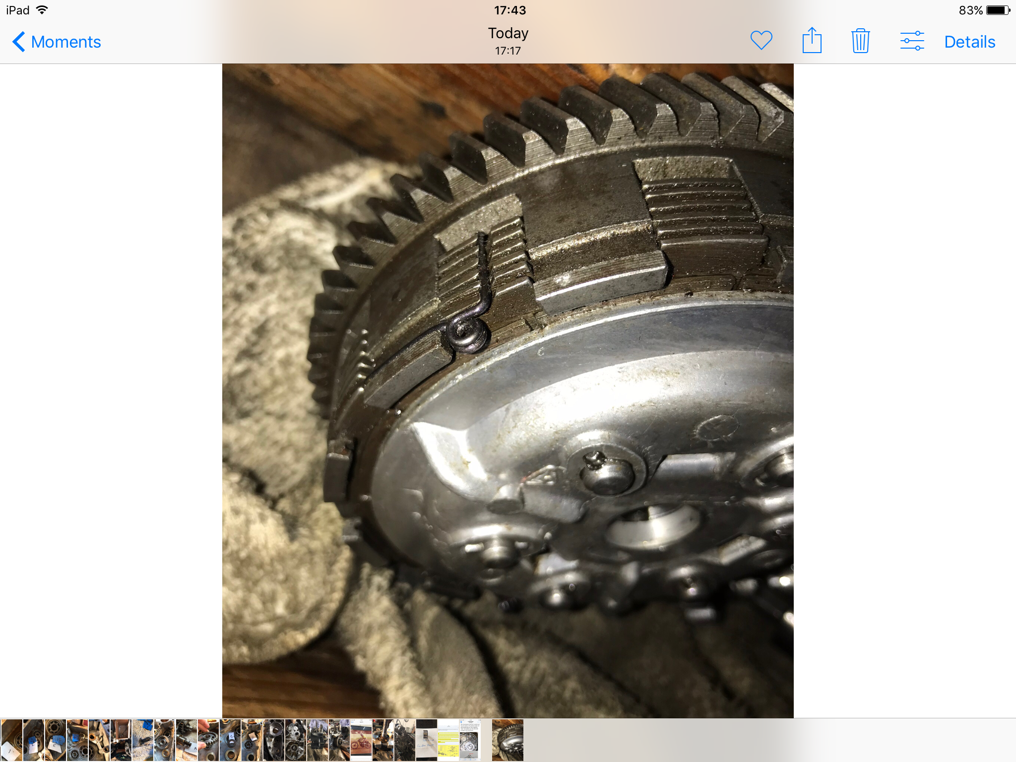

Hi fellows.
Any advice on removing the 349's spring retaining pins (i think PN 0263.11305) on the outside of the plates so as to disassemble the clutch for inspection?
Also, any specs on plate wear?
Thank you
Edited by motosolex
Like I said earlier, I haven't worked on other Montesa models, but it looks to me like there's pins coming through the basket from the inside and being held in place by those small, maybe 3mm pins that locate into the cover. I assume the clutch pressure springs are on those same pins, so I would look at maybe compressing the clutch and take out those 3mm pins, then the cover should come off?
Thank you Oldaz.
Something is really odd on mine. I can't get the clutch to be pressed in to to release tention so as to pull out the pins which would allow me to remove the plates. That is why I was asking about removing the retainer springs on the outside of the basket. When we got the bike the clutch was already removed so not sure what its condition is. It seems really dirty and maybe corroded.
Thanks.
Maybe start a new topic and ask about the 349 clutch? There are others who should know more about it.
Those springs look like a later version of ant-rattle springs and I don't think they will make much difference to what you want to achieve. Remember the clutch lever puts a huge pressure to release it, you have the lever at the handlebar ratio multiplied by the lever at the outside of the gearbox, then the tiny lever inside the case, so lots of pressure needed. You might be able to set a strong bar across the plate with a clamp each end?

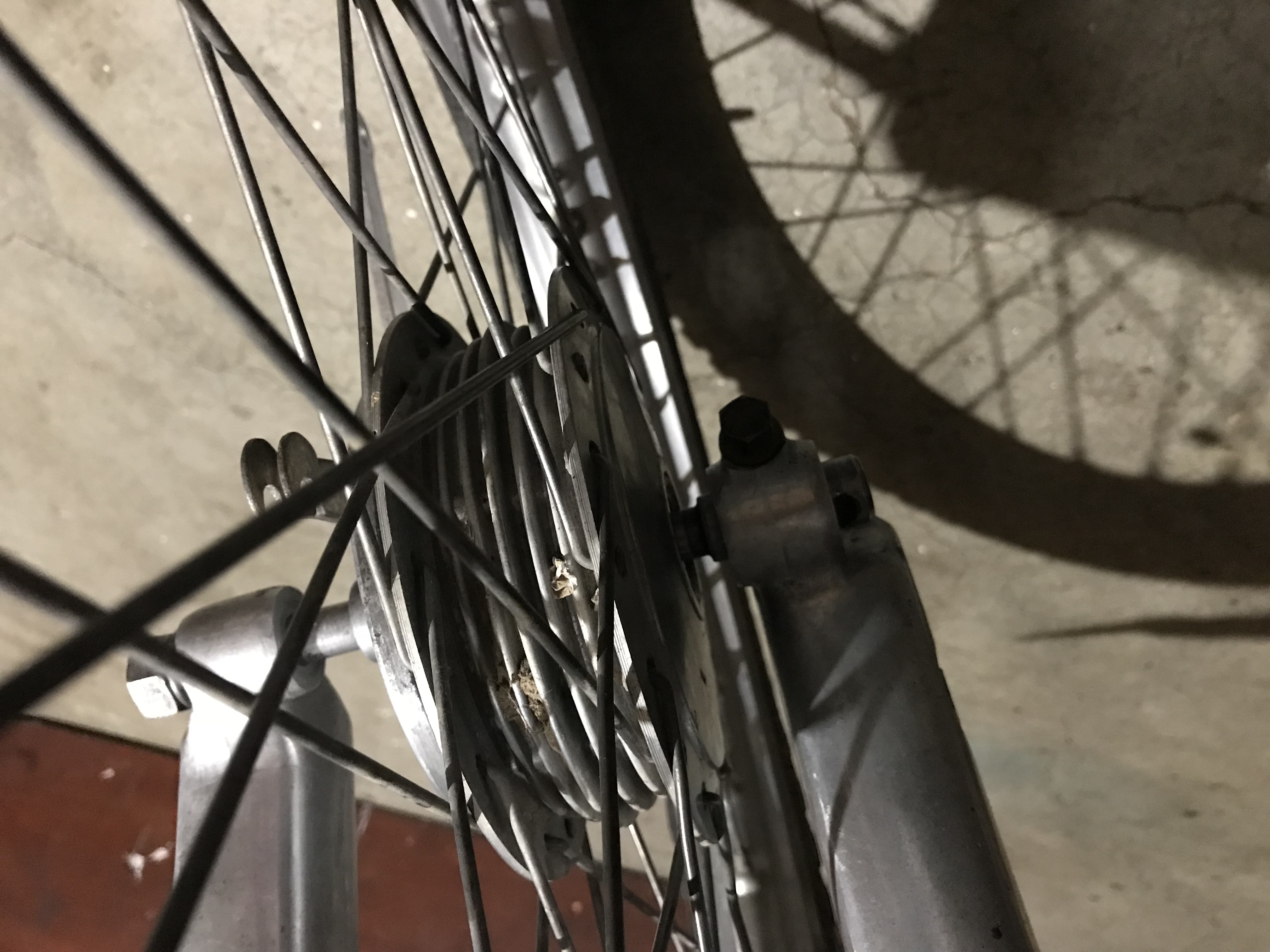

Can you do me a huge favor and take some pictures of the front hubs?
The bike came in parts and we are unsure of the collar and washer locations. We have a speedo too.
That would be great. And thank you.
Patrick

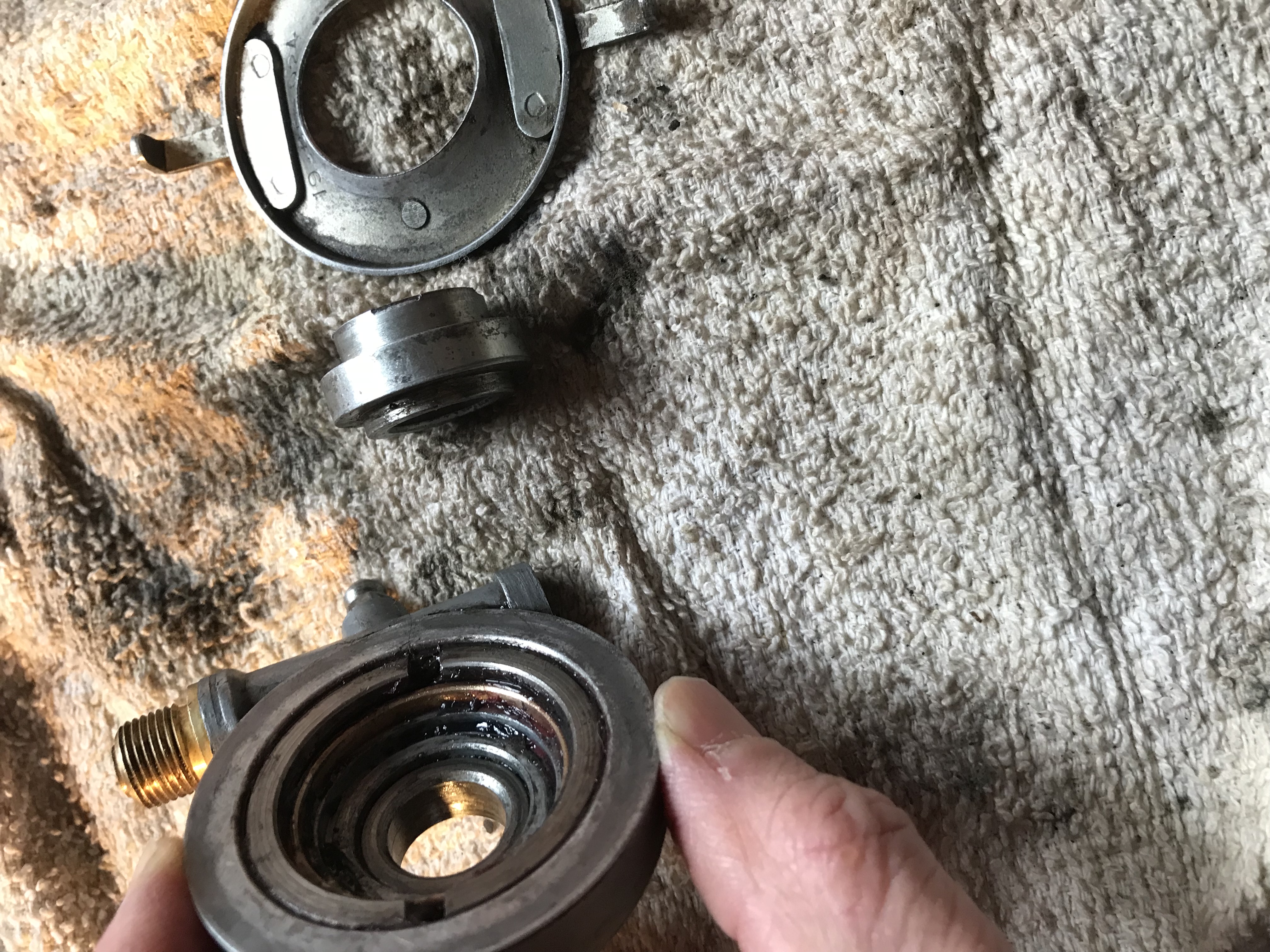

Do you have the parallel or tapered hub? The positioning of the spacers will generally only work one way to centralise the wheel. With the speedo drive in place - if it's same as 247 with 3 tabs holding it - the spacers will be similar both sides. If you have stepped spacers the larger diameter goes against the forks. Inside the hub is usually a stepped sleeve carrying the wheel bearings, then a seal on the brake side that matches to the boss on the backing plate. I'm told if you use fully sealed bearings you don't need the extra seal, but I used it anyway.
If you don't use the speedo drive, you'll have to make a wider spacer for that side.

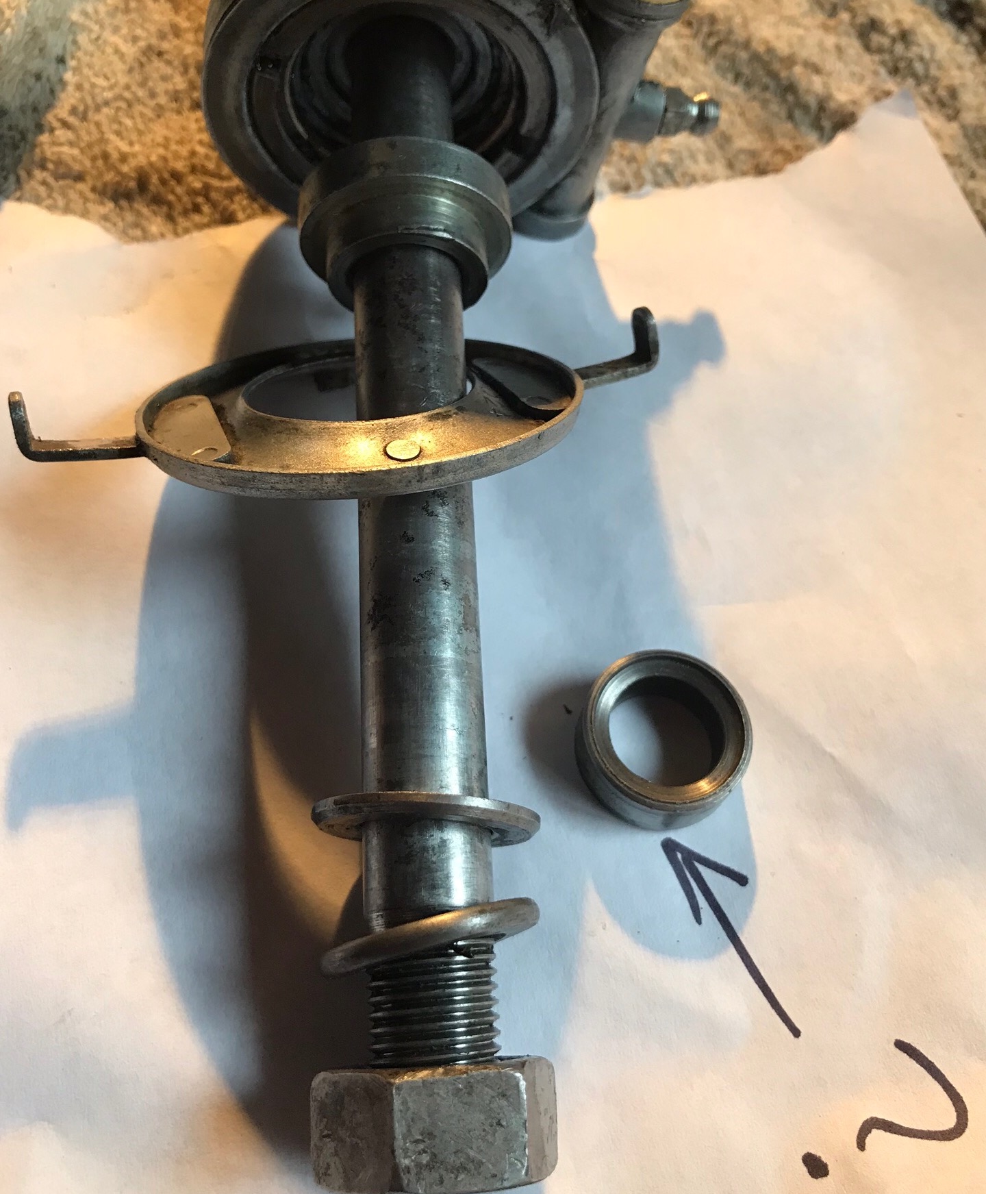

Here’s what we have in the picture. Not sure of the fitment order since bike arrived in parts. We believe we may be missing something.
In the photo the speedo tangs’ plate is backwards. The spacer in question we are  unsure of its proper location.
Looks like same wheel as mine, I still have the speedo drive and associated bits in the shop, so I'll have a look when I'm there later today.
The flat and spring washers in the last picture look like the originals for the outside of the front axle. Axle nuts go on left (brake) side of bike.
Thank you. The spring and flat washer are for sure for the left side of the hub. Look forward to your response.
