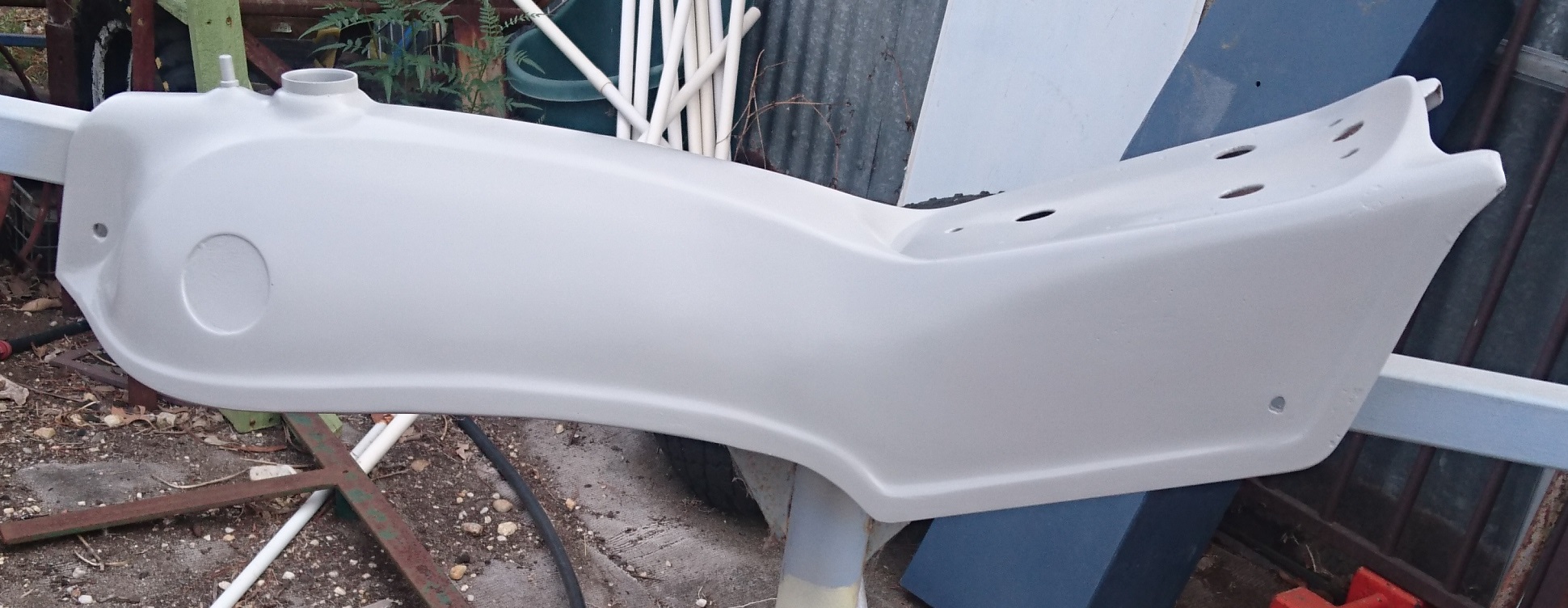

More progress, although it's slow going. Fibreglass repairs completed and first coat of primer-filler on the tank/seat unit. Have to sand it back now and probably a second coat before I get to final paint. The end is finally in sight.
Beautiful.
Did you seal inside?
on ours we did not and the nice new paint almost immediately blistered. Arggghhh!
5 minutes ago, motosolex said:
Beautiful.
Not yet, been out of action for a while, did the second coat of primer filler and sanded back ready for paint. Got the paint, new Ulf Karlsson stickers arrived, but done nothing since. Now hoping to get some tank sealer and maybe finish it off in the next couple weeks, then sadly it will be on the market along with some other projects.
Too bad. The posts you provide are great and helpful to us new guys. Take care.

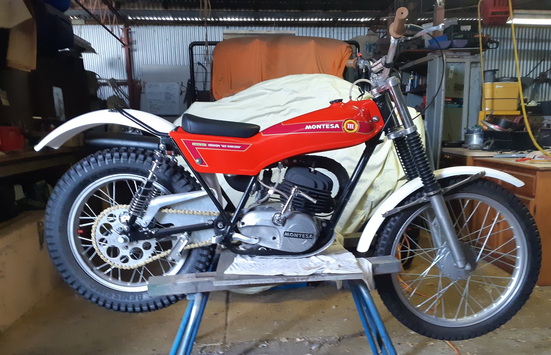

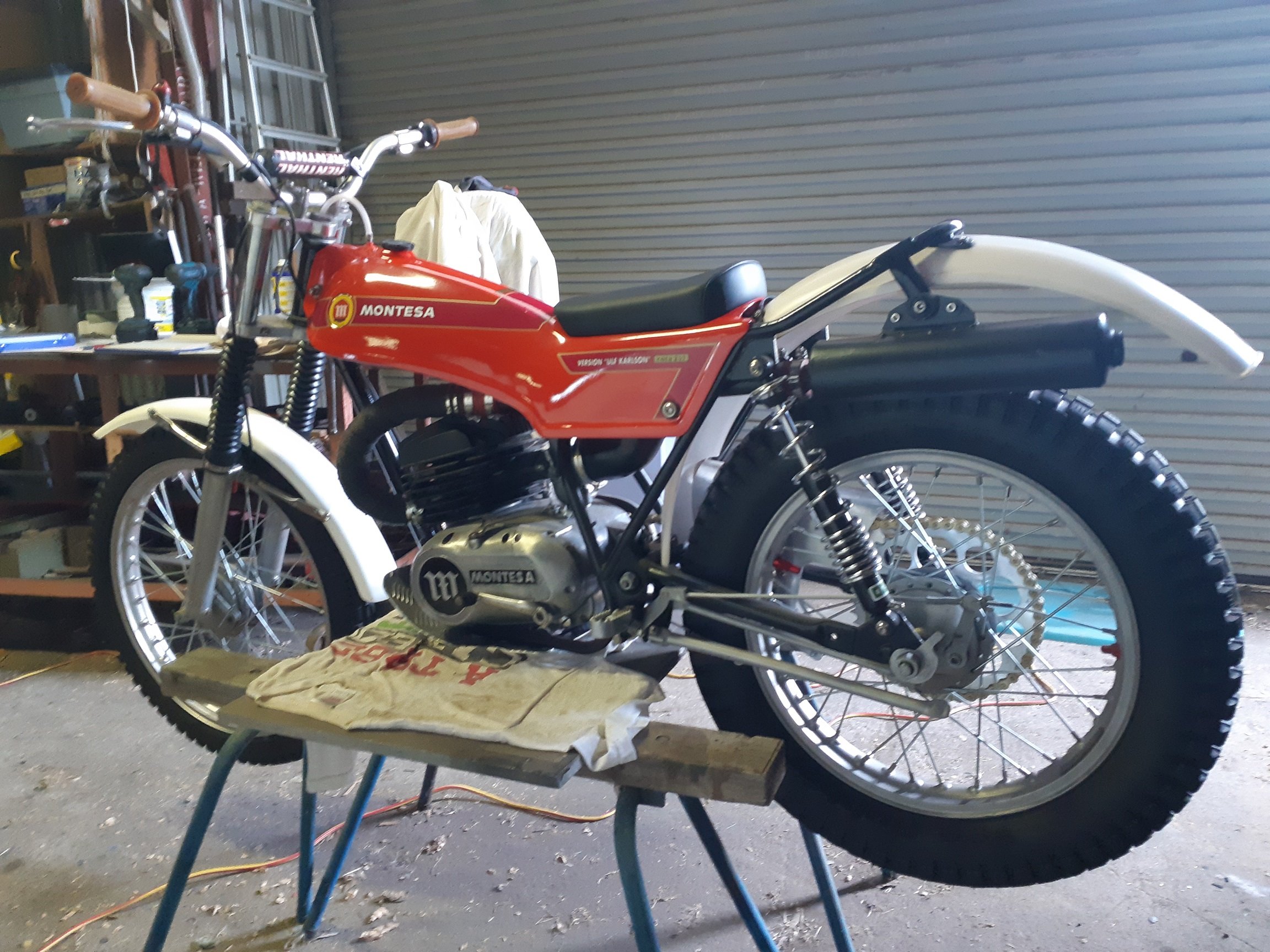

Finished the building stage today, just need fuel and carby tune to end project.
Put some fuel in it, primed through plug hole and it started first kick. Had a (very) short ride around back yard and put it away, getting too old for this stuff, lol.
