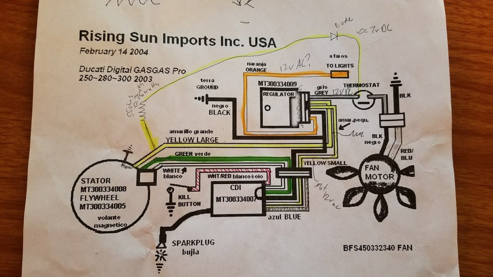

Well the update has bad news. I have more information but possibly made more questions. I tried the voltage divider with little success. I had basically the same success wiring in a voltage divider vs just a resistor. I made a wiring diagram to more clearly show what I did.
What I've done is unplug the "faulty regulator" and jump between the two yellow wires as shown in the diagram. I then pull off the big yellow wire and run a few 25 watt resistors in series to a total of 55 Ohms. I came up with this number because the higher the ohms the less voltage would come out the other side and the fan wouldn't run. This was the comprise I felt was what I could do with the fan still working and the resistors dissipating anywhere between roughly 18 to 125 watts. I felt this was "safe" because its only going to use 125 Watts plus at very high revs which the bike never really goes to, and the stator should safely produce 75 watts of continuous power as that's what my lights option draws. Additionally I used different values of resistors so if the power dissipated exceed 75 watts one of them would burn up saving the stator. After the resistors I run the power through a diode to make some half rectified DC to run the fan. The voltage coming out of the DC side was roughly 5-10 V DC.
I ran the bike like this partly because I was itching to ride and partly to see how it works and ran. It seemed to do so fine, it never missed and the fan came on and ran like it should just a bit slower then it ought to because of the low voltage. It is an inefficient use of power as it heats the resistors a bunch but it seemed crude. The problem came when I started to have too much fun and went OTB. I got up bike still running and killed it with the switch. I recollected myself and went to start it and nothing. I couldn't do anything to get it to start. I pushed home and verified all of my wiring being still good. The stator ohmed out the same and the voltage produced was the same, along with the pickup coil which just leaves my CDI and coil as the problem.
This leaves me with two possibilities of whats happened. Either the CDI actually wants regulated AC to a degree from the stator and since mine was not strictly regulated it very well could have burned up the CDI and coil. The other option is the CDI and coil was what was going bad in the first place and I just finished it off with my trashy riding skills. I can argue for either because my regulator never did have the burning or any signs that it got too hot, but it is very possible and honestly very likely that I burned up the CDI with all my messing about.
It sounds like we need an electrical engineer to step in.   There should be some way to isolate a line to the fan from the line to the CDI.

I figured I should update this to potentially help anyone else who may have similar issues. Unfortunately the correct fix is what sectionone mentioned in the beginning which is to somehow find a used kokusan ignition from another pro. This is what I have done and its been great for a month and a half so far. I am more convinced now that the CDI does want unregulated high AC voltage from the stator, that is how both the kokusan and hydria (and a lot of other systems) work.
However, if someone is more brave than I and wants to mess with this more, I was thinking of finding a small transformer to step the voltage down and effectively isolate the high voltage for the CDI down from the lower voltage that way I would have been able to regulate and rectify power for the fan. I have no idea if this would work but that was what I was going to try next until I was able to score a kokusan.
