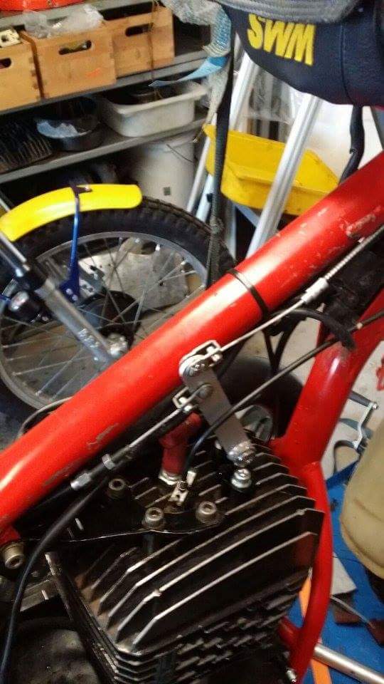

still trying Posted November 14, 2017 Report Share Posted November 14, 2017 That is really good info you have. I have to say that I haven't gone into it as much after trying four springs. A thought did come to mind. A lot of the effort could be in the cable because of the load times friction. reduce the load through a lever, and the spring load can remain. Fitting a lever into the system on a KT is not easy. I'm toying with a rod from the cable connector on the arm up through the cable mount hole (nearest to the cylinder) onto an arm, with the hinge at one end, which would connect to a bracket bolted to the outer hole. Then make the cable holding bracket attach using the cylinder mounting bolt. Make the distance from pivot to clutch rod half the distance to the cable, half the load , twice the feel, and half the movement. It will be quite fiddly making the brackets etc, and getting them strong enough. This will most likely still comply with the rules. The other way is to go hydraulic, (frowned upon I suspect). To do this the easy way is to cut face off the side cover and weld thicker flat one on with bolt holes for slave cylinder from a Late model gas gas (I think), (get the oil type not break fluid type system). Or option two; Machine out the rack system and weld a block in and bore your own cylinder into it with porting where the arm was. This option lets you choose your cylinder size and thus mechanical advantage ratio. It will also look more standard. again go oil not break fluid system, and bore from the inside, so the outside once polished will look stock. Best to have a second cover so you can go back to standard if you choose to do this. 1 Quote Link to comment Share on other sites More sharing options...

feetupfun Posted November 15, 2017 Author Report Share Posted November 15, 2017 2 hours ago, still trying said: And that folks is how you suck eggs!! On the SWM in the photo there is still cable between the clutch and the device which would operate at full cable loading. Your suggestion to have an intermediate lever just above the clutch cover with a rod to the clutch arm would have less friction overall than the setup on the SWM because the whole cable run would be operating at reduced loading. Quote Link to comment Share on other sites More sharing options...
