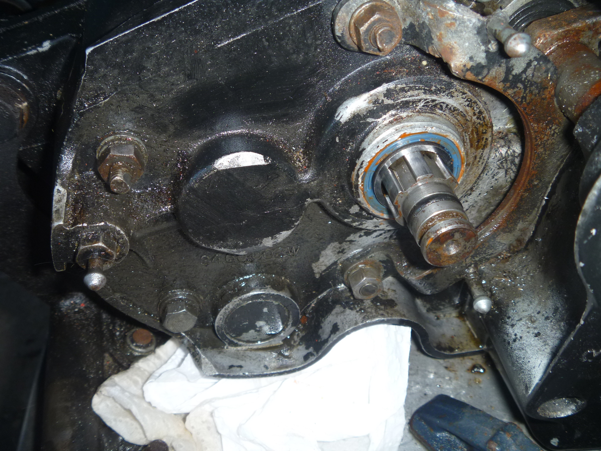

Pulled chain ,retainer and countershaft sprocket ,oh dear the seal is totally gone and not what I thought would be easy to change,very small and looks hard to remove.....bugger.
Anyone know the size of this seal as it looks a real odd one?,cheers .
EDIT and update,fired an email to Inmotion and Pete replied swiftly saying they have the seal and the 'o' ring which I presume go's on the end of the shaft sleeve against the bearing ?...mine didn't have one and after looking @ the way it sets up explains how the oil can travel under the inside of the sleeve and leak @ the sprocket,bloody past owners eh <_<.

Parts arrived from the UK to reseal output shaft seal,all fitted back together,you would think that was the end it however I have another leak,there is a blanking plug you can see above the kitchen towel.
I can only think to drain the oil and clean the area before applying some JB Weld,anyone have suggestions,thanks.
Can you see why it is leaking? Is the vent hole clear? Has the blanking plug come loose/been knocked out of position?
An option to JB weld is to fit a new blanking plug or refit that one using sealant
That's a good point I suspect the vent hole is blocked as the oil drains very slowly without the filler cap undone,would that tell me the vent hole is blocked?,after changing the oil after buying the bike I drained it again because I thought maybe I had overfilled it ....that wasn't the case.
I haven't tried to see if the blanking plug is loose and frankly don't want to,reason I mentioned JB Weld is that is great in this application.
Obviously if this won't fix the problem I will go further,for the mean while I will check the cover vent hole isn't blocked ,thanks.
Checked the g/box vent and appeared to be blocked using a piece of wire,JB welded the blanking plug and filled with new oil no leaks ,happy camper ,had plans for a ride but heavy rain tomorrow our first pre winter storm hits,there will be another day,cheers.
