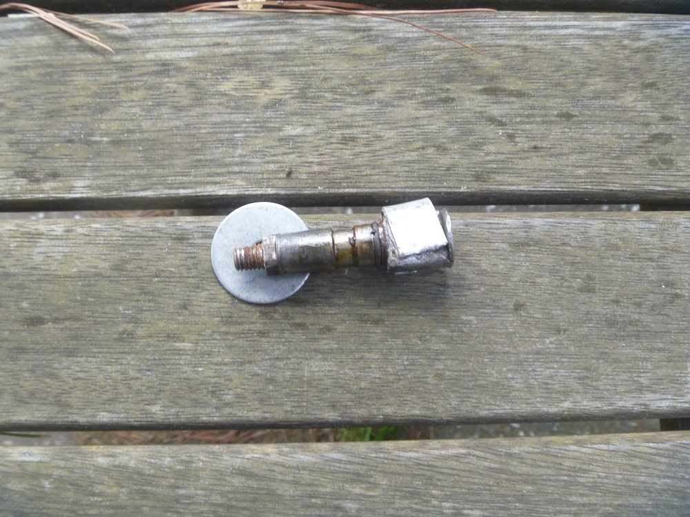

Found the reason the bike stopped the other day ,besides the way some idiot had fitted the fuel tap the filter screen was fitted around the wrong way.
When resealing the fuel tap I found the bolts fitted had been too long and and one threaded inserts had all but pulled out of the plastic,I drilled out the blind hole and fitted a bolt from the inside and sealed the base 'o'ring with blue Hylamar so far so good after 2 days.

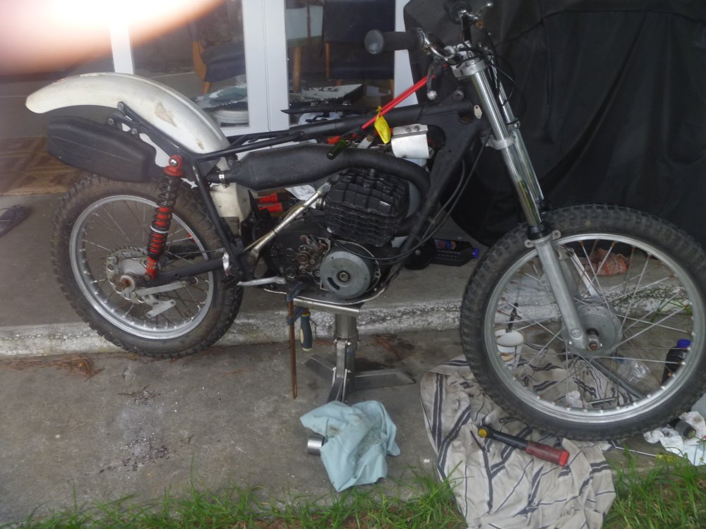

Good day yesterday,not a lot done but happy,got the carb completed as the float needle in the Amal kit didn't fit my carb,Tim @ Britishspares happily swapped it ,he's only 10mins drive away so handy.

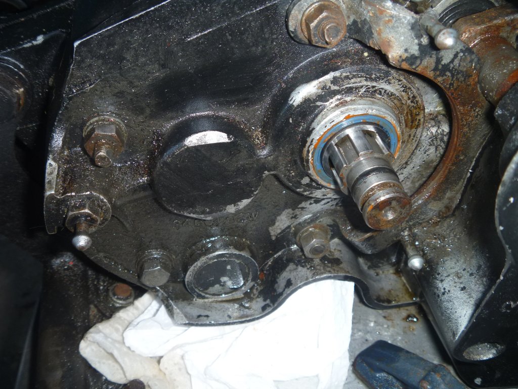

Drained gearbox oil ,found amount was correct but oil was very dirty.....wonder if had ever been changed?,clutch had ATF in it which was clean but level low as I have a leak @ the side cover gasket or it could be somewhere else ,hope not.
Been working in the shade outside the house as it been very hot here with most days in the high 20's upwards.
