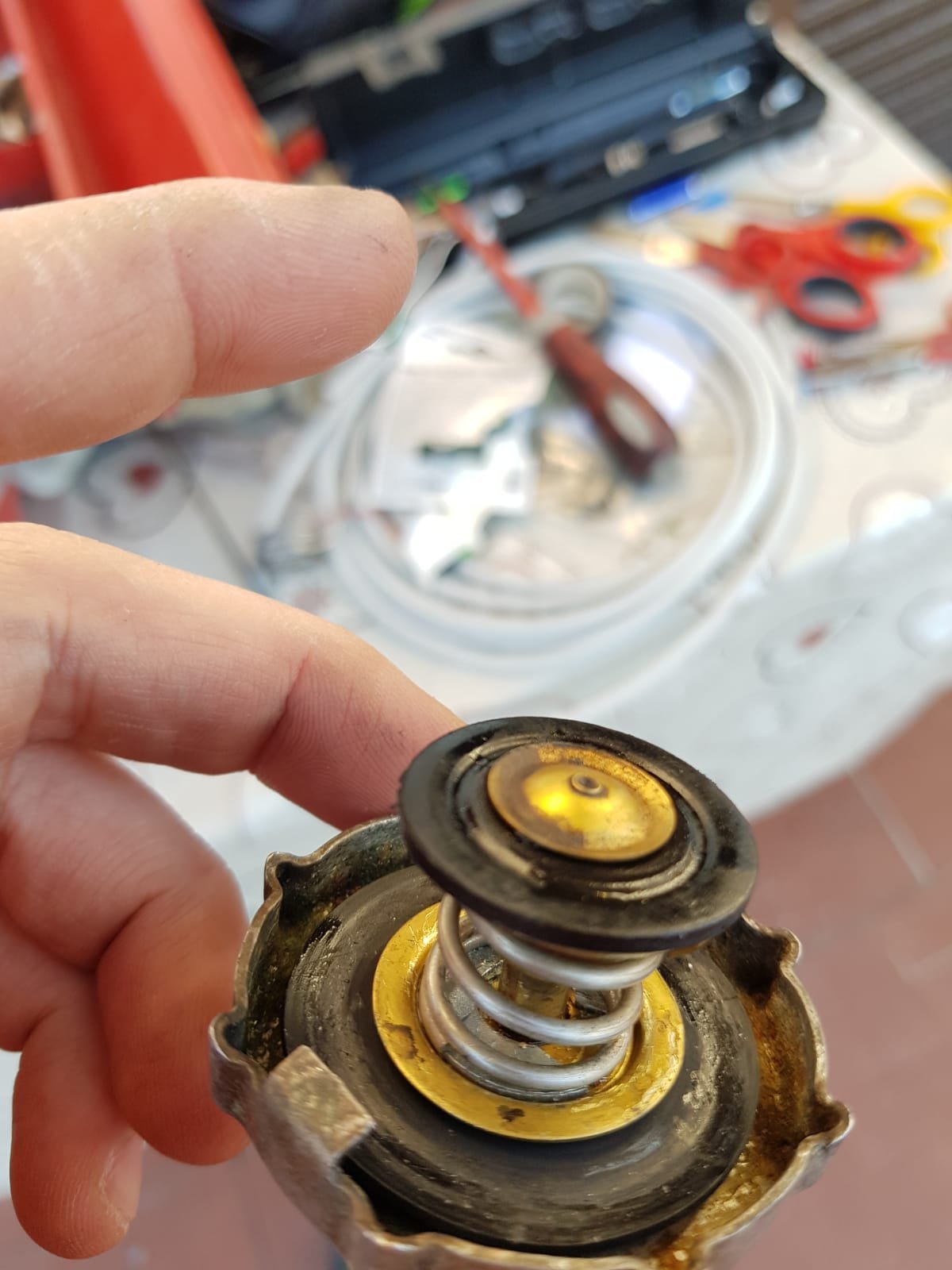

i've add a nuts under the spring of the cap. I've not tested the spring preload added, but this can be done with more nuts. In this weekend  will check liquid level to see if there is some improvement.

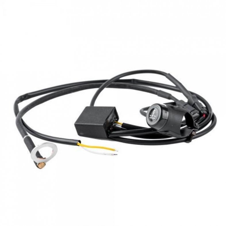

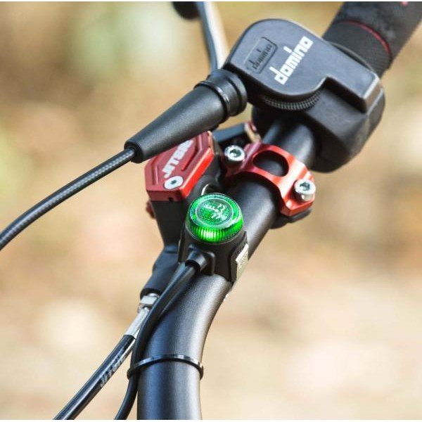

I've also installed a temperature sensore under the spark that light up an indicator on the handlebars from green to red when the head temperature goes over 90°. i've seent that under high load ramp ossa cylinder head go frequently over 90° but its enough wait 30 second in idle to have it back to normale temperature. So i think to tune it up and increase the allert treashold from 90°C to 100°C.

Spessore meglio dal lato molla ? bello il sensore temperatura
