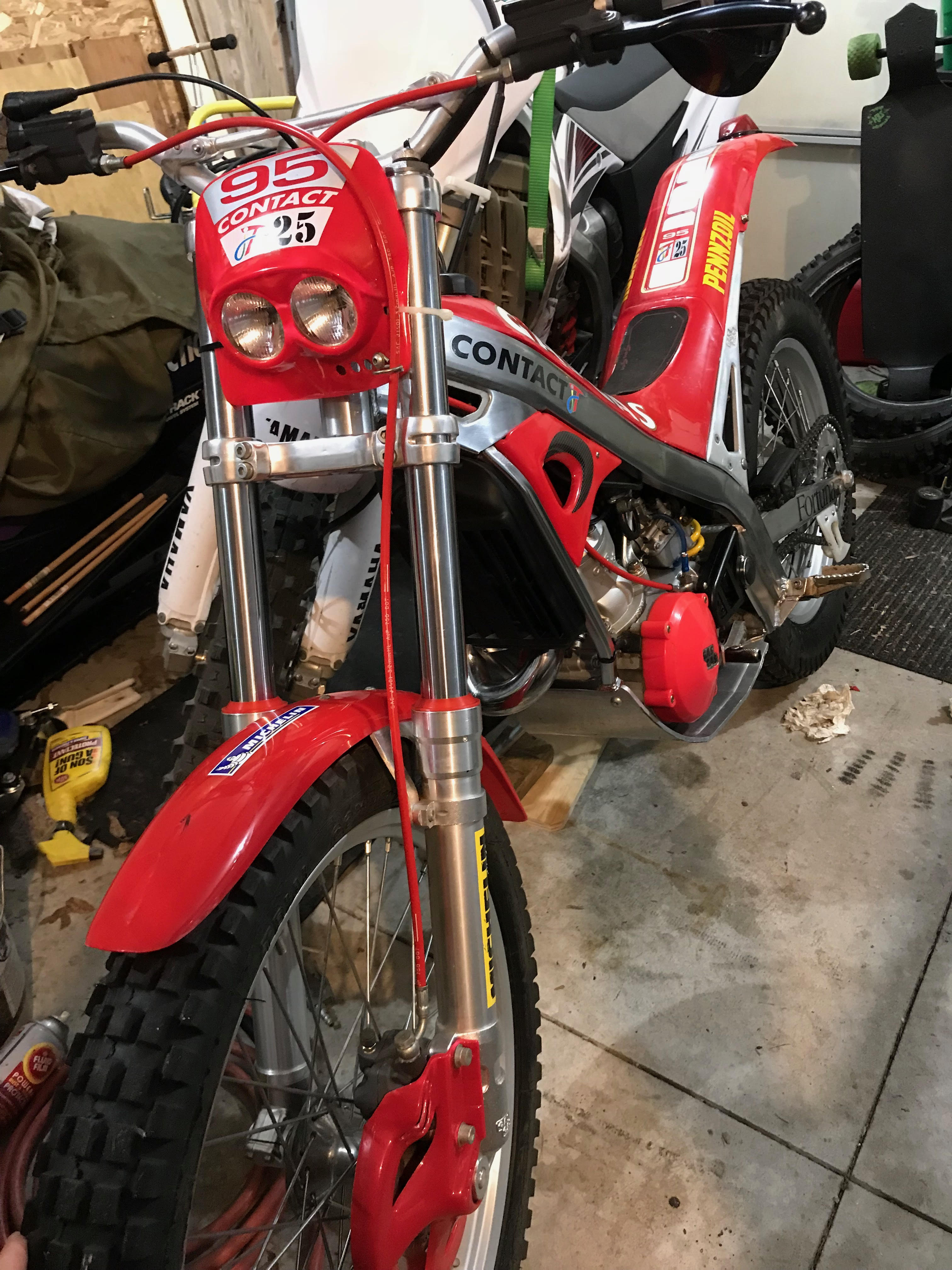

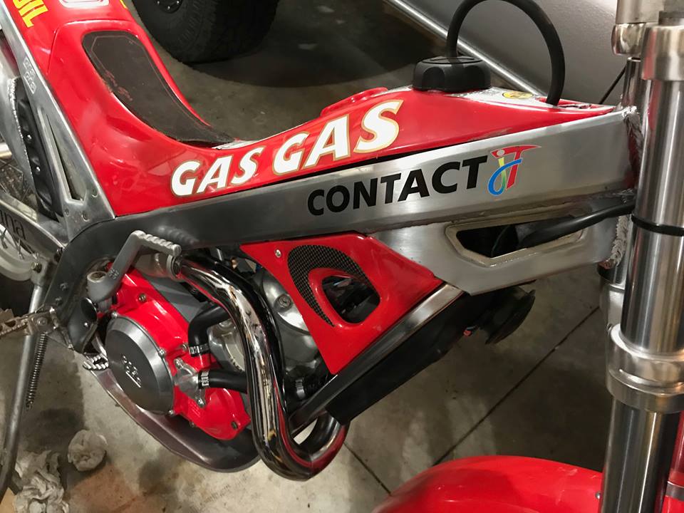

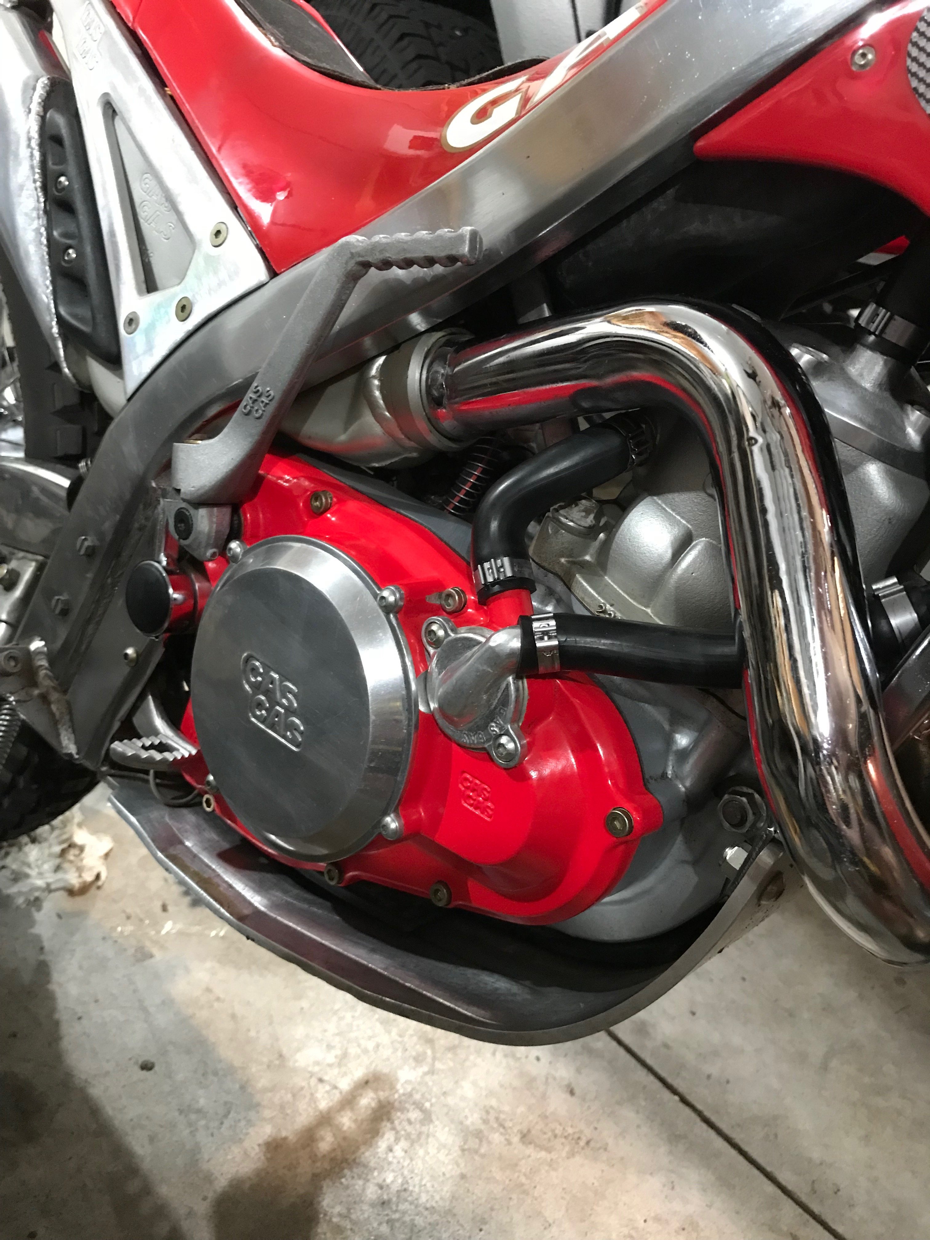

Hello! So I've wanted a trials bike for years and just now finally got one. I found a 1995 Gas Gas Contact 25 in near showroom condition. I couldn't believe it. Hardly a mark on it. The tires still have 90% tread left, but front is dry cracked with age so I'll be replacing that. I can't find a manual anywhere. I replaced the crank case oil, and drained the coolant by loosening the two colts on the right case where the hoses enter the motor, then refilled the radiator. I shouldn't have trapped air should I? I tilted bike side to side and then added more coolant. Bike starts first kick and I added 50:1 fresh gas. Can't find a spec on spark plug, but it runs great. Any suggestions on anything else I need to do?

 You might be able to work out some air by squeezing the rear hose rapidly with your fingers. BPR5ES plug should work fine.

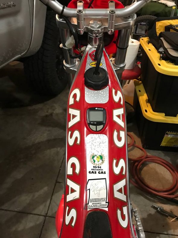

Oh ok. A digital copy would be excellent if available! As for the coolant, do you think I run risk of getting the bike too hot if there is any air left in the system? I still need to see if the fan works. I sure hope it does! Ha. Thank you for the info motovita!! Oh, also I just remembered that the grey wire leading to the rear hub sensor is disconnected and just sitting between motor and skid plate. Am I going to want to find a way to hook that back up? Not sure what its purpose is...?
As a complete guess ... it's a speed sensor wire. Is there a bolt in the brake rotor with a magnetic head?

 It is in awesome shape, but the early `95 model actually had water cooled center cases. Which had a corrosion problem. You might be able to check by VIN number. Trials parts USA would be your best friend. I would find this out soon as it would be a shame for this bike to be a lemon. They had a kit that blocked the passages to the lower cases. Plus side is you have the later model fork seal holder. The earlier model had green dust seals, This to was an issue that year. They were a great bike for the year.
The water heated crankcase caused the main bearings to spin in the case, this was the reason it was dropped v. quickly.

I just got to speak with Jim Snell. What a great guy! He reassured me that my bike does not have the crankcase water issue, and I should be good to go. :D

50:1 is too much oil but OK for break-in use. After 1 or 2 tanks, switch to 80:1.  Keep your eye on the transmission fluid. Those motors had common water pump seal failures that leaked coolant into the trans.  If the fluid gets milky, there is coolant leaking. The wire you mentioned is the signal wire for the small electronic readout located just behind the fuel fill cap.  I have never seen one that actually worked.

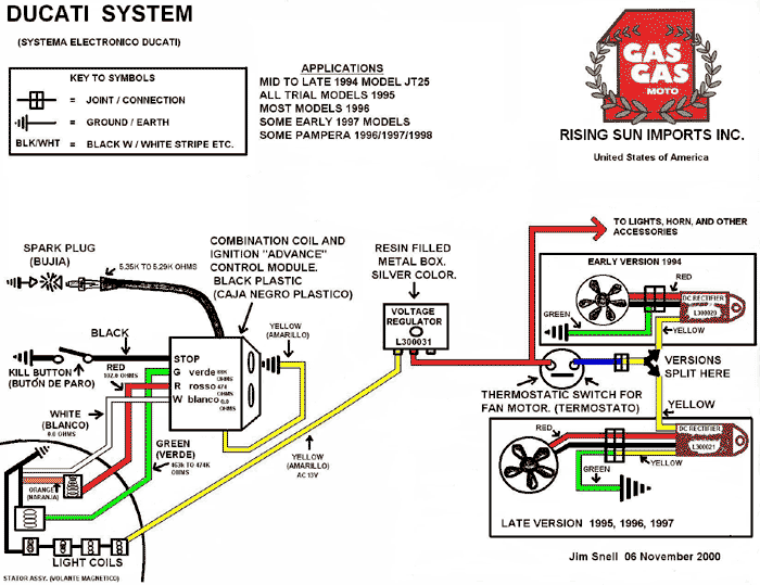

I have a parts manual and electrical diagram I will try to attach.  Parts manual is about 8 megs.

Thanks for the diagrams!
