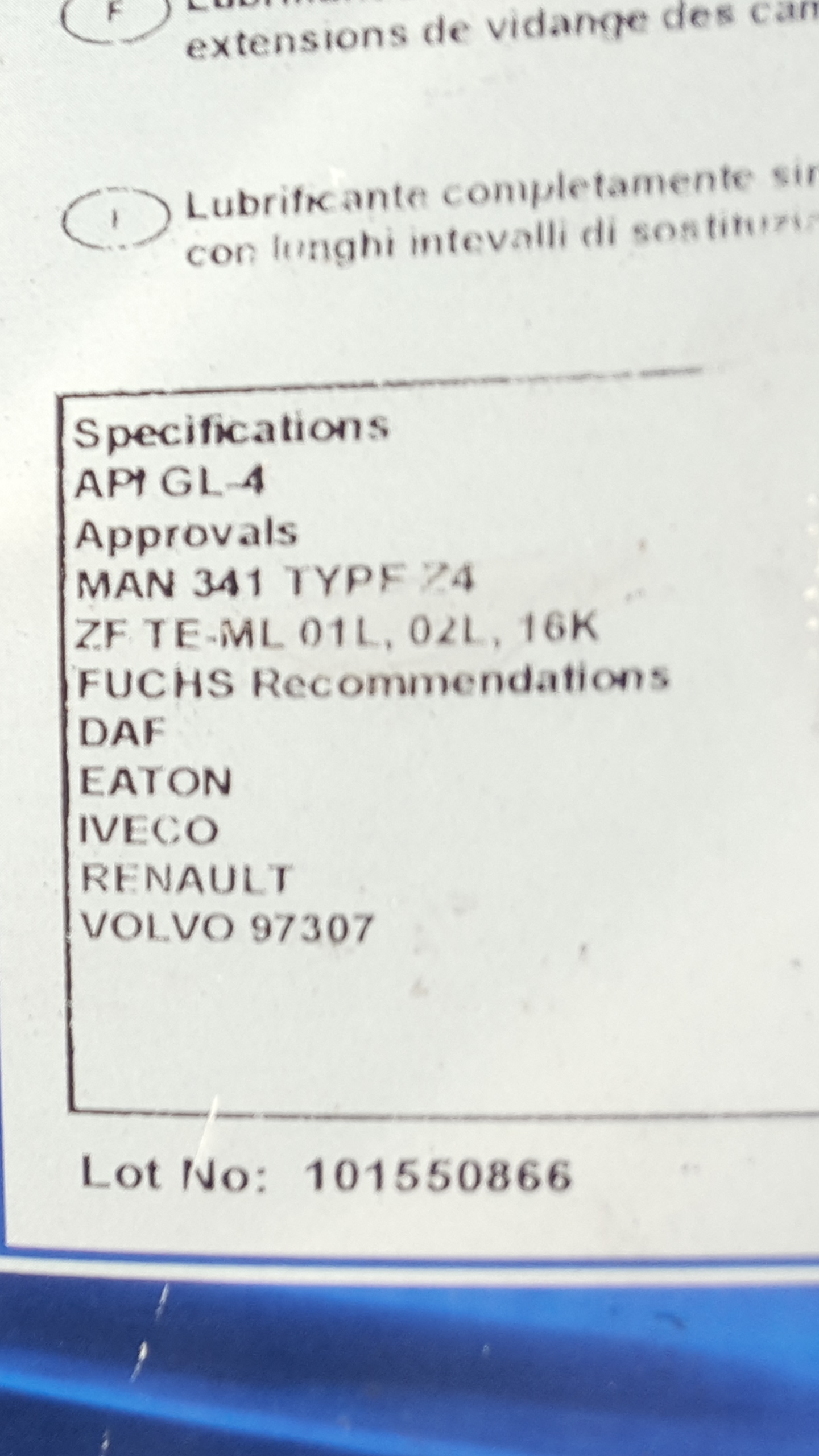

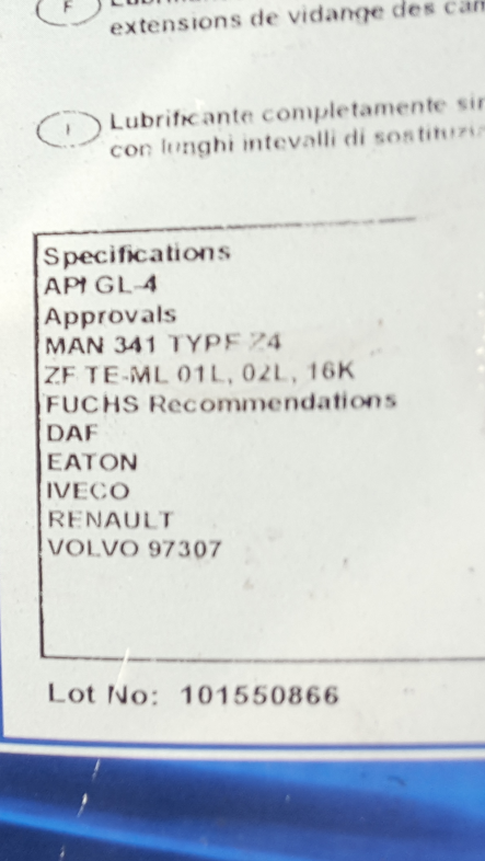

No Worries my friend, discussion is good ......but as you may have read....some members have used or know someone who has used 80/75w oil and some members are dead against using anything other than what is stated by the manufacture. Now i have 10 liters+ of the oil stated in the discussion which is GL4 (as stated by cascadeimp1) is the code rated for motorcycle wet clutches ) this means i have many years of free oil changes if the oil is ok to use (i say ok to use) it may not be the best or what is advised by the manufacture ( which would have been advised as it would have been seen as a general purpose oil which is readily available and most certainly not the best oil avalable )...so i thought i would give it a go ...and to be perfectly honest i have had no clutch issues or gear change issues at the moment.....now the question is do i continue to use it
You mean 75W/80, GL specifies it as transmission oil...gearbox if you will; there will usually be a US Army spec number after the GL4 or GL 5. The old SAE way of grading oils is not good enough for them! The oil is not intended for wet clutches unless it specifies this in the info and that’s where you may have problems sooner or later. Fully Synthetic oil in the wet clutch may render any gripping force between friction plates as redundant so you’ll have a slipping clutch....bound to some cases where this hasn’t happened. Potentially there may be some chemicals in the oil that will attack bearing surfaces such as bushings and any phosphor materials in the box. The amount of oil contained in your bikes gearbox is not that large, so getting the right stuff should break the bank, yes it would be nice to dump out the oil after each ride and know you have a large supply. So way up all the advice and make the decision based on what everyone has said. Now you’ll be riding and wondering if all is well between those engine cases??? Is there any detailed info on your 10 litre container about the oil? ??

i appreciate Beta is not on the list, from memory i think an oil change comes in at £8 ...now each change comes in about 20hr riding (im not sure
surely all types of engines have bearings and bushings , not sure about phosphor
as you can see advice does vary, thats what is interesting about the topic of oil

That’s heavy vehicle..truck... rated oil...lorries, dumper trucks etc. Probably axle types too!
