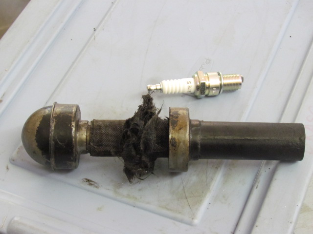

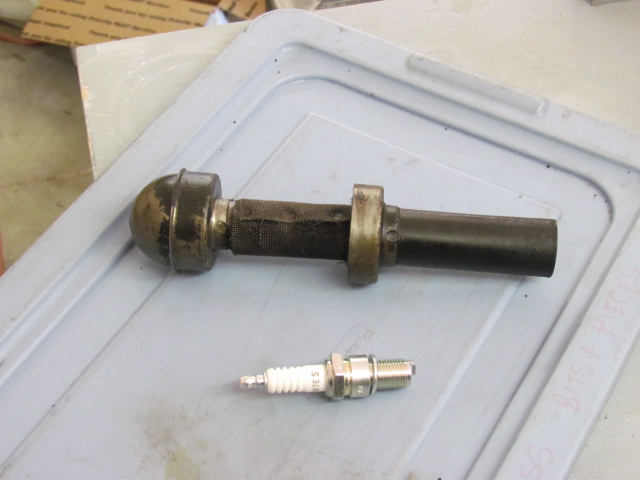

Thought I should start a new thread for this one. The pictures tell the tale better than I can.
All the parts on this one seem to be steel unless there is some aluminum tubing inside the Stainless Steel mesh between the large washer/baffles.?
This stainless mesh is spot welded onto the inner tube and the inner tube is full of about 1/4 inch holes.  You can't see the holes unless you hold it up to the sun light.
I won't burn this part out just to be safe.  It is not caked with carbon deposits anyway.  Just another dip in the degreaser shoud clean it up well enough.   The only problem (and it may not be much of a problem) is the fiberglass packing that was oil soaked.  It lived in the "cup" at the forward end of the assembly.  As you can see it is a mess.  I am leaning towards removing it all together because about the only thing it seems to do is collect oil residue?
One of the photos shows it pryied out with a screwdriver.  I could push it back down if you think it needs to be in there to keep everything from rattleing?

That's your exhaust packing, you're supposed to change it when it gets clogged, its not there to stop things rattling, its to keep your bike quiet.
So where do you get new packing from?  And is there ANY MORE packing anywhere else that has to be changed out?  Like in the main expansion chamber?
Any off road motorcycle shop, or online.

Thanks Tshock250  I am getting a lot of very useful info that I should have known by now, but my bikes before this one did not use any packing in the exhaust, so it was not in my memory banks to use.

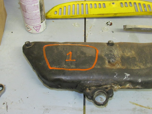

  Here are the pictures I just took that look like possible areas on the expansion chamber that look like they might be in an area where they could be patched back up again without too much trouble.
They  are labeled "1" and "2"   They are on opposite sides.  Any preferences?  I am getting a bit braver now.

On something like a Bultaco trials bike, cutting out a flap or hatch and butt welding it back works well because there is a lot of space between the wall of the chamber and the cylindrical mesh tube inside, and the tube is only held at the ends. On a TY chamber that technique does not work well because the internal perforated mesh is attached by welding to the outer wall very closely in many places. If you want to clean it mechanically (and I'm not suggesting that is a good idea) you need to cut the chamber in half lengthways, cut out the perforated mesh, fit the packing, weld back the mesh then weld up the chamber.
I recommend burning the chamber clean. Keep it at or below red heat. Some people use a wood fire. I use either a large LPG (Propane) torch or an oxygen-acetylene torch. It should take about 10-20 minutes to do.

   That's a much better picture than what I had to start with.  Since the wire mesh is pretty much against the outside wall,  and welded to the outside wall to boot, it sounds like more of a hassle than it is worth to open it up.  If there is anything remaining inside between the wire mesh and the outside walls it sounds like it would not interfere with normal operation once it was burnt and dried out.
Right now it is drying a bit from a soak in the de greaser.  I did not open it up yet, so thanks for that new information. Saved me a lot of hassle.  I will go hang it in a tree and let the de greaser drain as much as possible before I light up the weed burner  - this is from Harbor Freight and has a large flame coming out of it if you pull the trigger.
I would assume that if the pipe is hanging up you would want the fat end down.?  That way maybe something will fall out more easily?  Or does it make any difference?
I put the flame through the inside with the direction of flow the same as the exhaust gases. The pipe is lying flat on the ground. After it is cooked and cooled you can tap it and shake it to remove any loose stuff. If you want to try and get the glass to flow out while it is liquid it would be best to get it to flow towards the inlet end because it will get trapped inside at the outlet end.
Don't leave it sit around for long after the burn out or the insides will rust out pretty fast. Refitting it and going for a ride does a good job of coating it.
