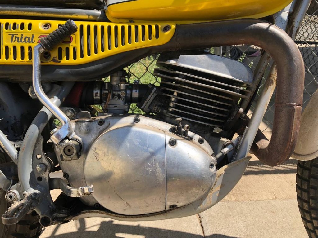

Guys,
    Does anyone know if this rear 5b89fa345e082_TYBrakebenddetail.thumb.jpg.bc7583c3475365a1fc03d68218362bb7.jpgbrake lever is off of another model (factory bend) or is it something anyone can do with a propane torch and a vice?  Notice how the pegs are in the rear position and the brake lever is still easily accessable?
1 hour ago, Tillerman6 said:
Guys,
That's a standard TY250A brake pedal. The pegs are standard TY250A in the standard position.
There was a trail-riding kit available from Yamaha that had a different footpeg location and a different brake pedal and a bigger seat
Feetupfun,
    OK that's exactly what I needed to know.  This pic is from a Craigslist bike for sale.  Apparently my bike has the kit you mentioned.  I was confused by the parts manual that I have.  It shows a straight brake lever similar to mine.  So what I will do is try and find a bent one like the picture above on Ebay.  I think it would be best to have both versions on hand.

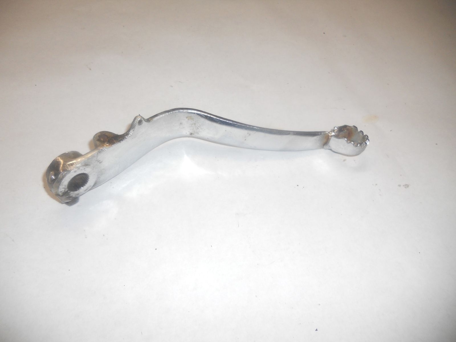

   That brake lever on your bike is about where I want mine to end up. I'm hoping that the ebay lever I bought will work, (see picture below)  It does not seem to be exactly bent like the one on the first Craigslist pictures, but maybe I can tweak it or modify it to work.  Anything would be better than what I've got now.  Apparently there were different versions (of the shorter stock Trials version)  or everyone tweaks them to taste. Main thing is to get the pad end out from under the side of the case where my big foot can find it.  That problem is what eventually led to me changing my riding style and using the engine for braking.  And that would be OK for a 2 foot hill, but where I ride the hills are very steep and long, so I really have to change and use the brakes a lot more.  I got lazy with the clutch and I think it was doing damage to the cylinder with all my "Jake Braking"  on longer downhill stretches.
Anyway, the Ebay seller said that this was from a 74.  See what you think.5b8c03e7a996c_74EbayBrakeLever.thumb.jpg.4bcaca63d9c4ca448abc4a9d58ac3d62.jpg

Looks good to me
