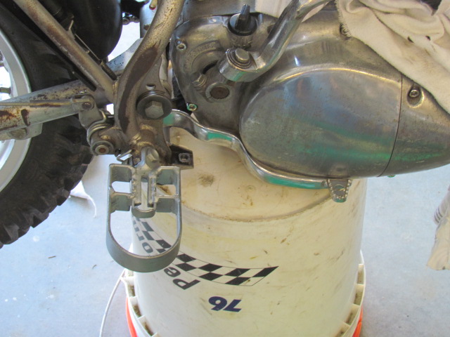

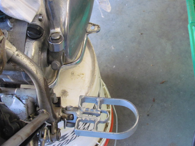

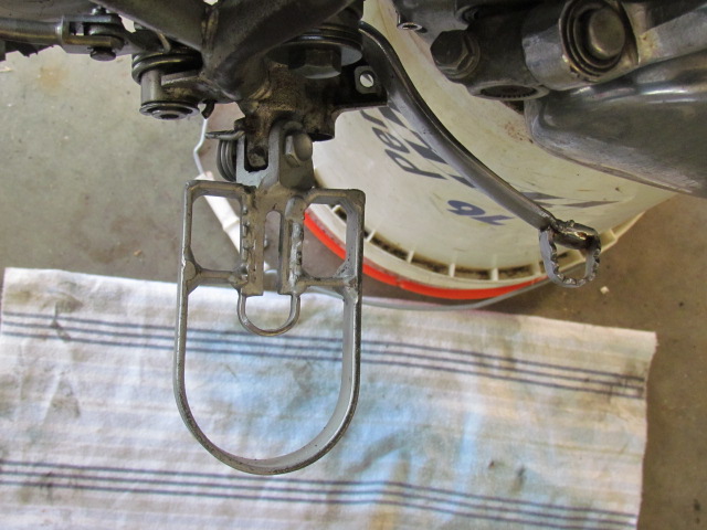

On 9/1/2018 at 9:52 AM, Tillerman6 said:
OK,
  Here are some more pictures of my own bike rear brake lever.  You can see that is is not set up right for trials, and does not really work for trails either.  Too low and too far forwards.
And tucked in too tight to the cases.  It hits the cases at one of the bends.  So this one is scrapped as soon as my Ebay purchase gets here.  looks like you have to remove the swing arm to get the brake lever off and on?
003.JPG.31f5f63fad6aad0175478d9ef4e9c6b1.JPG004.JPG.ff16d842bdccb7316f6d4738e91dda02.JPG
Below are some pics of the installation of the Trials version brake pedal which is installed on the bike now.  Please note that I did have to remove the rear wheel and swing arm to get enough access to remove the brake pedal.   don't know if you can see it, but the standard Trials pedal is a lot more accessible to the right foot now and I will probably leave this one on the bike for the forseable future.5b90b3e567127_Brakepedal003.JPG.fe249e5029df0e44c0a1ff12fe56ae21.JPG
