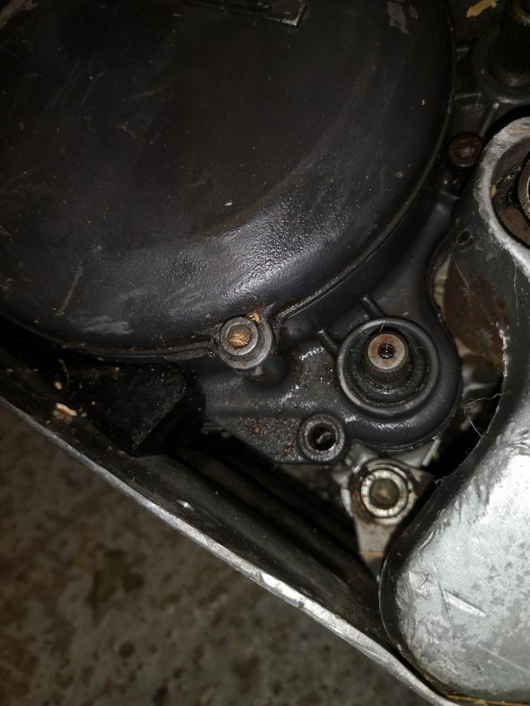

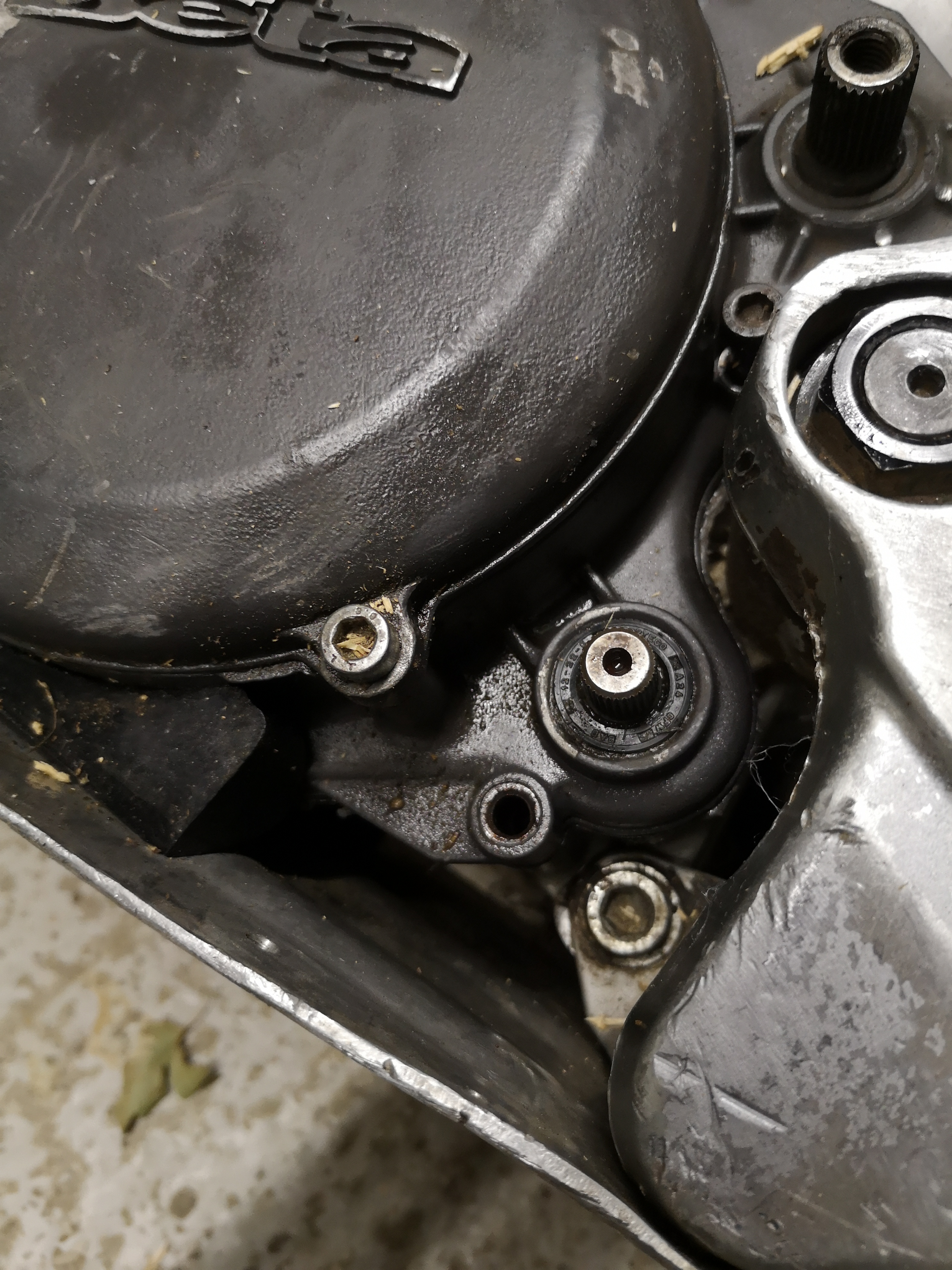

I have read alot about beta getting water in oil and why and how to fix...my oil is super cloudy and is actually starting to act like a glue rather than an oil! Really bad sticking clutch...anyway...I have taken off the small outer cover (pics attached) and I was expecting to see lots of corrosion or gunk.
The case looks almost new and the seal looks water tight?
I have tried to get the seal out, so I can check the wear on the shaft, but to no avail! Does anyone have any good tips and tricks to getting it out??
Also if it's not the seal or shaft can water be getting into oil from anywhere else?
Thanks in advance for the help!!

Drain the oil and then take the clutch cover off and acess the water pump drive gear and spindle from the inside of the case for removal and seal fitting etc......If you lay the bike on its side when you take the cover off  you will not get oil dribbling everywhere,

The bits you want are on the inside of the casing  opposite where the impeller is ...you do not need to take the clutch apart.
You have confused the clutch pressure plate with the clutch cover ..the outside casing that keeps the oil in the clutch area.
Edited by oni nou
You may also have a cylinder head gasket leak allowing oil into the coolant. This would show up by forcing coolant out of the radiator due to leaking engine compression pressurising the cooling system. The water pump shaft is poorly supported and will eventually wear the seal oval. The seals in your pictures look to be worn, but that could just be my opinion, it’s never the same when you can see the real thing in front of you. Do away with the pump and shaft, get the shaft hole welded up and fit an electric water pump which fits in the hose, outside of the engine, problem solved.?
There are two clutch covers. The outer one that you have removed is for working on just the clutch. The bigger cover surrounding that cover is the one you need to remove to work on the water pump drive shaft.
The symptom is water in the gearbox oil. A head gasket leak cannot cause this

However the bottom rear of the cover in the picture won't come free at all. Is it because of the rubber it is sitting on? Seems to be stopping it from moving? Or just needs more taps.
