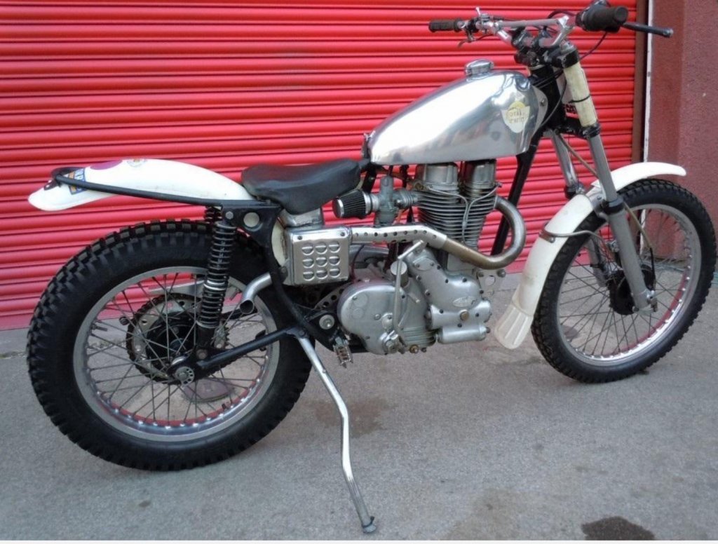

Im trying to locate and buy a Royal Enfield bullet 4 speed Albion gearbox as fitted to the works bikes.
I think the gearbox is the same as they fitted in the early 50’s trials and road bikes, recognisable by the separate (higher up) gear change lever.
The bike I have was probably made from a late 50’s road bullet and so is fitted with the later wide gearbox, and I find it unsuitable for trials.
If anyone can advise me as to where I might find a gearbox and what I should expect to pay I will be very appreciative.

A picture speaks a 1000 words, it's said  - any chance of seeing your bike and/or the present gearbox ?
Thanks for your replies. Looks like I’m in for a hard time finding the parts I need!
here a photo of my bike and a photo of the offending gearbox I’m after :rolleyes:CEC65CFC-8746-48AD-AFEF-7C75BF6AAB2E.thumb.jpeg.3226a68a6efc1ef8da758bade189cc27.jpeg

That particular gearbox was used on Bullet 1949-1954. Older gearboxes were different and later are of the wide type.
Works bikes perhaps had a different gearing inside?
You can use a small engine sprocket to lower the gearing but kick starting will be heavy.
If you use crankshaft axle p/n 32309 it is not very difficult to make your own single chain engine sprockets but you probably need a special clutch for the same chain size
I am not sure but I think gears inside are the same pre-55 and 55+. Must be checked.

How can I recognize a real trial
I have only bought this motor
That is the narrow engine and gearbox. That´s good. As far as I know any bullet frame will fit. Post 1955 frames are prefered by many but should be narrowed around the seat. I think you also can tuck in the engine/gearbox in a Crusader frame.
For ground clearence the oil filter extension at the timing cover can be cut away.
