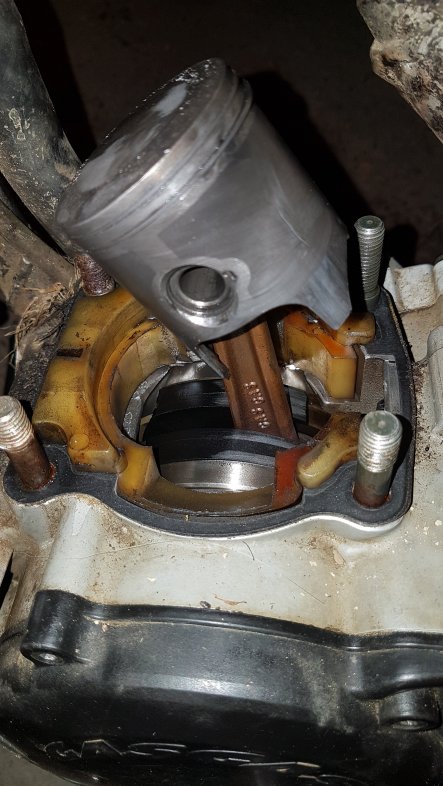

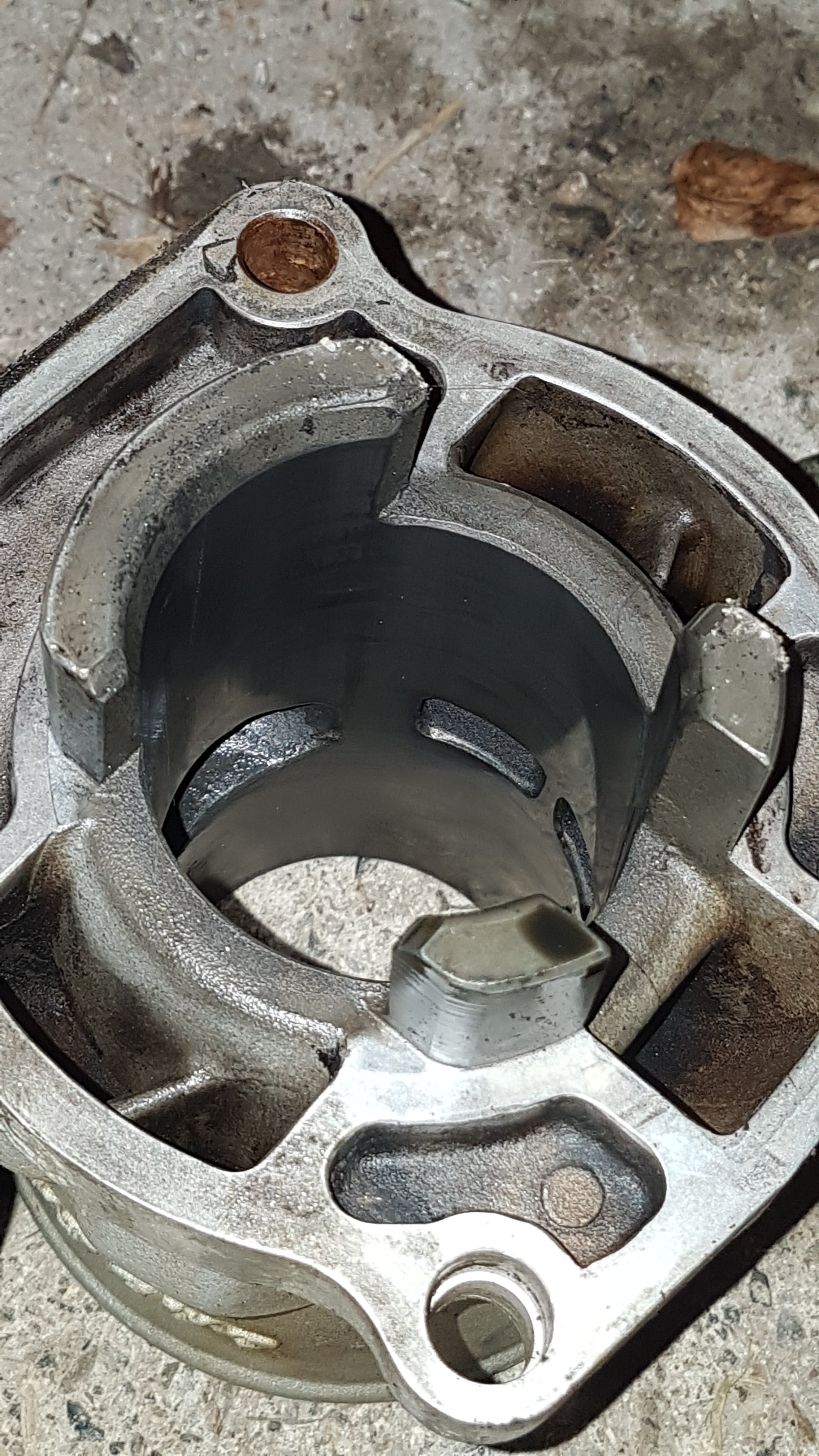

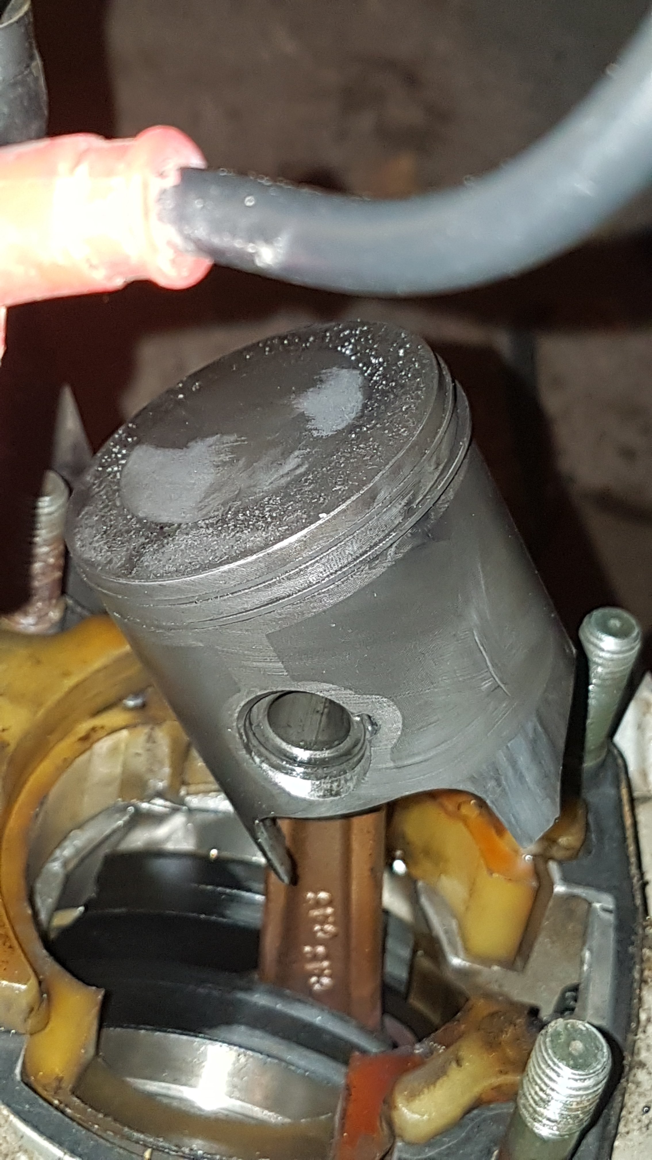

So,  i have managed to remove the head, no discernable markings inside the bore, and piston seems ok and rings are intact but everything seemed to have quite a coating of oil on it? What does that mean? Rings and piston have gone? (Sorry a bit new to this!) The con rod seems ok aswell! Phew! Well i think it's ok! It's not in pieces at least!
 You have the head or the cylinder off? Usually if it seized the rings would be stuck to the piston. A picture would be good or have someone look at it.
 Looks like several things happened. It got hot and took out the orings on the head. Is that just carbon on the piston or metal flakes. The rings look barely stuck and I would be surprised if there is any chrome left in the bore.
It feels like grease/carbon.
What's the next step? New piston and rings?
It is a Teflon [non stick] coated piston .....the fact it is still intact shows that it was a nearly new piston.
