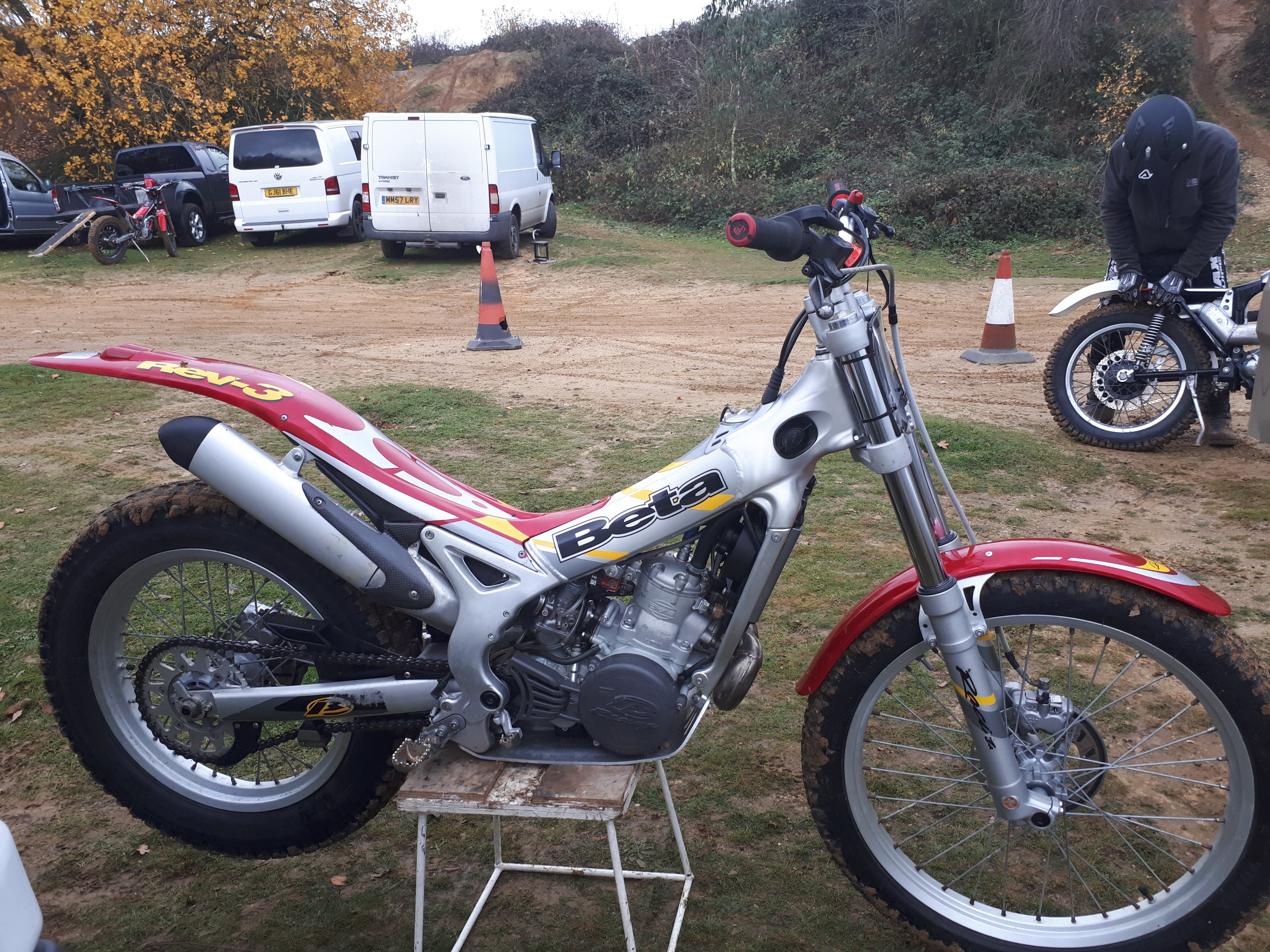

    Here is the new toy, It looks to be in very good nick for its age engine is smooth, no rattles, has all the gears and has the water pump  problem sorted. I cant believe my luck for a nice little

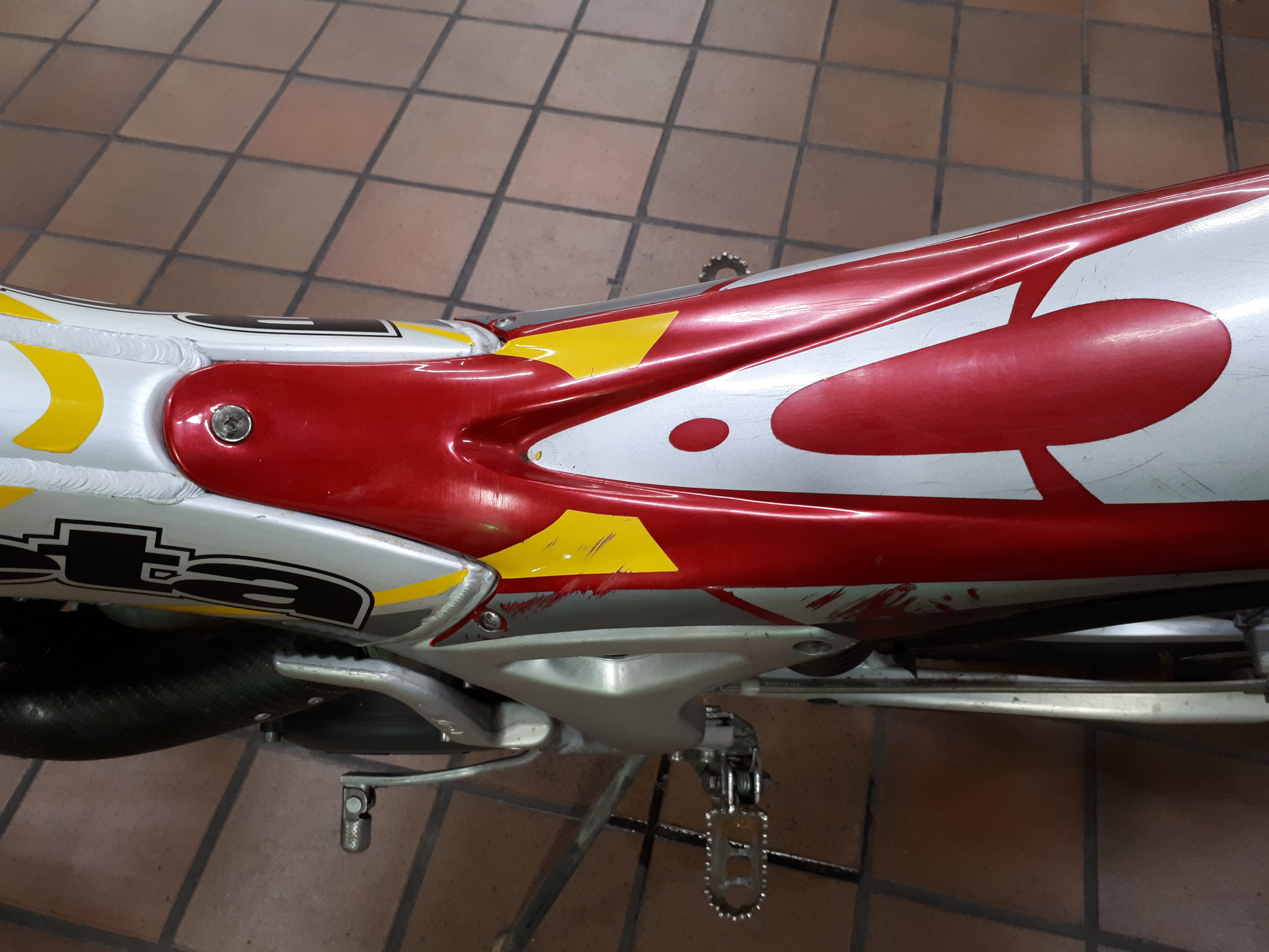

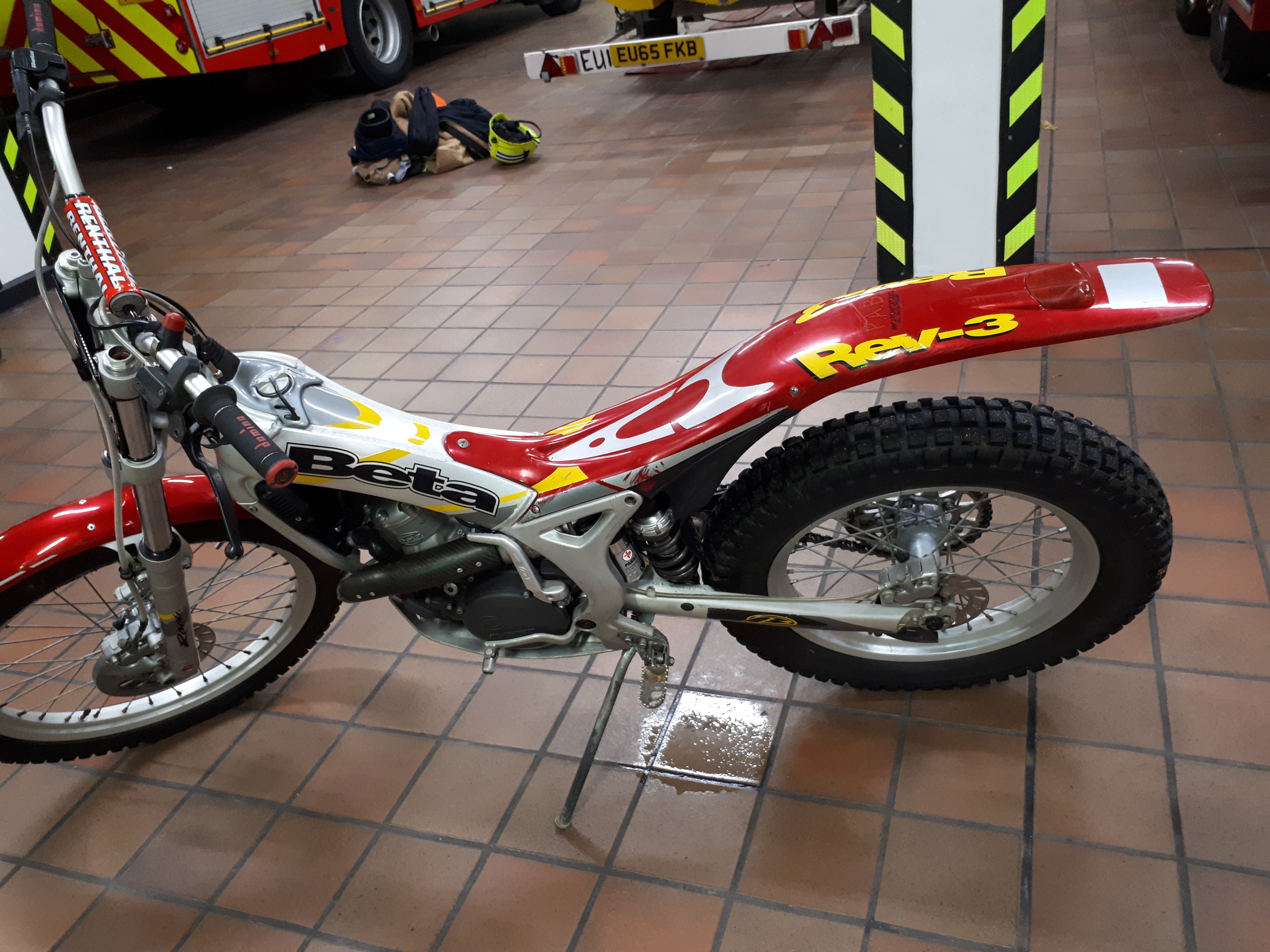

Hmm, that's odd, I don't see the side access cover.

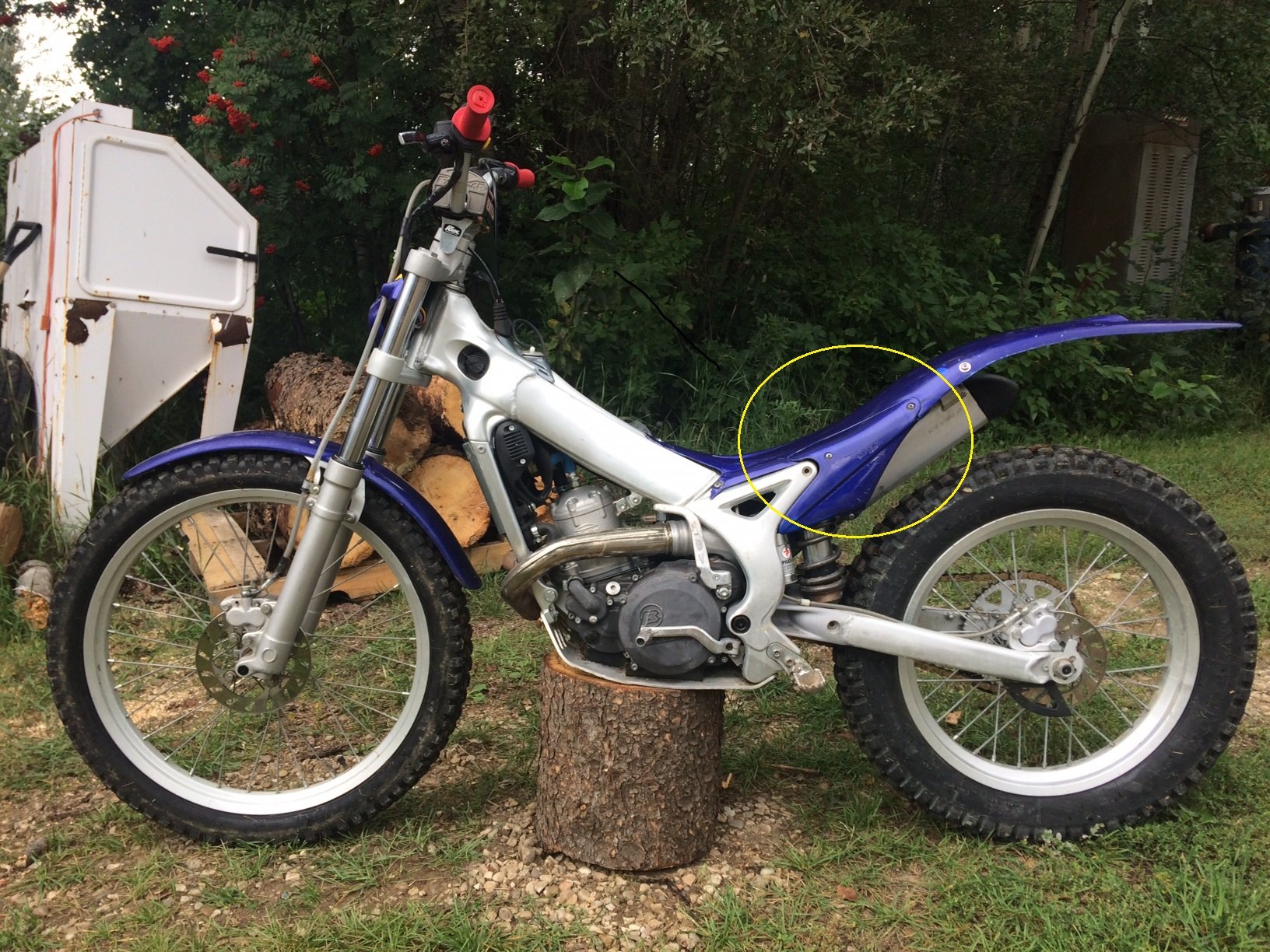

2002 should be side airbox, pretty sure it wasn't until 2003 they moved it to the top
Here's a pic of mine with the airbox cover in the yellow circle
Have you removed the mudguard/fender to see exactly where the airbox is?

Good eyes  Lineaway you are correct it's a 2002. Thanks Gary at Beta UK for the quick response, so two years older than I was led to believe but no sweat it's in good condition for it's age  and I think it's going to be plenty enough bike at this stage of my Trials career.
