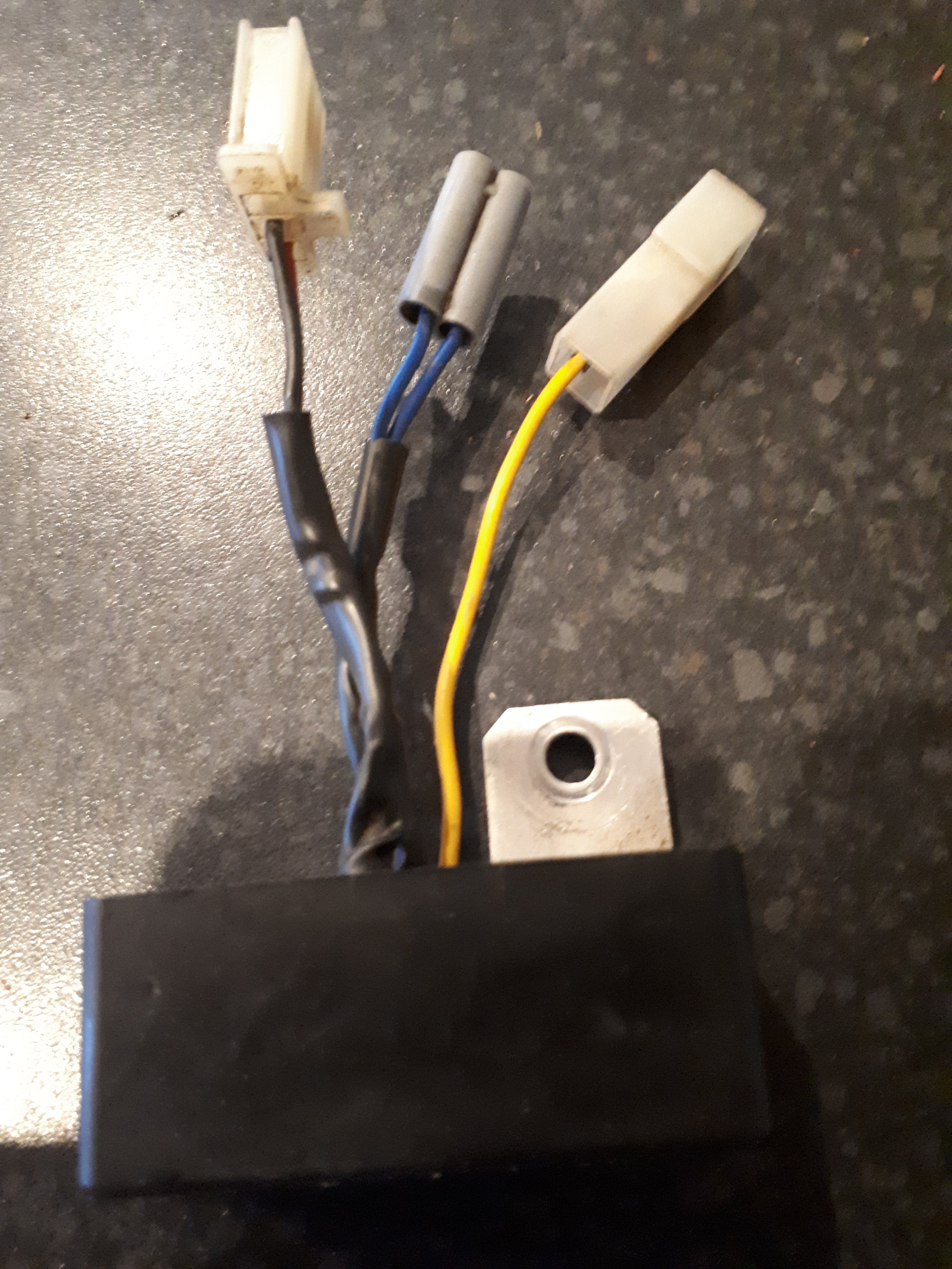

I think I have found another part of the puzzle. Lineaway I think you may have hit the nail first time. This little box is connected to the fan and the thermostat switch, the yellow wire was left dangling. The opposite end of the yellow is connected to kill switch ?
It's my guess that the yellow wire is the power suply for the fan ? if so why has the other end been connected to the kill switch I am hunting for
a wiring diagram now ?
Rich
Edited by Bigusdickus
I am pretty sure the black wire from the cdi connects to the kill switch, so the other tether wire should go to ground. But it has been a long time since I wired a rev 3.

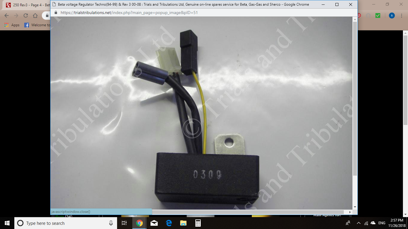

This part is the voltage regulator aparently as its wired up now there is no power going to it  just the thermoswitch and the fan.
the wiring diagrams I have found so far appear to be different from what I have colour differnce,and even the basic layout is wrong

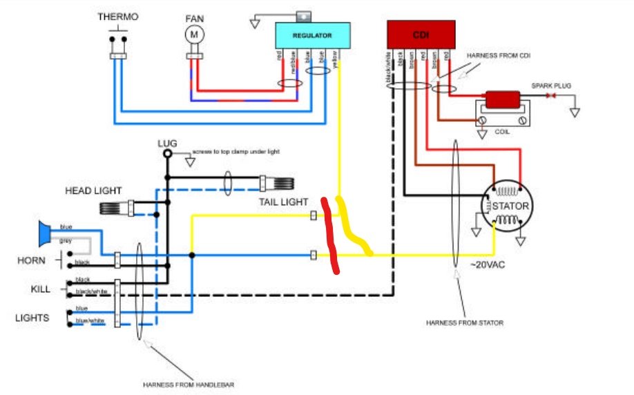

Hi Me2 Thanks for the diagram but this is different from my bike. Your diagram shows two power leads from the stator mine only has one. Posibly
they changed at some point, It's a bit of a puzzle I think I have nearly got it just waiting for the fan.
Rich.
Jackpot just found this. This is what I have on my bike, everthing on the left of the circuit past the red line is the lighting none of this is on my bike.
To the right is whats on my bike a single yellow from the lighting coil,this confirms that the two blues from tne thermostat must have some sort of switch
inside the voltage regulator. the later bikes seem to have the fan and thermostat are in the same loop ? well acording to the diagrams that is ?
As long as the lighting coil on mine is still going I should be in business.
Rich.

Just a quick update on the Beta, all smiles now the second hand fan fitted cuts in and out when it should,
the wiring is now done the same as the diagram above, plus an extra earth from the frame at the voltage regulator mount
to the coil. the kill switch ground is conected to the same point and not the genorator coil as before. ?
