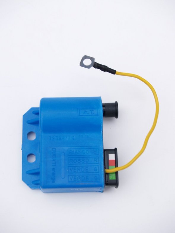

The original fitment round bodied Dansi HT coils are known to give trouble, I'm guessing that's the type you have. Most owners change them for the bonded plastic type pictured. They're widely available for about £45. I bought mine from Steve Goode Motorcycles and he supplied a wiring diagram for my 240.

Got a Ducati blue coil to replace the Dansi. Can you please specify or post the schematic for the Ducati’s leads:
2 greens
1 red
1white
