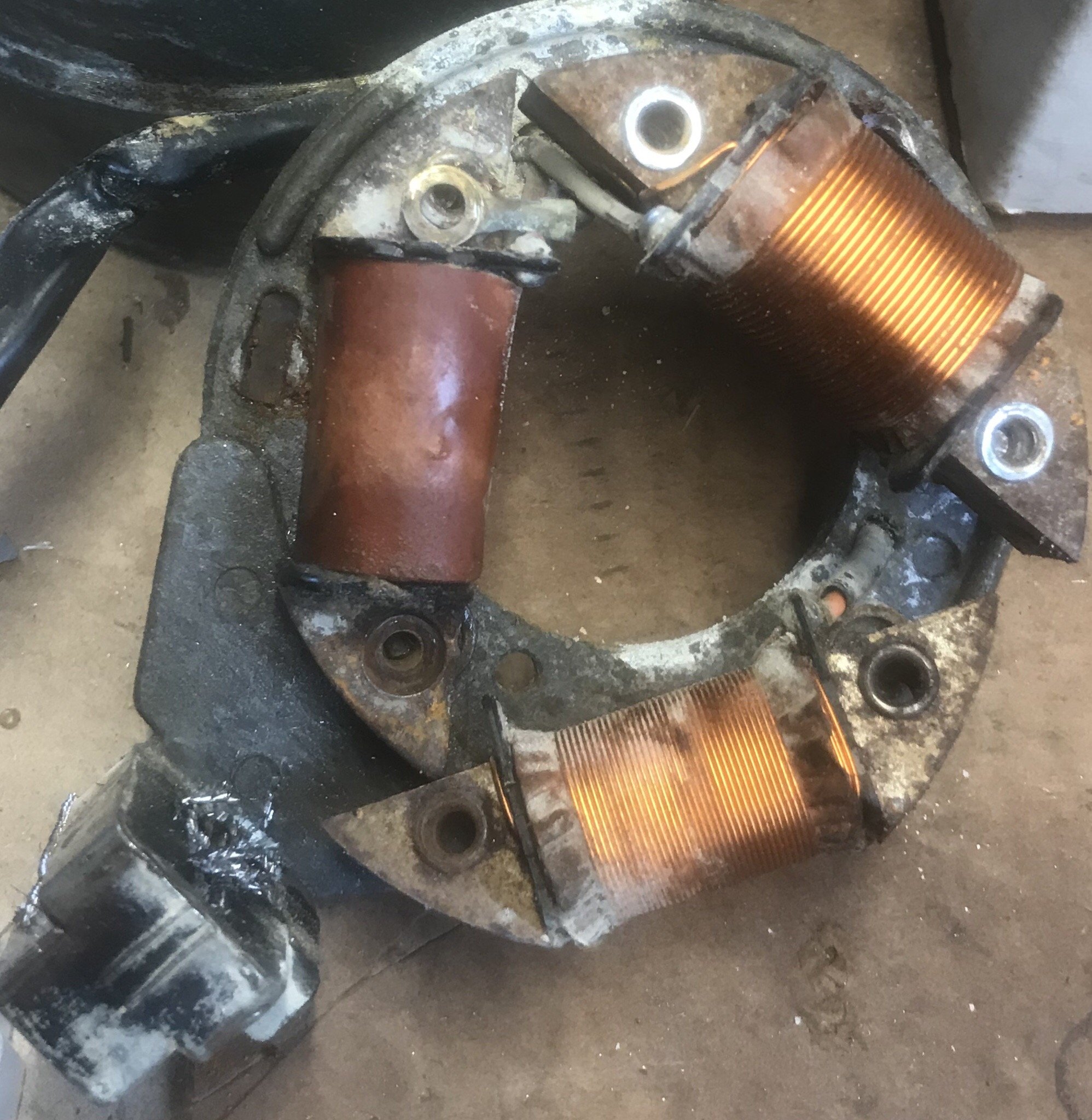

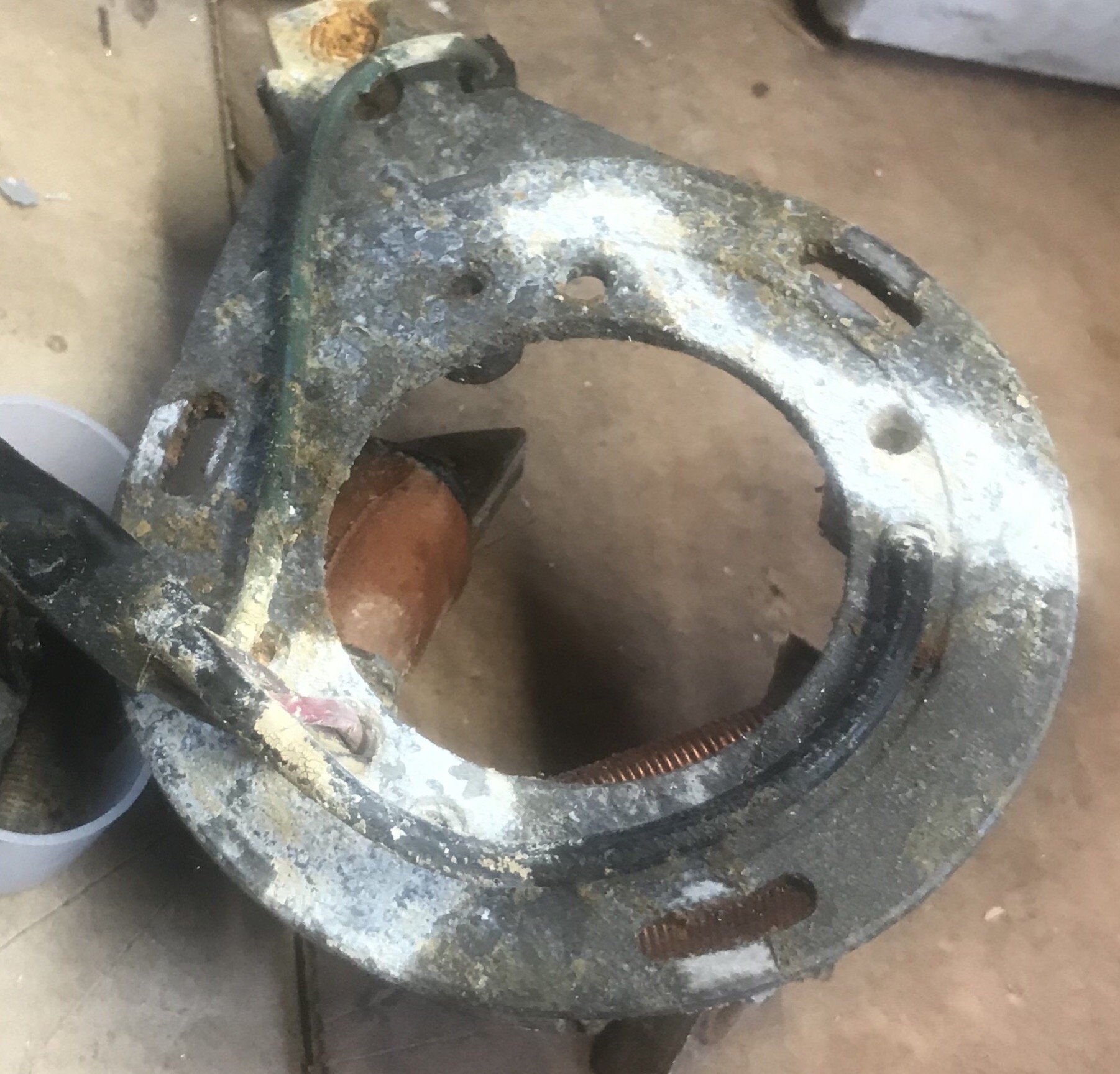

Flywheel is off. The stator area was coated with a powdery-like corrosion. The plate mounting screws all needed to be extracted with success. The coils’ M4 (very hard metal!) screws all need to be drilled out, proving to be rather difficult.
LT coil ohms reading is 693
Pick-up ohms is 40.
Basically the stator plate needs to be rebuilt and rewired.
Any ideas on removing these small screws (even a new left hand bit wouldn’t penetrate) and ohm readings?
thank you.
Looks like this lots been soaked and left to its own devices. It pays not to mess around skirting around the edges hoping someone will suggets the ‘ultimate fix’ without pulling the flywheel. I dont know why this is as pulling the flywheel off is relatively easy. There are companies that will supply all that you need, some of the original compmonents may be restorable but Id look at new items. This story could have been much shorter if you had just got on with the real job and pulled the flywheel......sorry that sounds a bit stern, but that was whats needed to sort the issue??

Yep got you. It’s a methodical learning experience for my son and I, who are new at this. And, if nothing else, our experience will serve as a guide for the next person that’s interested and learning to deal with vintage bikes of this sort.
