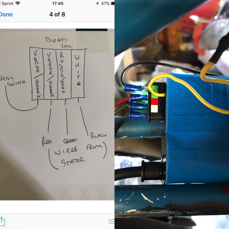

Fitted the blue Ducati Energia coil as per the attached diagram. Still no spark and now considering removal of flywheel to dig deeper.

Geetings, before removing the flywheel etc, I'd check the resistance values from the coils and pick up using a multi meter. I am sure the values are on a thread within Fantic 240 if you take time to look through the previous posts.

Did so. When checking Green to Ground no resistance.
Red to Ground no resistance.
So problem is in wires, connections or the stator coil if I understand the system. .
Cheers
Hi, to check the pick up coil, you should get Red= 0.0 ohms, and green=40-50 ohms

and those readings are taken ground to red, ground to green? Just to clarify.

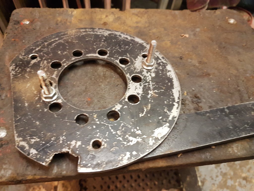

You'll need a 26mm x 1.5 flywheel puller for a 240. I use a homemade holder.
If the wires are original there's a good chance the insulation may have broken down causing problems. If the stator has been rewired you'll need to identify what wires are what as the colours may well be different to original.

Yep wires are very brittle. May be the culprit. Do you have a picture of the homemade holder?
thank you.
Here it is motosolex. The two bolts locate in the flywheel holes. The cut out is to clear the kickstart shaft but also doubles to hold everything from moving. Easy to make something similar from a piece of steel plate.

This is used in lieu of a typical puller? If so, I can’t visualize how it pulls.

It's to stop the flywheel turning while your removing flywheel nut etc.
If you have a compressor, an air gun will generally work without a holder.

Sorry motosolex should have been more clear. As mentioned it's just to hold while undoing and tightening the nut. I've personally never been happy using an impact wrench to tighten flywheel nuts but I know friends that have.
