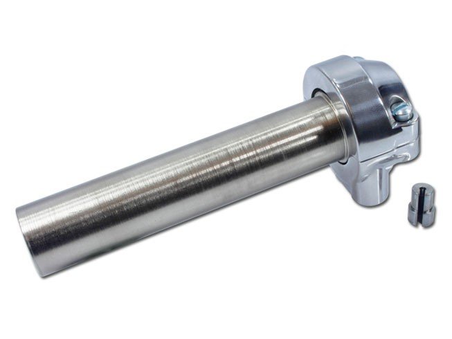

I seem to recall that the early models were fitted with a all metal, chrome finished Amal Type 16 throttle. Bear in mind the original would have been more than likely manufactured in Spain.
http://amalcarb.co.uk/controls-cables/twist-grips/type-16-single-cable-twist-grip-7-8-bars.html
I recall we couldn't sell them for love nor money as everyone wanted the right angled twist grip which had been available for a number of years at this stage. There was also a rubber shroud available to tidy it up and weatherproof it.

I feel fairly sure that the original twistgrip would have been Spanish  Amal - not  # 364 (a roadbike type) , nor type 16 - at least , not the type 16 listed by Burlen..............
 (quote)  "which has a high quality polished aluminium finish rather than the original chromed Mazak"   also hints at the latter material being the earlier.
Polished alumimium ? And with a price tag of £71.82 ?  Whaa ??  Sounds  much more like a fancy road bike repop than a trials bike offering to me.

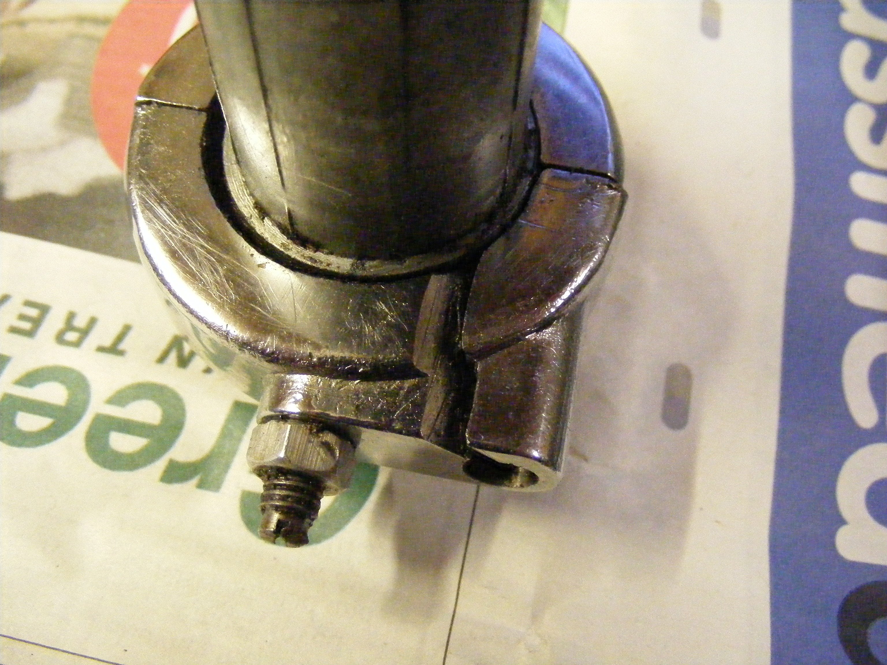

Anyway, while going through the shed in the summer (seems a lifetime ago now), looking for a Doherty twistgrip which I didn't find, I managed to turn up something like
ten others of various makes and types, including :-
Two Spanish Amal (Mazak)  t/grips, a plastic one (like yours ?) all removed from Bultacos , and a Doherty with stripped threads -the one that I was hoping to replace.
 A feature of Spanish Amal twistgrips is that the cable entry to the drum is slotted and direct (definitely NO loose ferrule to drop out and lose.
1746755130_Bultaco(Amal)twistgripdrumdetail.thumb.jpg.ad82eac23ac975f26e9499b354c66299.jpg
