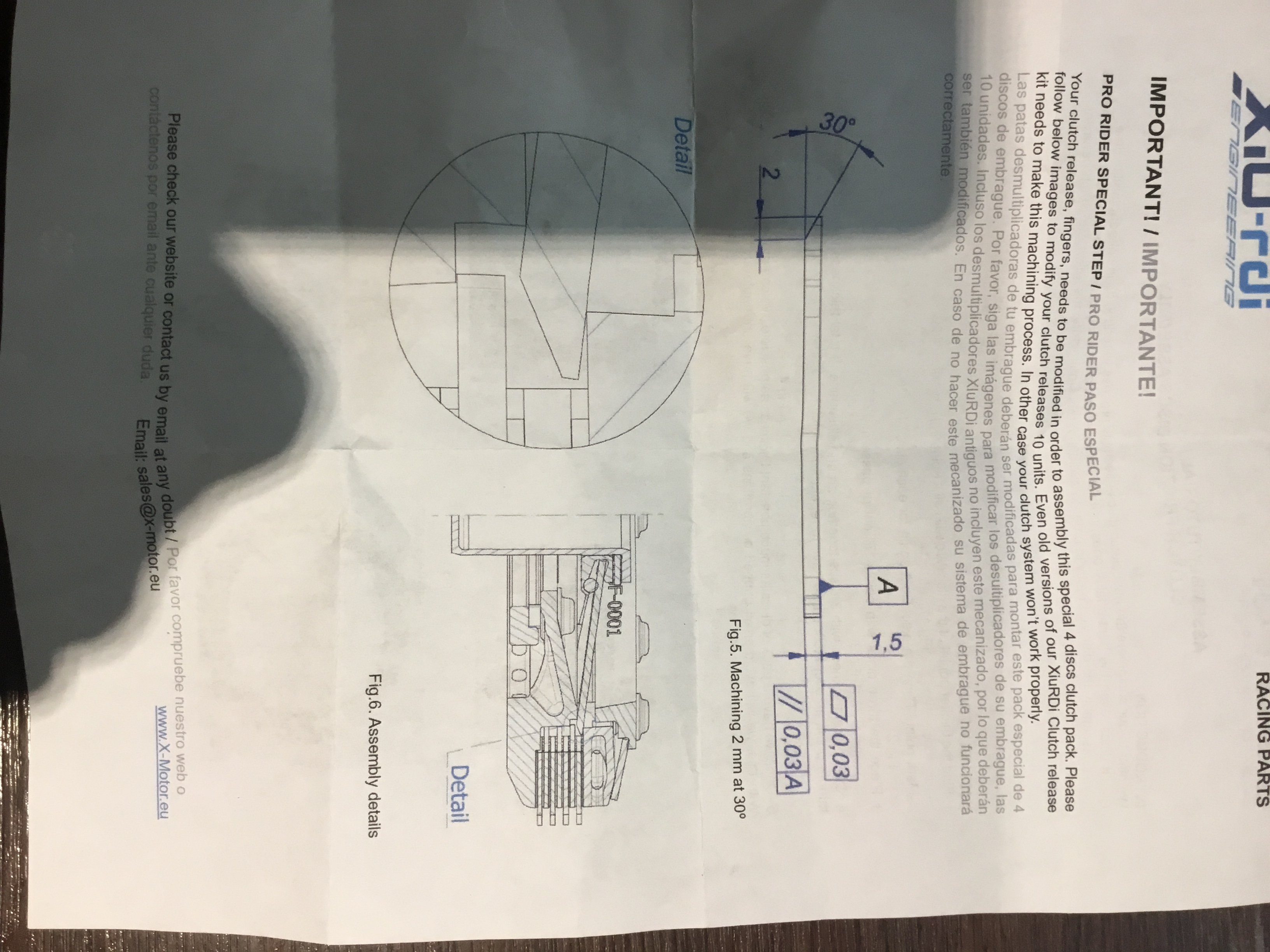

Just got xui full race Kevlar clutch kit with the 4 plates, it’s showing a 30 degree machining on the clutch pack operating fingers? Is this at the clutch pack end? Looks like it?
does this entail going to a machine shop to have done?
i thought it was at the other end of finger, bolt end, so I could just grind or file off?
anyone got this set up to advise?
No mention of this at all on website from shop or xui website, v f##d off......
Looks like I’m fubaared for this weekend..........this was supposed to be a drop in fix!! ??

It’s not the xui fingers I have but the std ones bro
Fit it as is,see if it works,you've nothing to lose
Don’t think will work, as pack will be to high!
if I’d known I could have had this already done....
I still don't understand the problem. The only difference between the Xiu fingers and the stock fingers is that they're cut out more for oil flow. The way they rest between the pack and the pressure plate is the same. There's no reason the Xiu fingers and stock wouldn't be interchangeable between packs.

That’s what I thought , remember though this is the four friction plate set, it gives instructions for this mod in the box!

That just seems stupid of Xiu to sell the pack without the correct fingers, they should have included them and charged a little more to make the kit a straight bolt on mod
The stuff is expensive enough so now need to cost in for some machining!
looked on their website and it’s says straight swap no farting about with it!
ive now got no bike this weekend....very nobbed off...
typical trials related, let the rider develop the product first....
this is from Xui website blerb
notice the “assembled on stock clutch, and rest of components”
