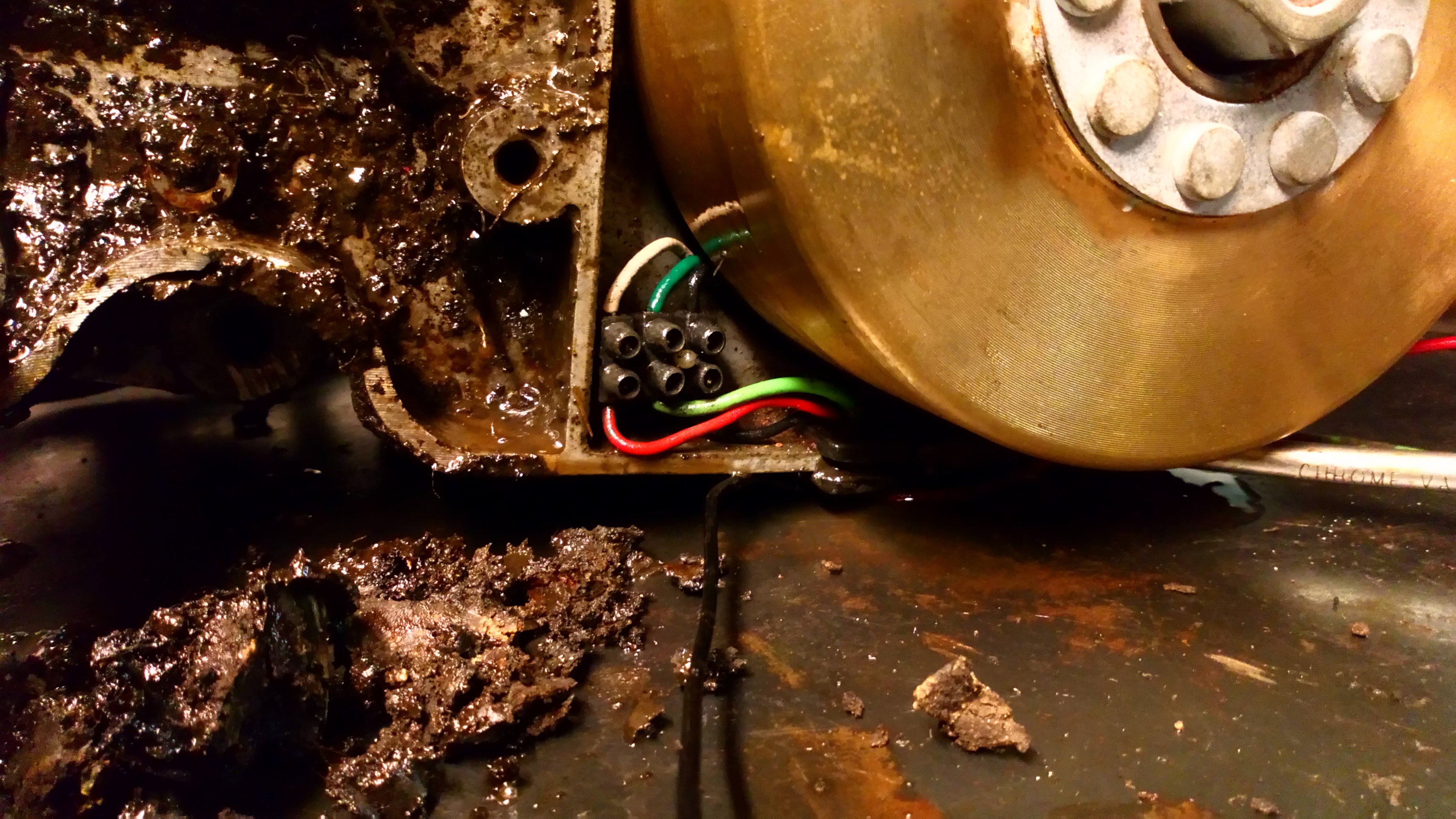

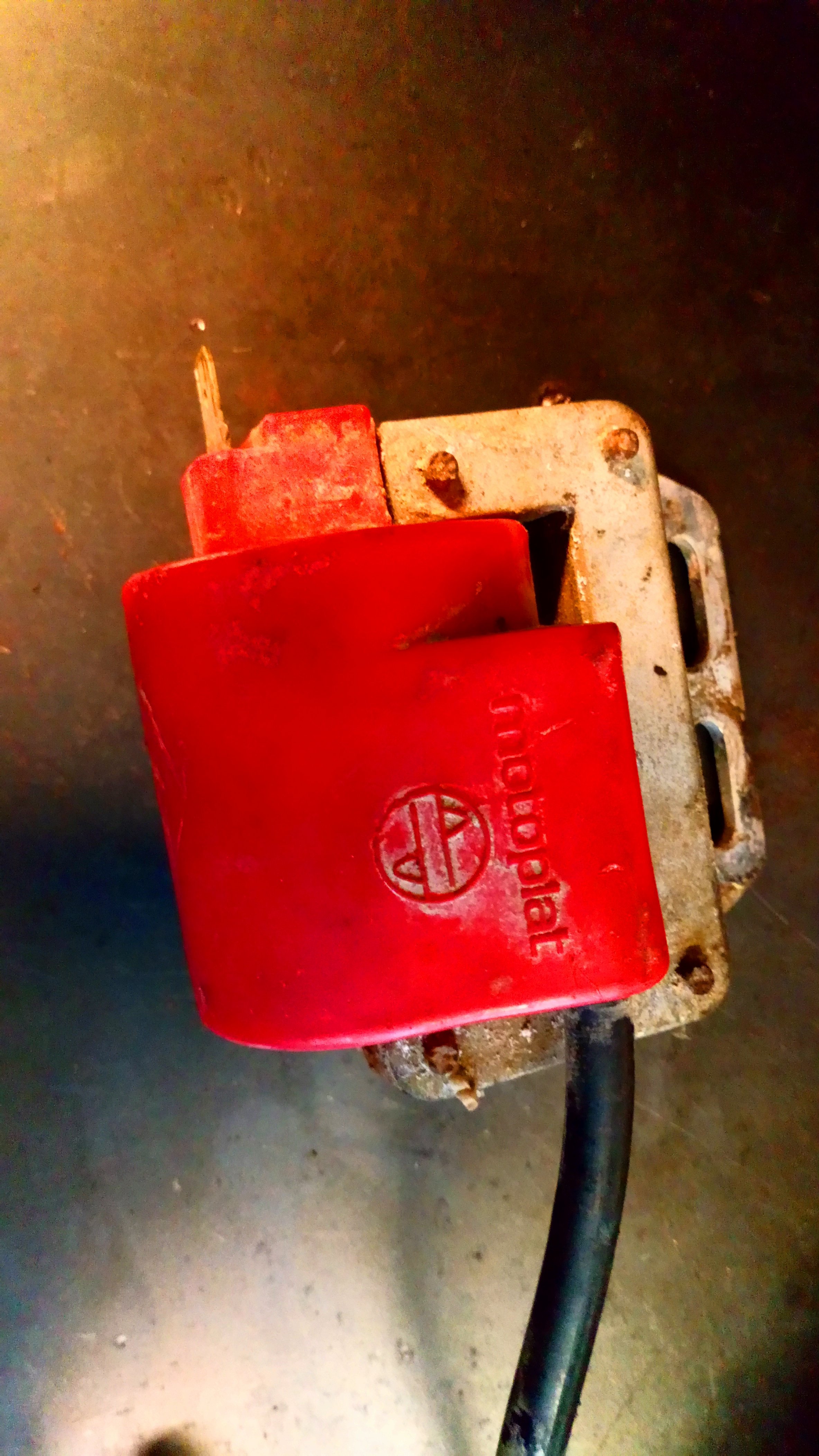

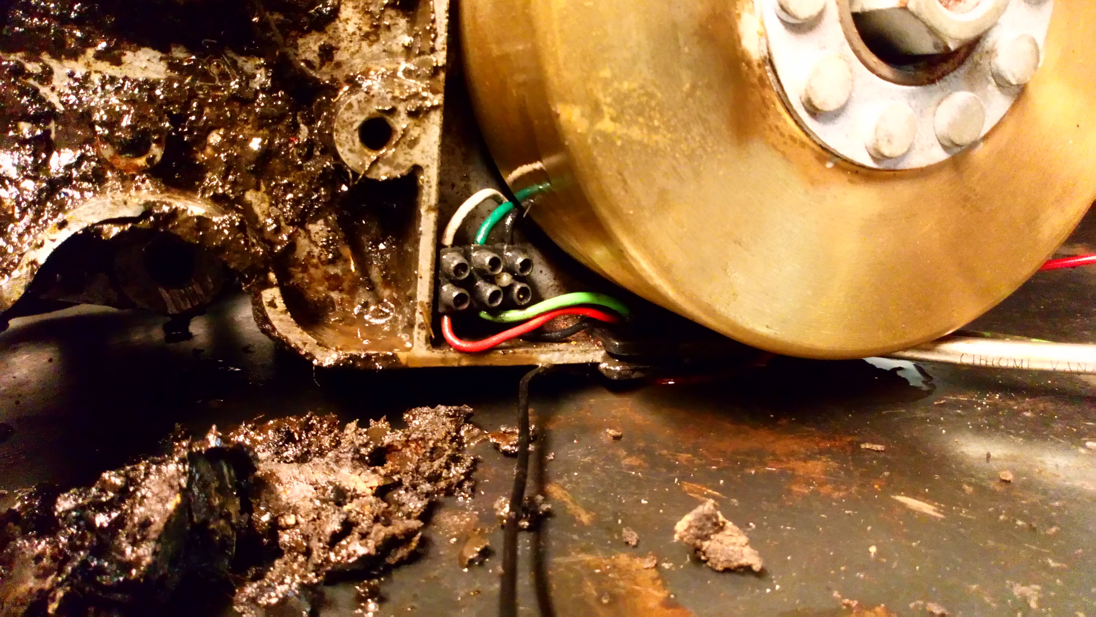

Hi, I have three wires coming from the stator plate and a coil with one connection.  Can anyone advise please which goes where?
Thanks, Daniel.
Hi, thanks for the reply.  Am I reading that as the red wire goes to the frame that this is a positive earth setup and the black wire goes to the single terminal on the coil?
Wires from the stator plate don't match up with the diagram but on my engine the white is converted to red - so positive and the black - well negative!

Hi Daniel,
It's always difficult if the original wiring has been modified, but I would connect the black to the coil terminal and making sure that the coils bracket is earthed, check for a spark at the plug.
Just checked mine.
White and black to earth at the coil
Red to the coil, with the condenser from the coil feed and earthed, at the coil. (Make sure condenser has been removed from its original position behind the flywheel)
Whether yours is wired the same, I've no idea, but that is the way mine is :)
